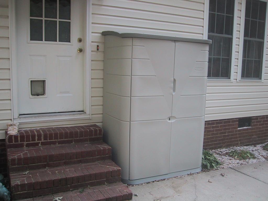

pvc is cheap.. run lines to the front of the garage on both sides as well as over the work bench and center of the ceiling. Ball vales for condensation. No more pulling hoses around tires, cars, parts.. grab a coil air line and go! If you can build a small room for the air compressor on the out side of the garage. My friend used a rubber made thing and also keeps his yard work crap in it, he opened the vents up and wired an exhaust fan that comes on when the compressor does to move air in there. Run one out back even, amazing how useful compressed air is.
here is the type of shed used.
