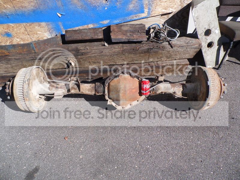

An M1009 CUCV (Blazer) would have had 6 lug half ton axles from the factory. With terrible 3.08:1 gearing.
The axles you have are from a 1976-1979 K20. They probably have 3.73 or 4.10 gearing.
Installing a set of lock out hubs is quite simple.

Thanks! And how can you tell what truck they came out of? What should i be looking to tell?
It's interesting the PO upgraded the axles, but no lift, and small tires. Must have been towing?
The story i got from them was that it was gping to get turned into the toy but his work van needed a transmission. So i helped him get his work van fixed by relieving him of his toy . Lol!
Well you win. Blazer with about as beefcake a rear axle as normal people get!

I only paid $150, but the 14 bolt is the easy one to get. All the 2 wheel drives had them too. The tough one is the front axle.
