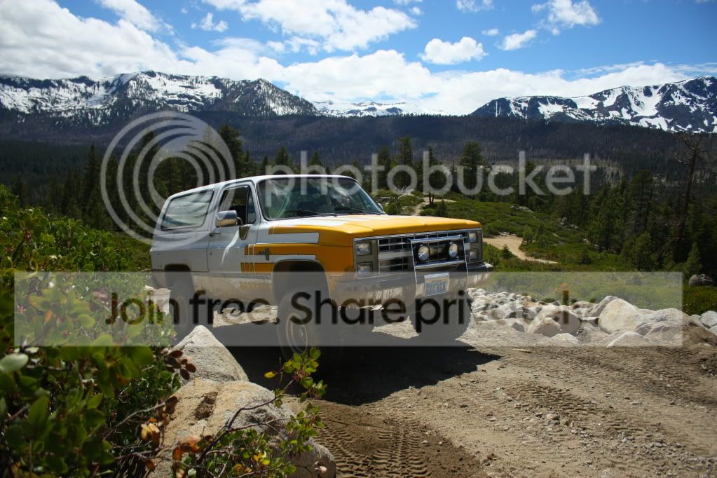

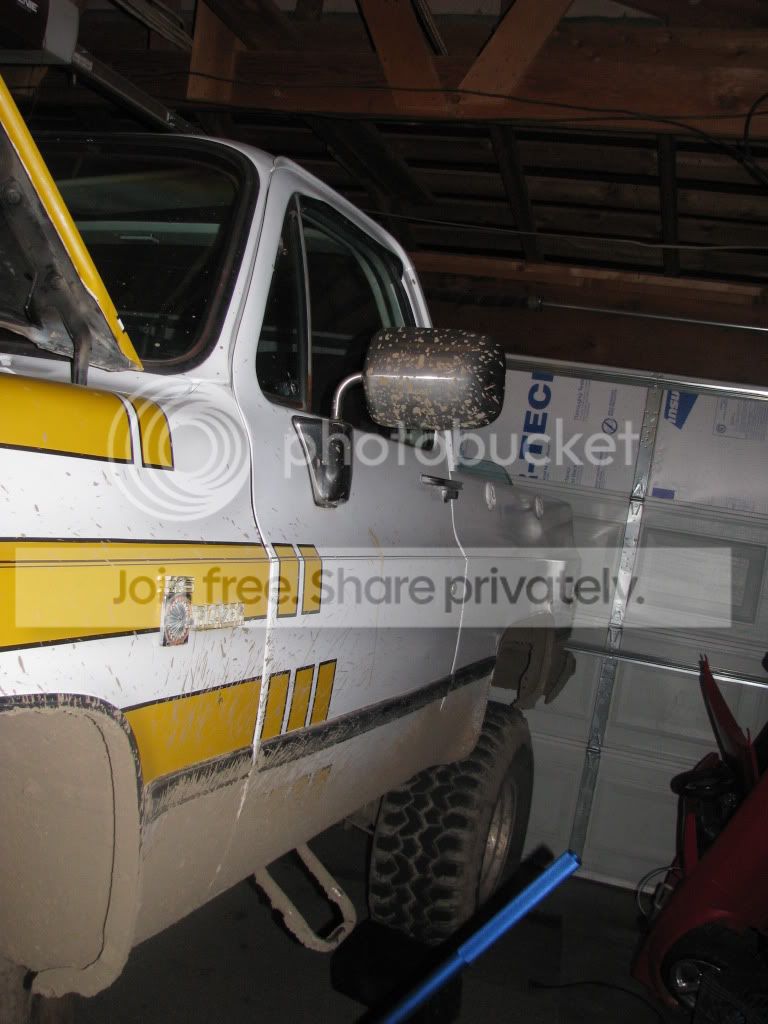

This is some of the pics i Have
hope it helps!
Hey take a pic of the transfer case from behind (where the rear driveshaft attaches)
Also a pic of the transmission pan from underneath... We will be able to tell you what you got behind your 350 then. :D
OH and welcome to the K5 club! Truck looks really nice!
PS - a paid membership here will pay for itself MANY times over on this forum ;)
