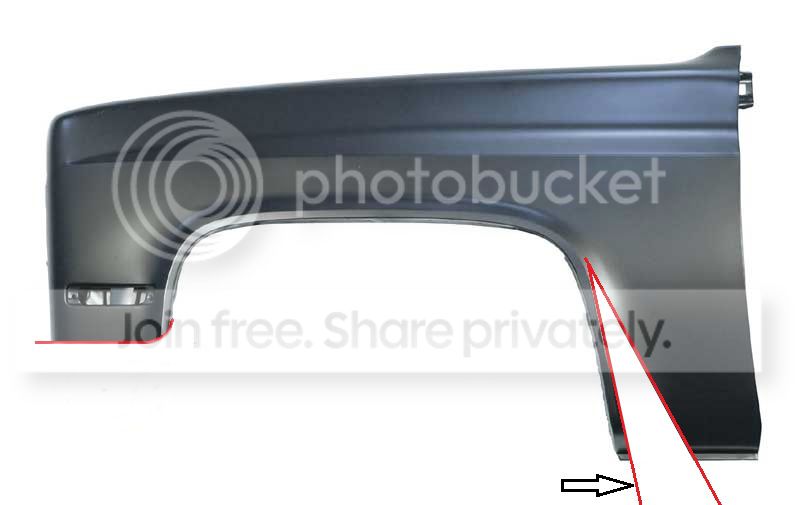

Anyways, I would appreciate it if I could get this measurement from those of you that have trimmed out your fenders. I'm sure everyone's measurements will vary, I plan on using the average number to trim mine out :D
My blazer will end up with a total of 5" of lift with the front axle moved forward 1 1/2 inches, any chance I would rub at full stuff?

Thanks for the replies. I like the way that fender looks on that 70s blazer, pretty much all I need is the measurement indicated in the pic I posted. The more measurements from other rigs, the better.
I plan on sectioning out around 4" (or whatever that measurement is) and pulling the factory stamped flare back and re welding it to keep a clean and stock(ish) look without getting crazy with metal forming and body hammers.
All I need is a starting point to draw my cut line :D

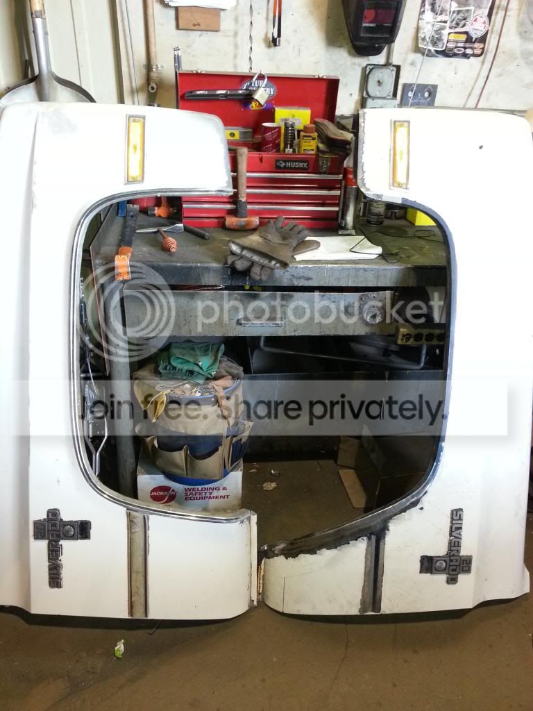

The cool part is that I already have another set of front fenders that I can experiment with, if this turns out to be a success, I will apply a small touch of bondo to the new weld seam and paint them. Then swap them for the current ones I have on my truck.
Something like this.....
Granted, I will need to stretch the lower portion of the factory lip to line up with the pinch seam on the bottom of the fender, but it gives a rough idea with what I intend to do.
As for the inner fender I'm not too concerned about keeping it, I think I can get away with making a couple of cuts and pushing the back of the inner fender towards the firewall and securing it with a screw to a tab that I will weld on the inside of the outer fender.....if that makes sense, lol

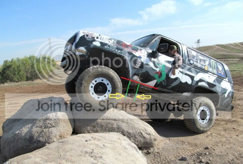

I'll try to grab some measurements tomorrow. I never hit the fenders, but I narrowed the front.
The measurement you are requesting for my K5 is 10". I have 37" KM2s and can stuff them without any rubbing. The axle is moved forward 1".
Thanks for the measurement, I plan on trimming out a little bit more just encase I decide to move to 40s someday or go with a longer travel leaf spring setup.

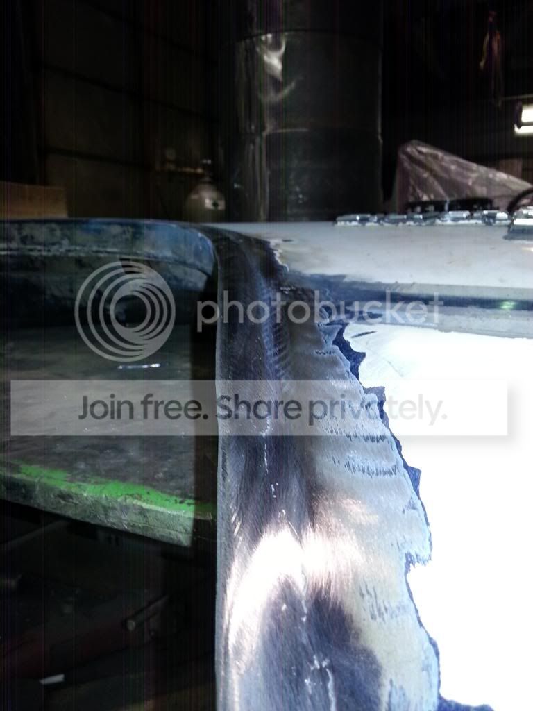

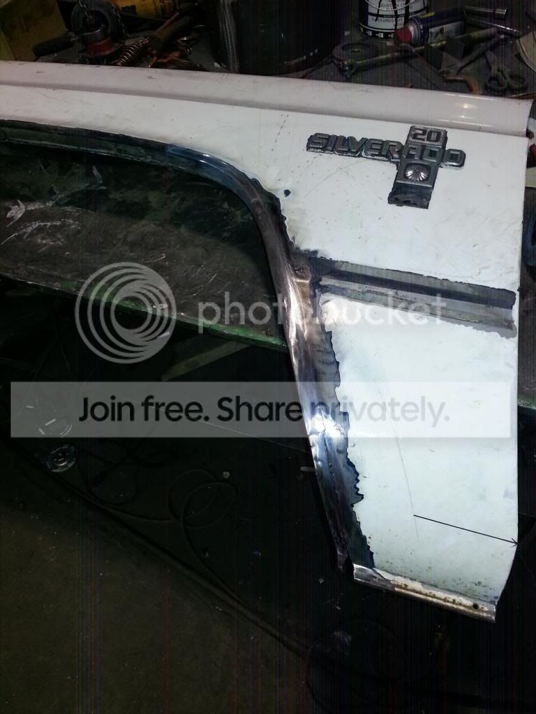

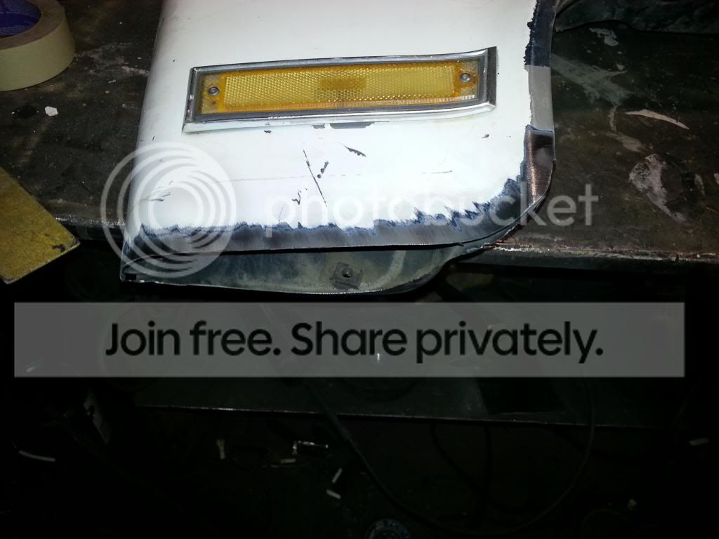

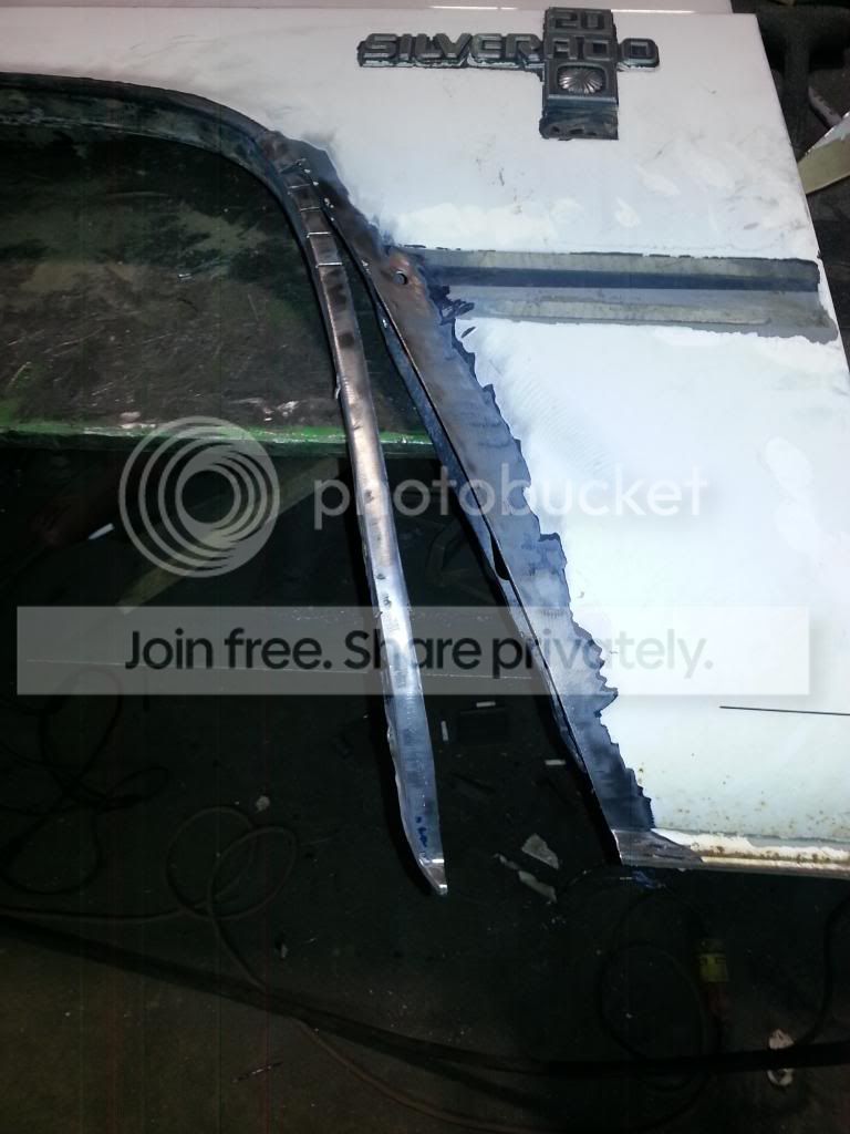

Figured I would post an update on my progress....
It's still a little rough around the edges and I need to weld in some patch panels to tie in the fender structure with the outside sheet metal, over all I'm surprised with how well this worked out!
