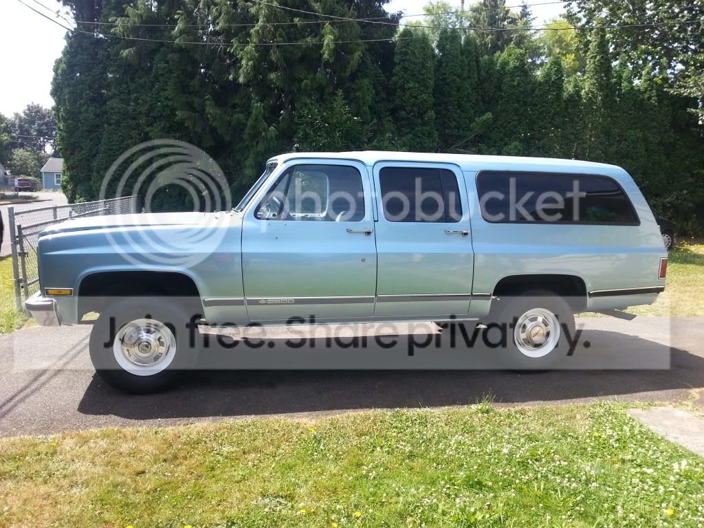

Im working on it. Slowly... I got two of my wheels painted and pulled the burb out and turned it around so that i cold get to th other side to start painting them. Heres what they look like. Since the burb is going to be a perminent fixture in the garage for the forseable future, im going to have my mud tires mounted on the steel wheels. Should look pretty awesome.

Love your wheels too...glad to see somebody else sporting the white steelies...I love that stock look...
I guess it wouldn't be different if everybody was doing it, but I like it.
