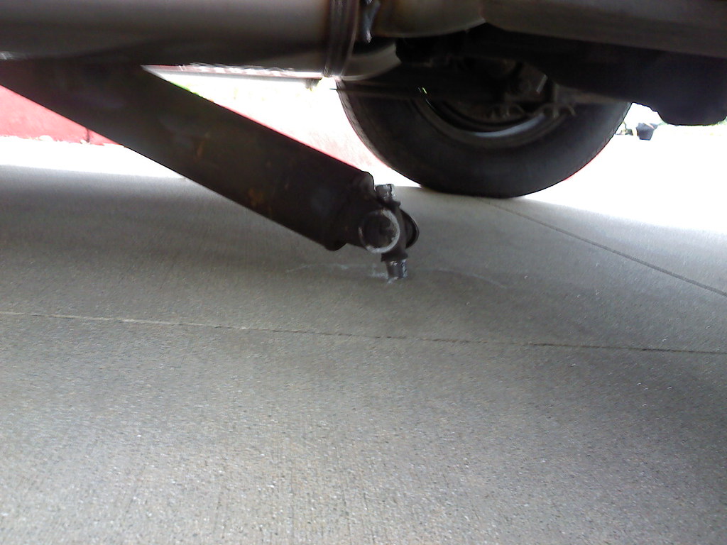

Well, my truck sounded so good on the way back from my buddies shop, I laid on it in 2nd and I heard a loud bang! :D Damn. The rear U-Joint, was absolutely GONE. The needle bearings were wadded up in the end, and the shaft portion was D shaped instead of round, as you can see, there is no grease on them!
On a side note, I got introduced to a great driveline shop here in Orange County, OC Driveline. They are going to replace all three joints, and a new center support bearing and balance for $225!
Here is a pic of the damage, the good news is, it managed to not leave a mark on my new mufflers or X pipe. I will take a pic of the exhaust later. You can see a peak of it now. I will pop the drive shaft back in and take it to the shop to put the fuel valve in. Don't want to mess with it on the garage floor. :p:
eh, light pavement scuffing. I was quick on the clutch and brakes after I heard the bang. It actually looks OK. My yolk on the diff is also ok. Thankfully. Lucky ducky me!

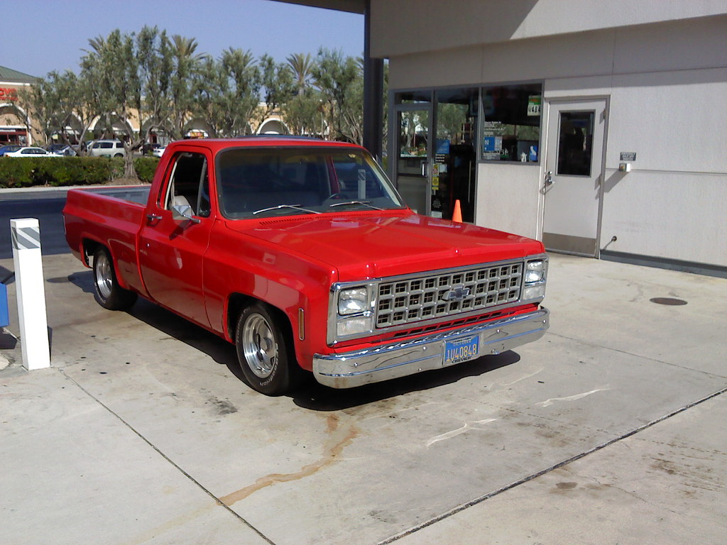

here is a pic of it after it got hit with tint and a buffer. I forgot to post it. Looks WAY better then when I first got it.
