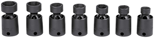

Quitting for the night.. was having a hard time getting to the bellhousing bolts...
Yes...many extensions and u-joints works from underneath.
Doesn't the trans cover come off on those or is it fixed? I can get to the bolts easily on mine, but it's an earlier model.
I got the bottom 4 bolts ok... the dang top 2 are $%#@&!! stuck... any Ideas... shot them with PB Blast last night...
