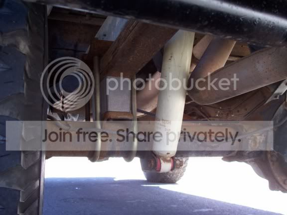

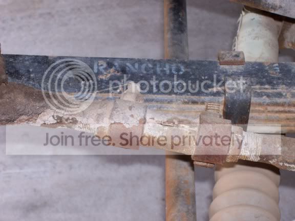

I just picked up an '87 K5 w/350 for $750 for my 16-yr-old daughter. The problem is that she's 5'3, and needs a ladder to get in! :doah: I don't know anything about the car because its from an impound. It definitely has a lift on it (see the pictures), but I need it to come back down without having to change the shocks or losing the ability to run the 32" tires that are on there.

IN the rear, you simply need to remove the spacer block (and cut the U bolts shorter if you're anal). In the front you need new (used) stock springs, as the previous owner swapped them out with 4" lift springs. Should be all there is to it.

If you take the blocks out of the back it doesn't look like there will be enough thread left on the u-bolts, so you may have to get shorter ones.
Can he just take a leaf out of the front to lose some height, or will that mess up his ride?

Shocks are cheap. If you can, get the manu and part # off the shocks. Take the #s to a GOOD off road shop. They will be able to tell ya if those will work with stock lift. From the pics, looks like you have a clearance issue between the tailpipe and the shock.
I looked today, and I think it is just an illusion. The thing bounced all over when it was loaded and unloaded. There aren't any marks or dents, so I think it will be OK.

For the rear it shouldn't be too hard just like everyone said swap out the blocks. and in da front you'll need new springs
