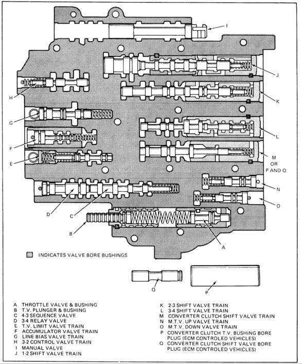

700r4 6.2.
Downshifts manually but quit downshifting under acceleration.
TV cable is bad or something with it right?
All other shifting is fine
