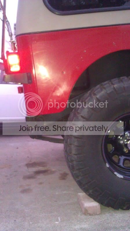

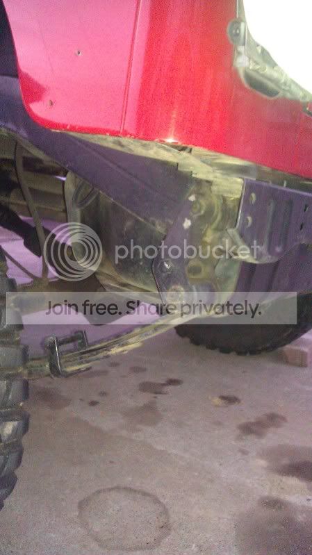

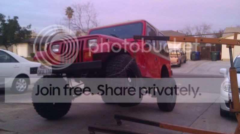

little cute flexing this evening. Shocks are not the limiting factor. they still have about 2inches of travel.
front tire was able to be lifted 19inches before the rear started to pop up.

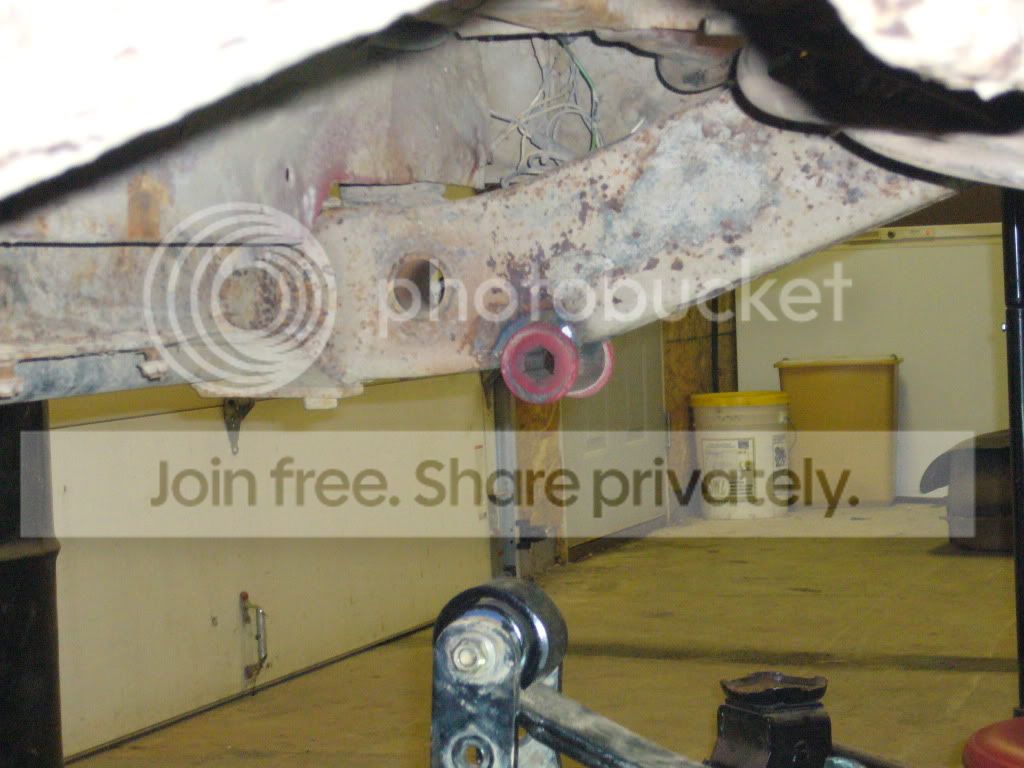

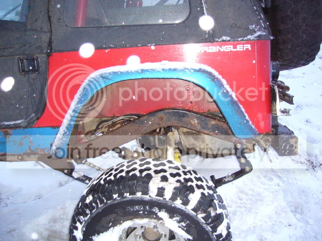

This is how I moved my shackle when I repaired my frame. The repair section height was increased 1.5 inches at the back edge to improve drainage and the shackle mounts were moved to the bottom of the repair section to increase ride height.

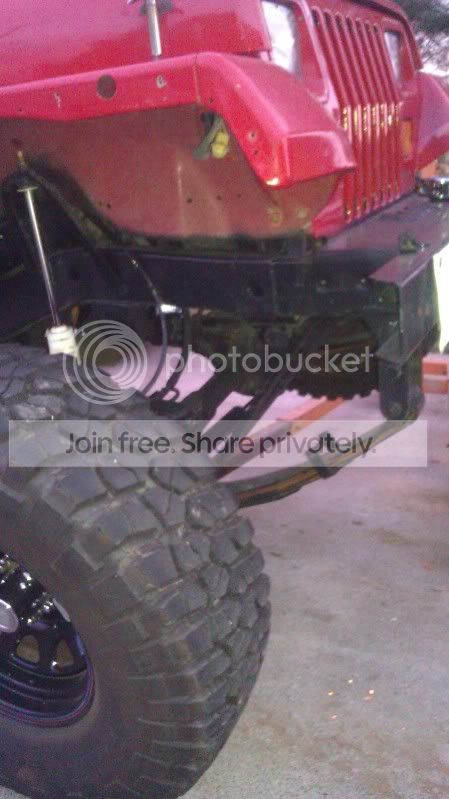

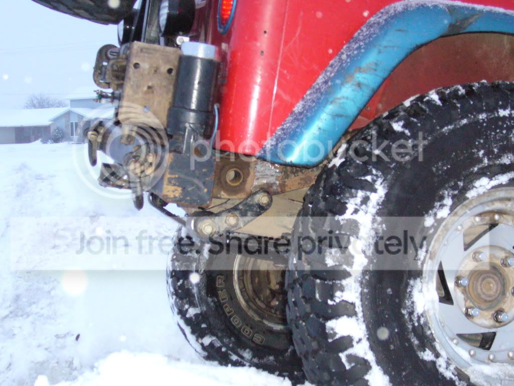

This is how my friend moved his shackle.
Shackle at full tuck, spring almost touching frame rail.
Full droop. The rear of the spring moves up/down a difference of about 5 inches, so at the axle it moves half that, so this little mod gained several inches of extra travel.
