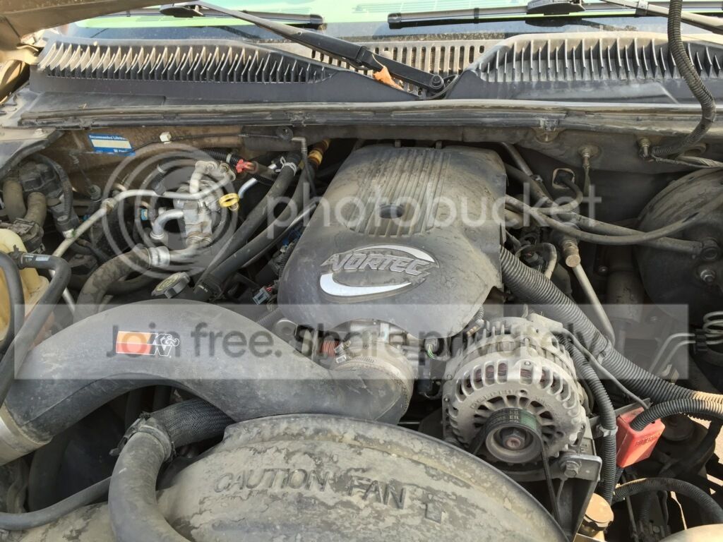

I was debating starting from scratch and nixed that idea. Plan is to take my tub off, and build a tube around my lower framerails. Narrowing the overall width to 50in. Narrowing cowl hood and narrowing grill to 4 slats.
Cage and seats are for sale since I want to redo all the cage work. My cage was built to fit under a hardtop and softtop and doors and I want a little more head room and a little different design. I also want high back seats. So selling it so somebody can slap it in their jeep and be ready to rock.
I was going to compete at calrocs in donner next weekend but this deal came up with the tahoe and I jumped on it. Sold the doubler to fund it so now jeep is down. For now I'm just gonna put the 5.3 in and leave the body alone for now.
Gonna end up running a th350 or th400 and a 205 behind the 5.3
