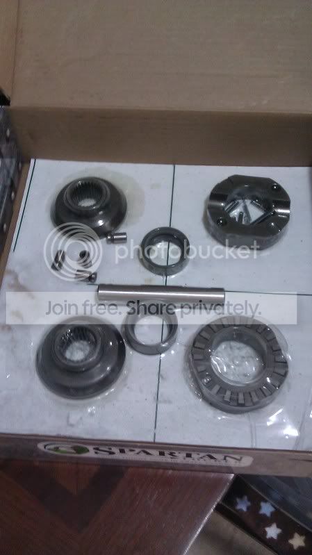

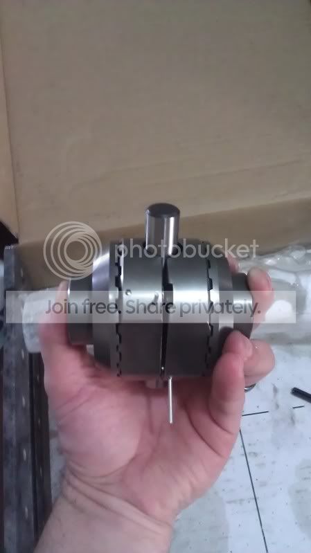

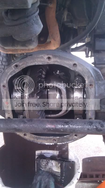

Ordered a Spartan locker from Baseline4x4 on wednesday. Showed up today!
was only 259 to my door.

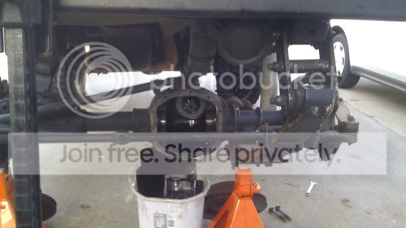

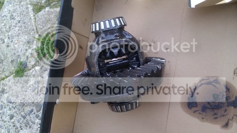

Simple install took about an hour and a half.
pics!
You have to.

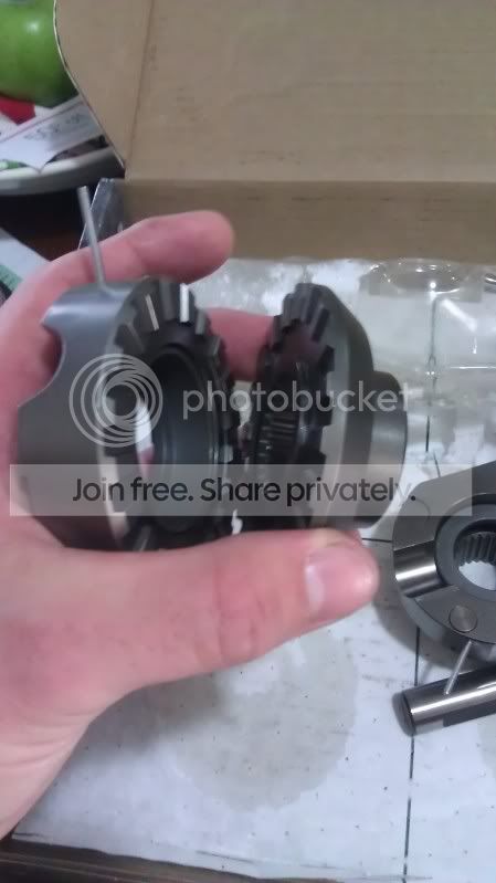

The crosspin needs to come out and with thick 4.56 gears almost half of the crosspin is blocked by teeth.
