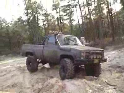

no good flex pics yet.. ill get some once it is back on the road...

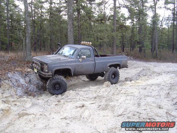

40" hawgs stuffed under 6" superlift and 1" ord..
that truck is siiiiick!:bow:

snorkel worth it in deep water.... he needed help....
