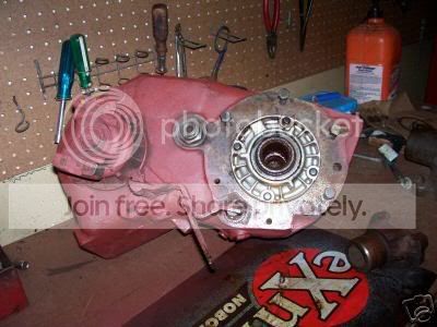

NP205 cloCking plate
isn't it the same pattern as a 208/241? made producing the different tranny/t-case combos more cost effective if they all took the same trans adapter.

DIY makes a 241-208 clocking plate. They should be the same as the round 205.
If you look in my Truckhaven thread there is a pic of my 208 adapter with no case on it and you can see the bolt pattern. Just search Truckhaven and it should pop up.
Dik
You need to learn how to read.
As for Kerts clocking plate, I dont think its going to work because one of the shift rails on the 205 is in the way.Here's a pic of a ford case with the same interferance im talking about...
Anyone got any other ideas?
get a 208 clocking ting and cut a notch in it for the shifter rails. or redrill the case.
