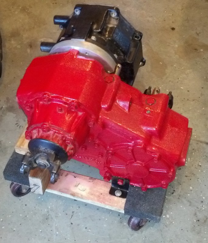

I have done gloss black / chevy orange / and for my big money 1 with extra goodys I did this . http://coloradok5.com/forums/showpost.php?p=2526548&postcount=29

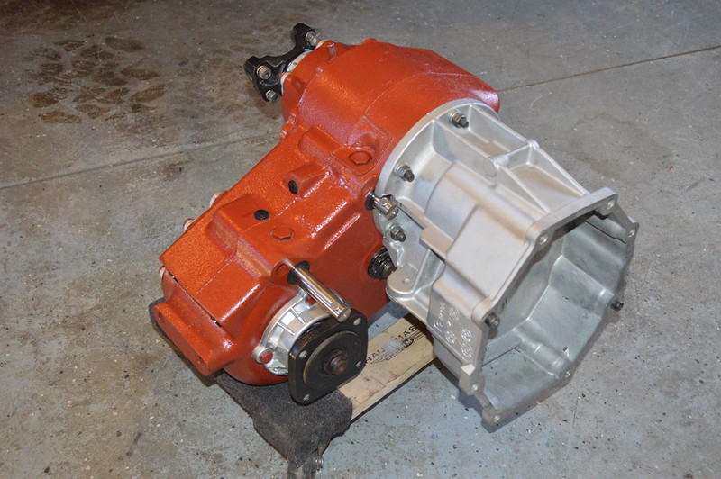

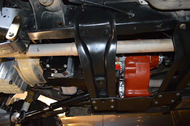

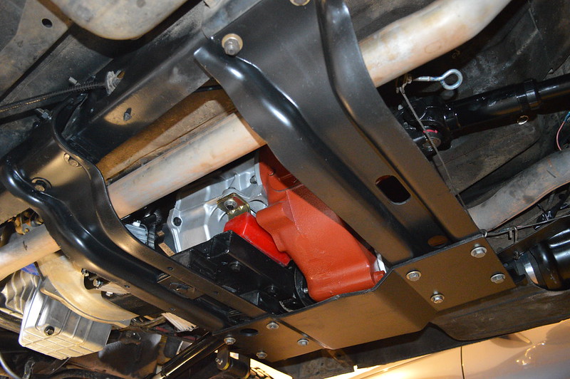

As mentioned, it seems the 69-76 were red for sure…..like a primer red. The reason I go as late as 76 was the fact I bought an unmolested 76 K10 to pirate all the SM465 goodies to convert my K10 to a manual trans back in 1999 and it was factory red. I also just dismantled a 75 K10 for my buddy an its 205 was primer red. It seems the later 205’s I’ve pulled were black or just bare...hard to tell.

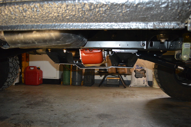

I prefer the primer red as it looks clean and easy to spot leaks. This time I actually sprayed clear coat over the primer keep it from oil staining as it seems no matter what you do you cannot keep a 205 from leaking at least some place. Mine has an impossible to stop seep at the speedo cable even with a new collar. Its not enough to drop any oil on the ground but it makes the side of the 205 juicy. Drives me nuts….I hate leaks! The nice thing about having everything painted and clean is it is so easy to keep it that way. Its been 2 years and about 10,000 miles since I redid my NV4500 with a round 205 and even after a few desert trips it still looks as clean as it does in the picture below....well, after a carwash when returning from a trip.

Other 205’s I’ve built I used farm store Case tractor red. It’s a bit bright but this oil based tractor paint seals it up nicely. This one didn’t leak anywhere but I still like the primer red with clear better
