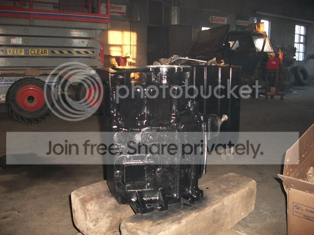

scrap yard painted it aluiminuin, its an nv4500 out off a 1998 gmc 1 ton 6.5l. not sure what clutch system we will use but i always like simplicity, thats why its probably will be mecanical.

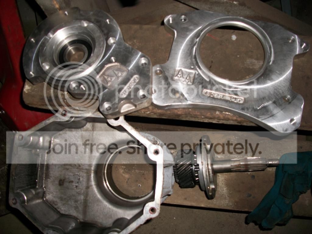

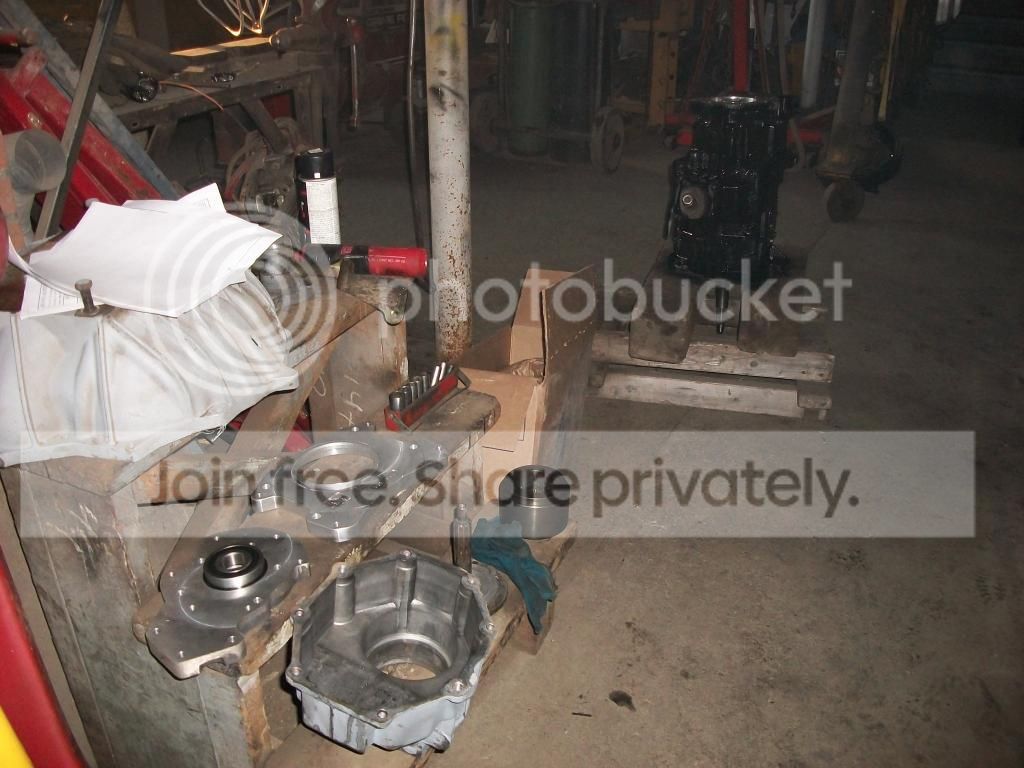

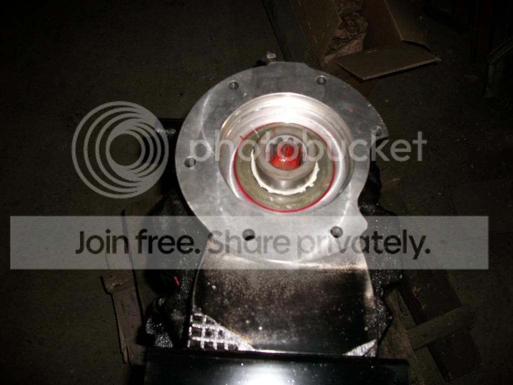

parts are in:laugh: took a while too get my 42 ford out.were kd of late starting this, but we will take what ever time it takes(hope its understandable). got the transmission ready ,longer dodge main shaft machine for a gm clutch throw out bearing. took a big balancer off on the rear shaft to install a kind off clamp,then cut the shaft too 4,498 inch long. and install rear adapter for our np205. the reason for the dodge longer shaft, is too keep our stock bellhousing and clutch size,if we would off used a new bellhousing we would off have too use a smaller diameter clutch. and a smaller starter. because its a 6.2. wife here supper time pictures later:dunno:
