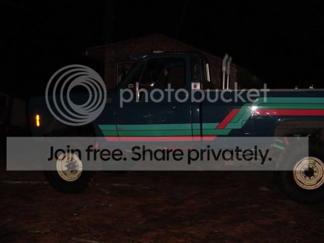

Well guys check out my newest purchase a 75 longbed, 6 or 8 inch llift brand new 36'' humvee tires

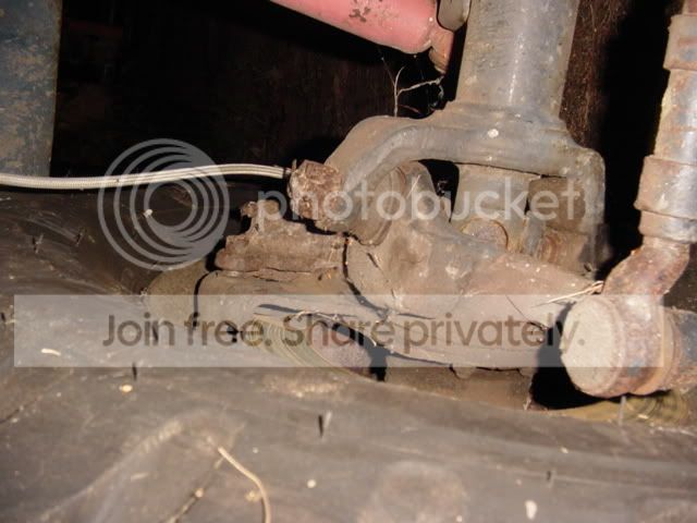

My buddy broke it last time they were 4 wheelin, sheared it at the u joint, so thats all it needs to be complete and 4 wheelable.
So my next queston is where do i get a shaft for it. My buddy was sayin that i could get a new spicer inner and outter for like $140 from a local truck parts store, he was just too cheap to buy a new one.
Or what would hold up to abuse better than a stock one?

Looks like it has sat for a while huh...? not to bad though, should be a great start for a wheelin rig. What did ya have to give for it?
P.S. Sweet stacks man.
$700 but it has new tires and it runs and drives almost... The frame is Wicked clean, no rust or rot at all. Plus he said he will put the new shaft in for me, so i'll learn how to do it, so i can know for a trailside fix

D44 shafts aren't to hard to come by. If you have trouble findin one let me know i might have a few layin around still..
Yep, as said before, flat tops.
Shafts can be had easily and cheaply if you ask in the "Wanted" forum. And DIY on swapping it in so you can learn how to do more of them in the future.

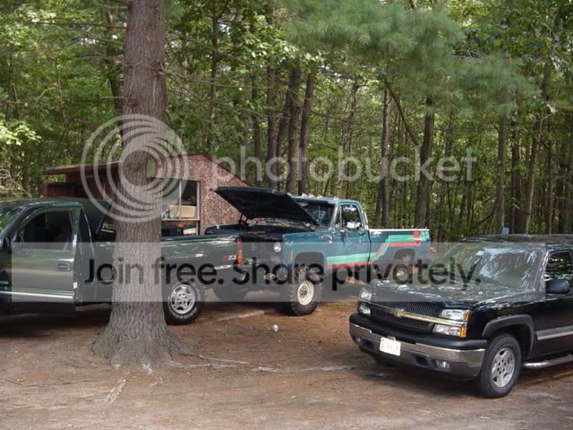

Well i started workin on it today, got everything cleaned out, and it running off a gas can.
I have never had a big truck, it's kinda funny that i have to back my 02 chevy up to it to work under the hood...

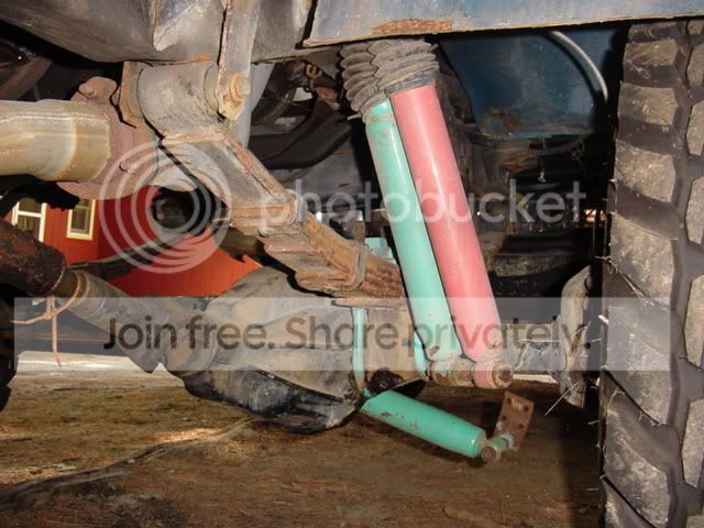

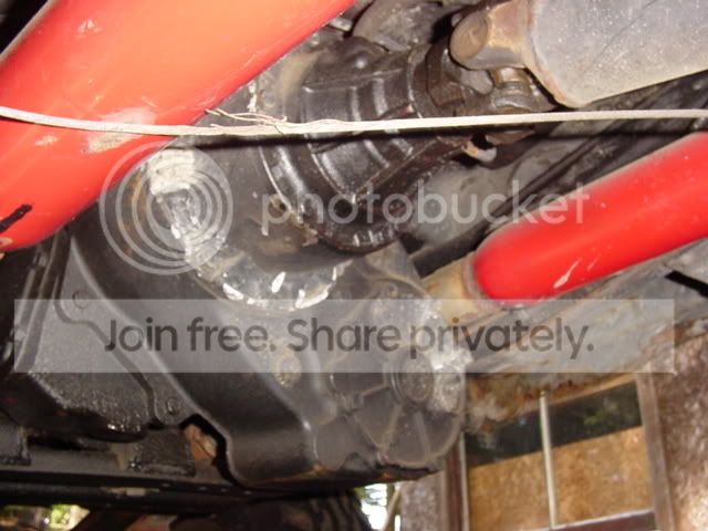

I have a couple ?'s
First is that a NP205 Transfer case, and what's the pattern, for 4x4 2x4 etc

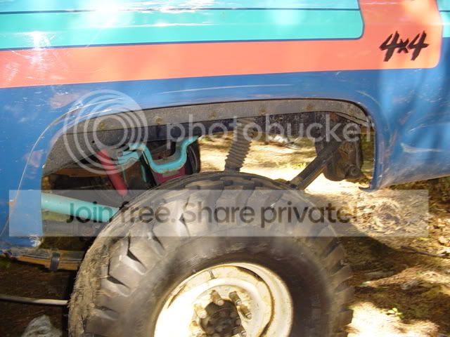

And can you guys tell how much lift i have?

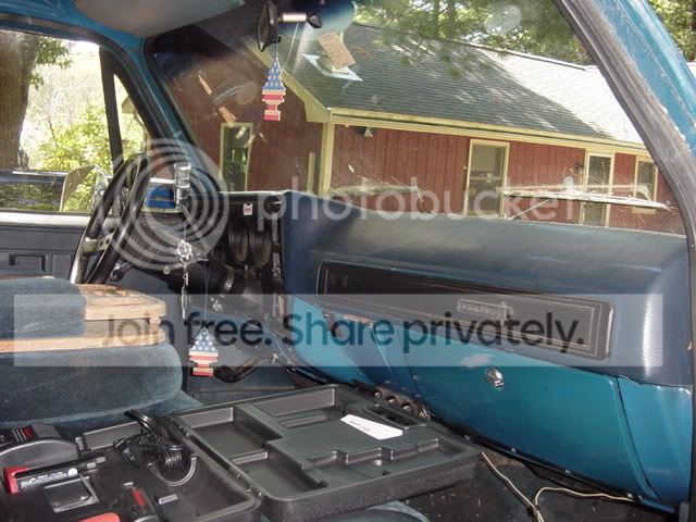

It's nice inside, and the dash is perfect Too

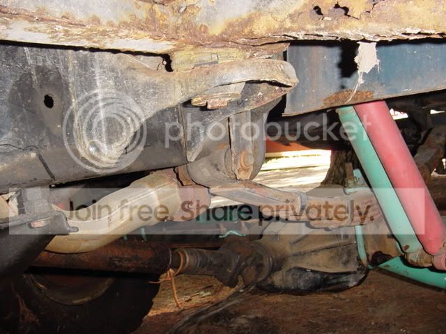

What you have there my friend is a NP203 not a NP205 .
Can't say for sure on the lift but a geuss is 8" lift by looking at the arch of the springs .
Tom

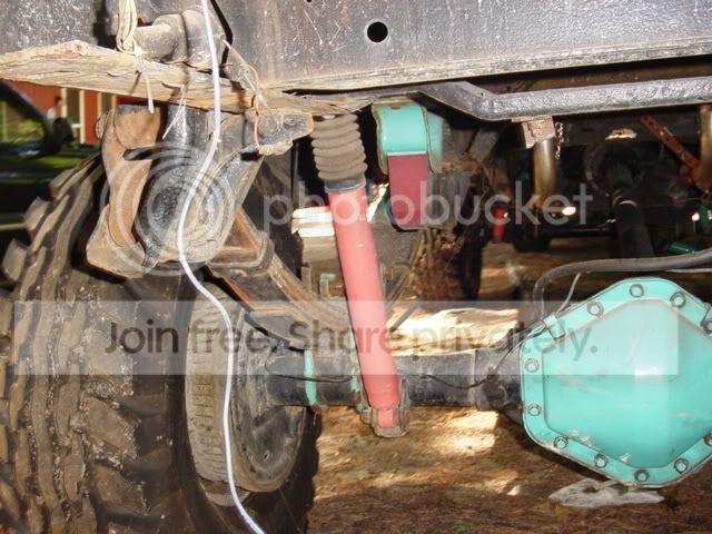

looks like 6 inch lift.. hold on let me get a better pic of my truck...
just took these pics 3 mins ago.. im pretty sure u got a 6 inch lift springs in front. mines a 6 inch superlift softrides in front, and the back is a 4 inch shackle flip, stock hd springs and 2.5 inch blocks. enjoy.. and i have a half life left humvee tires

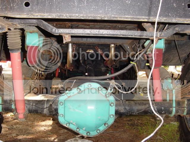

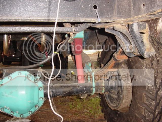

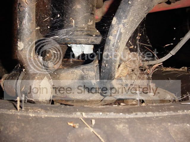

Got some of the lift blocks? i got a shackle flip from kert at DIY4X im gonna put on, in hopes of a softer ride... rides like a freakin brick
Tom
Tom
gotta get them.. hold on again!:D
Tom

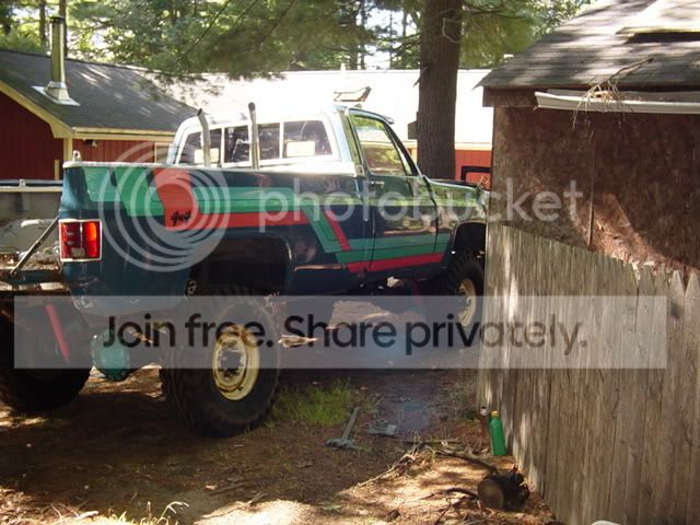

here it is... guess today is soo nice for pic whoring...:laugh: my lift blocks is on backwards because if it was on the right way the pinion angle is no good, backwards its perfect.. last pic is when the truck was half naked.. and other 4 is from 5 mins ago, how she sits now..
