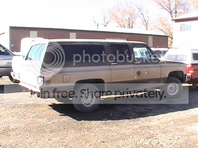

It is a 1987 from the door sticker and the verify sheet from the sell using the vin 1gkev16k6hf that it is a 1987 Chevrolet V10 with a 350 TBI. We know it is an automatic transmission from the movie and Cinema Vehicle Services pictures. In these pictures we can also tell it has a rear AC unit. It also has the end gate. It has auto hubs on it. It has the light blue cloth interior with front bucket seats and no third row seating. It's RED!
Metro's:
1988 Chevrolet V10 Suburban 350 TBI
4 speed manual transmission
No rear AC
Has the end gate
Has auto hubs on it :doah:
Cloth interior in tan with front bucket seats no third row seating.
It's Brown and Tan.

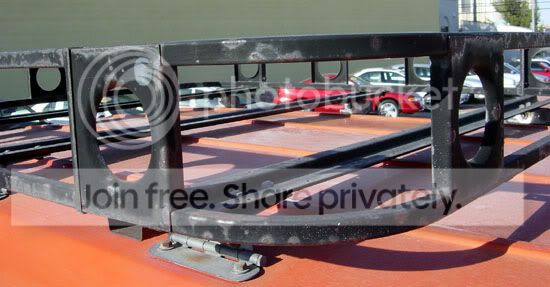

I found a Con-Ferr roof rack on Ebay and it was 42x60 a little narrower than what I wanted but it will work. Here is the pictures of it. I will need to either make or find mounts for it. This section will deal with installing the rack when we do it.
UPDATE 23 July 2013
Well as I feared the rack is to narrow by 18 inches so it appears the one in the movie was 60" x 60" Ours will have to be cut and some how have 18" inserted in it in the center.

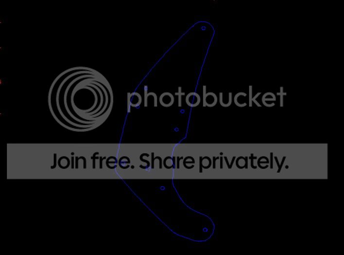

I have been in contact with WARN and they are helping in completing this build. The set up on the truck is actually called a Combo Kit. They found the mounting instructions and even a CAD. We found the center part (winch cradle) in California. The problem was that it had no brush guards.
With the information a person would be able to replicate the part.

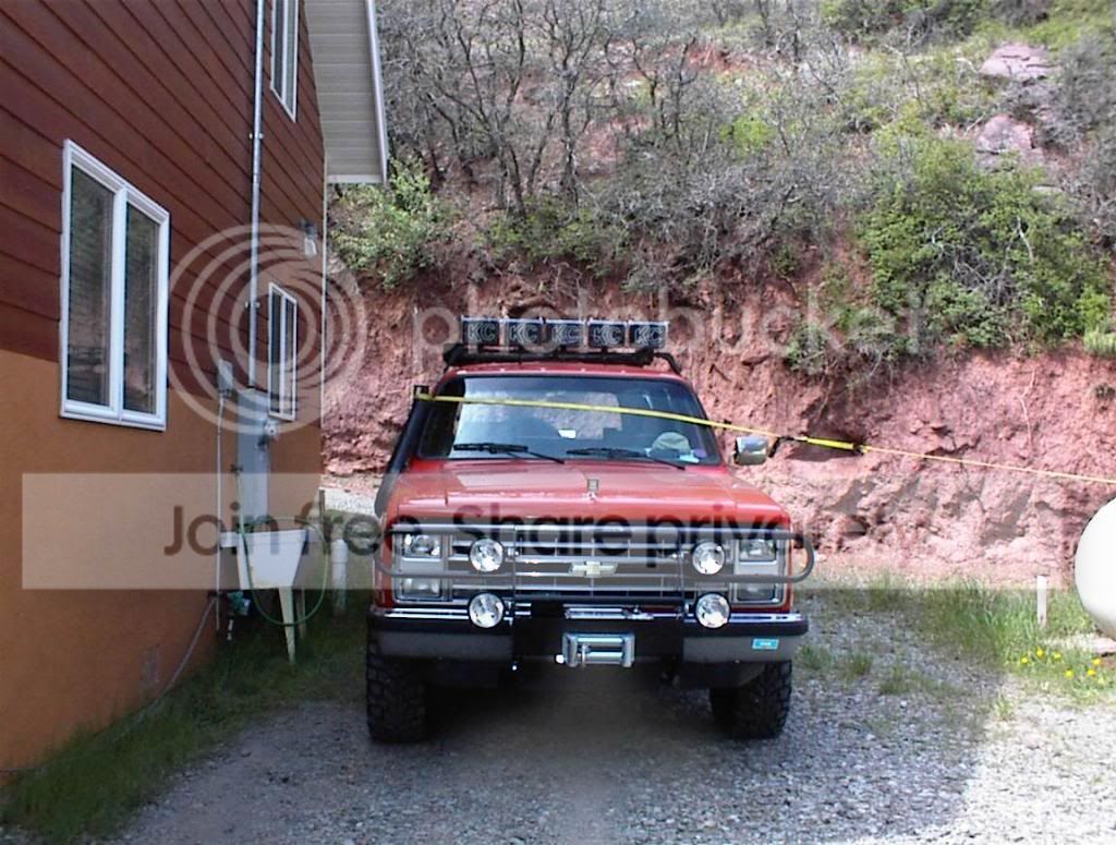

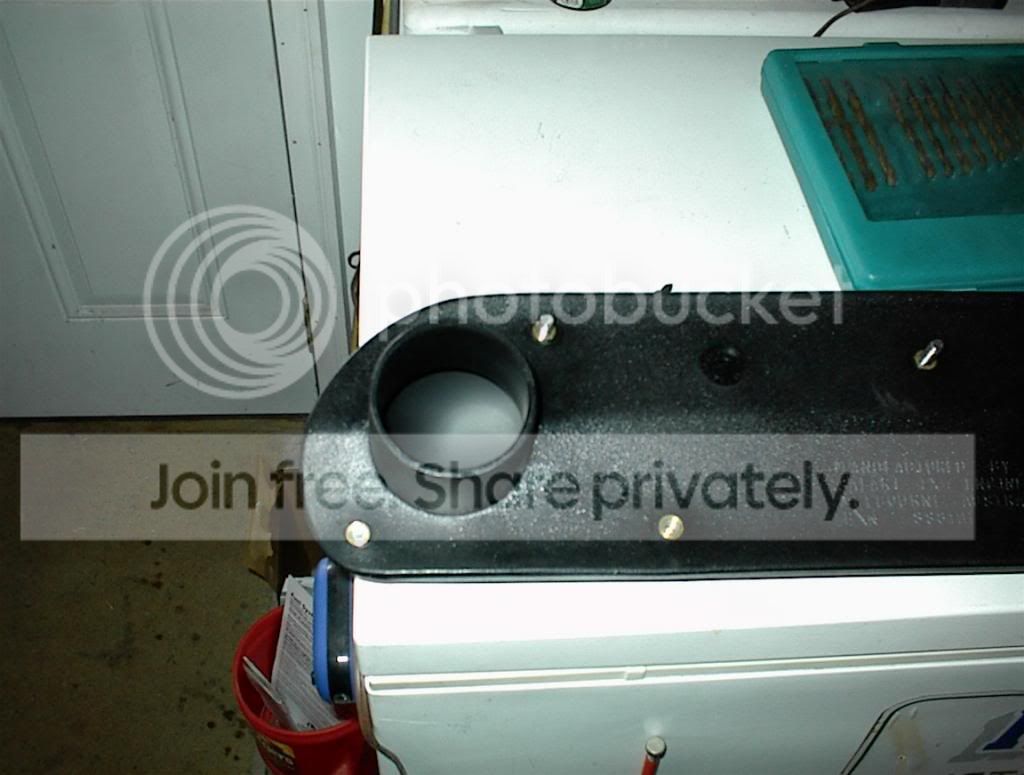

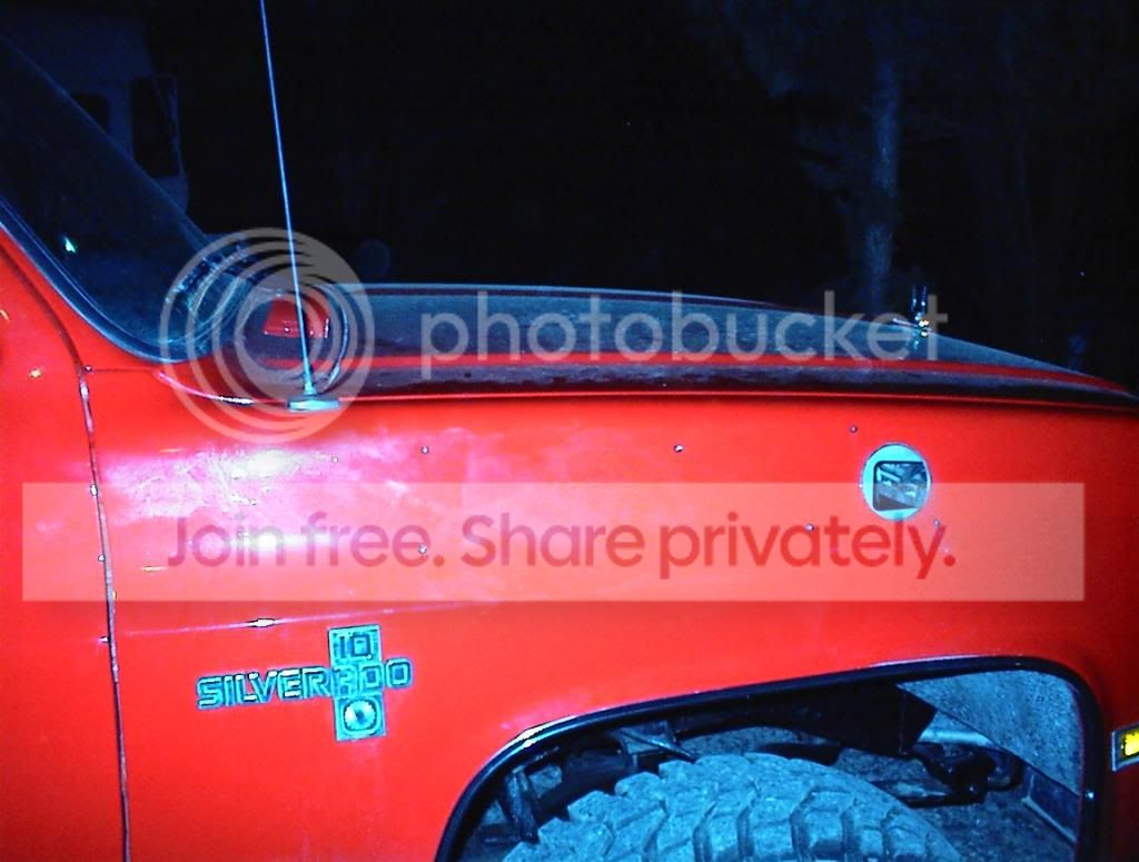

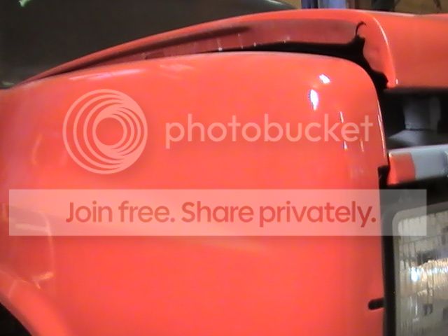

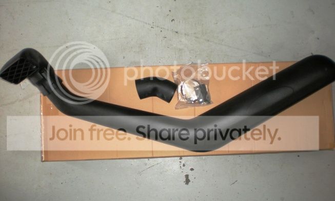

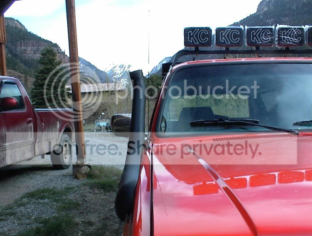

The snorkel install. 4 May 2014

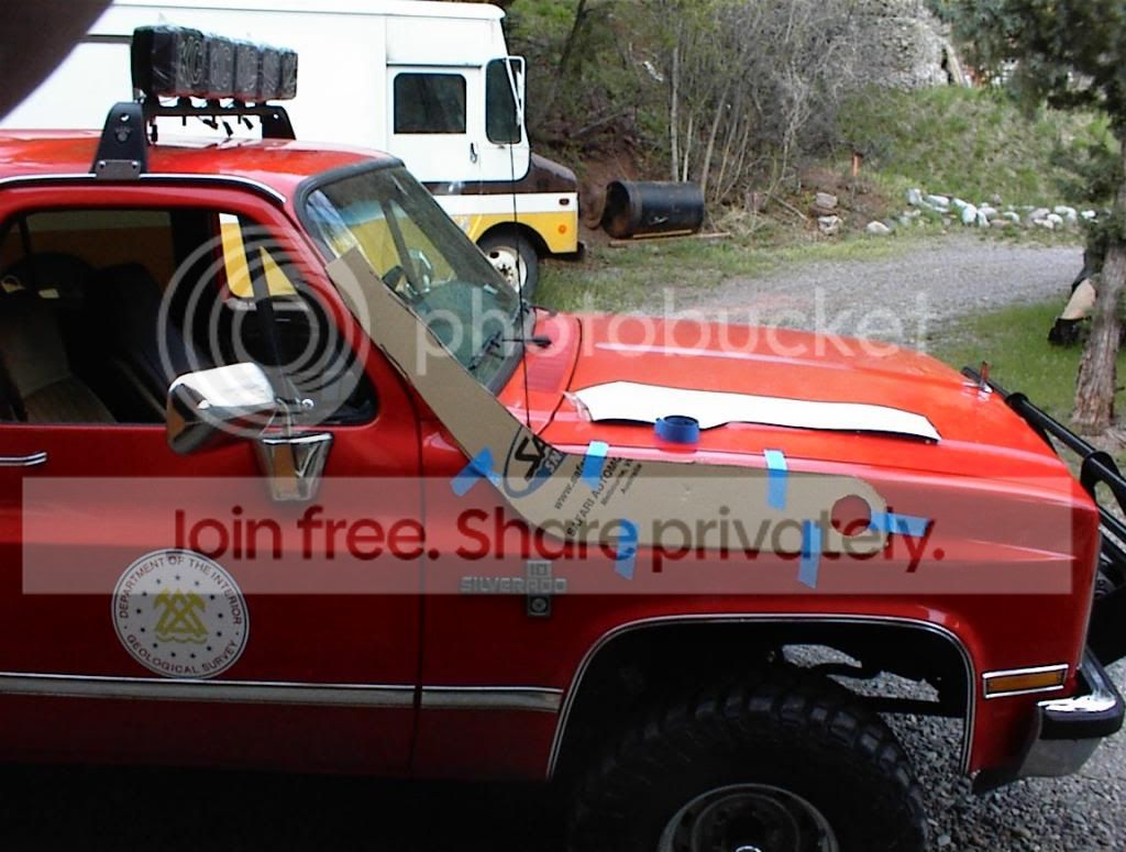

Got the holes drilled in the front up rights for the top round lights on the front today and got all of them mounted. Next moved on to the snorkel (Toyota 80 Series SAFARI Snorkel # SS81HF) since the template is for a different vehicle we had to improvise.
We cut the cardboard box to make a template of the snorkel with the hole pre-cut. Next we took the Toyota template and centered the pilot hole to the card board cut out.
Next we trimmed the Toyota template to fit the top edge of the card board on top (edge we held to fender top). Once we had revamped the Toyota template we taped it to the fender and marked the holes.
Next was the leap of actually cutting the hole in the fender. It is very important to take your time doing this! We kept using oil and wiping the slurry off the hole saw. By the time we were done we were working under lights.
So Monday we will be doing the actual mounting and tweaking of the bend.

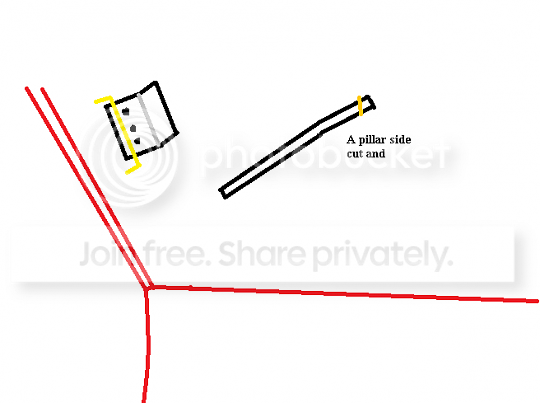

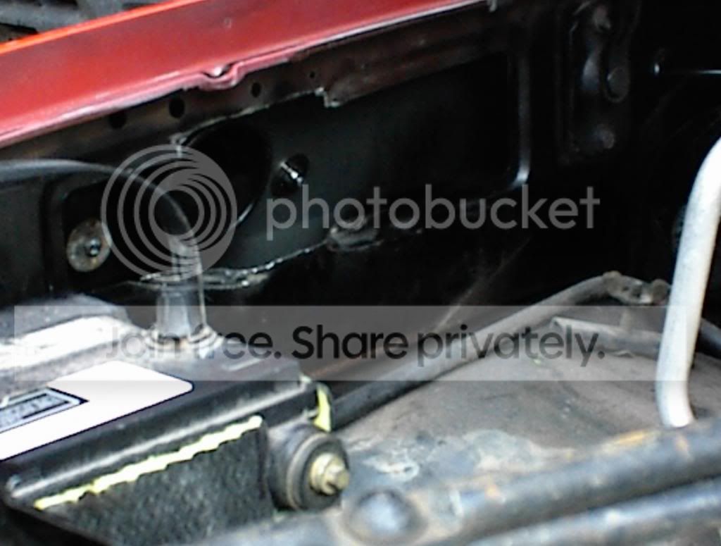

There are two studs that you need to change to bolts so that are long enough to fit the K5 and suburban fender. (8m x 1.25mm x 31.75mm) They are the first and second lower from the front.
Then I had to cut the support in the crumple zone and will later have a flat metal insert tack welded to the rear of connecting hose. I will make a flat metal cover to put in front held by screws to stiffen inner fender.
Taking the battery and over flow off before starting makes things easier to work in area. Here is how the snorkel looks before heating it.
So to get the correct angle on the snorkel it was filled with sand and heated. This is a long slow process!! You apply heat to the over all area and keep moving around the elbow section. We heated above and down in to the flat area. This is a strap attached to the snorkel and a fixed item to pull it towards the pillar. As we got it closer we keep the strap tight.
Next the bracket that was supplied had to be almost flattened. The three screw side was trimmed to allow the bracket to fit the truck. The back edge was angled and taken down to the mounting holes.
Here it is attached and looking like it was made for the truck from the factory. Looks like time for a poser picture!

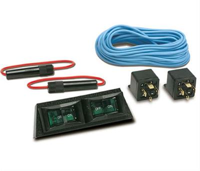

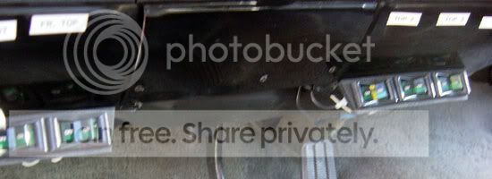

The switches for lights.
With the help of members we figured out the switches might be made by Pro Comp

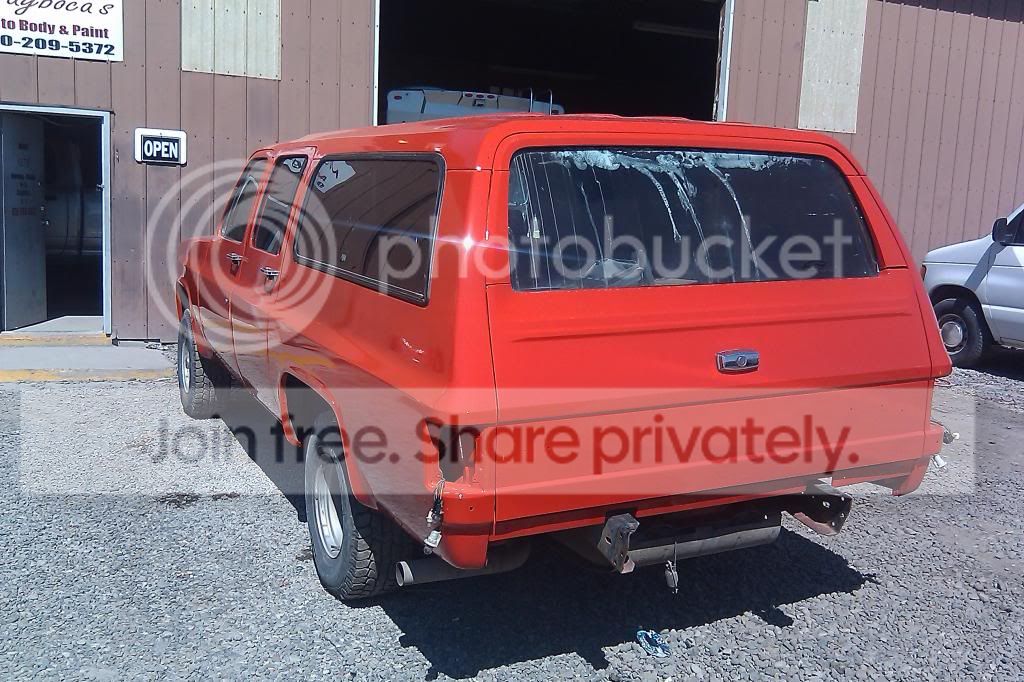

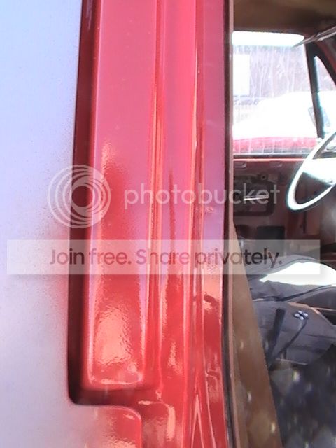

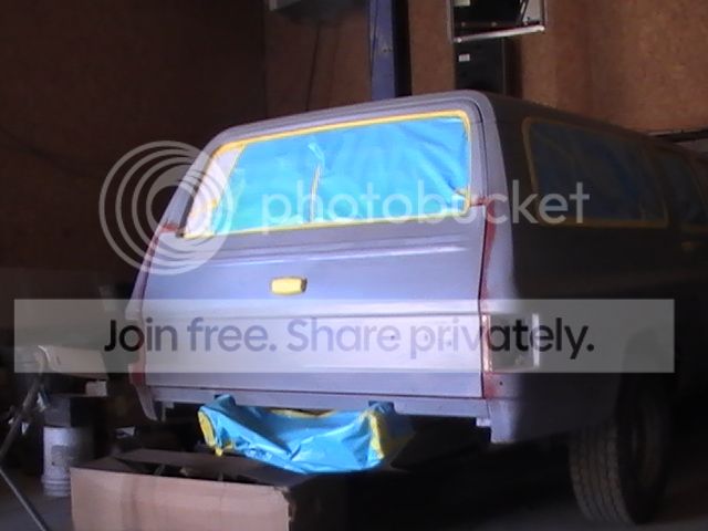

This section will deal with Painting the truck.
Martin Senour Paints/Sherwin Automotive Finishes joins us as a sponsor on our project and will be providing us with materials to paint the vehicle.
GMC paint code 514 Red (Crimson)
attachment.php
Truck went in for paint work on 11-24-2013
17 February 2014
A little color starts to shine. Sorry my camera started acting goofy color is not showing correct.
Little upset his helpers sanded off the door tag :doah: I had it taped to protect it.:thinking: Now if I can find the company that makes repos for $65 :doah:
25 February 2014
:D

I located a Con-ferr basket that is a little different but real close. Basket measures 60" x 42" it is narrower than what I think the original was.
I have 5days to get enough money borrowed to get it. When you do a search for "Dante's Peak Suburban" CK5 comes up first in the images.

Well I won the Con-ferr Roof rack on eBay today so that now leaves paying for the rear tire carrier and obtaining the Carr light bar, lights and snorkel. There is a member here who owns a WARN Trans4mer who said he would help on getting measurements and pics.
