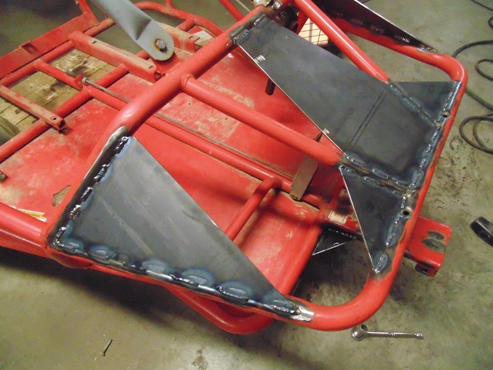

Got these all welded on this afternoon

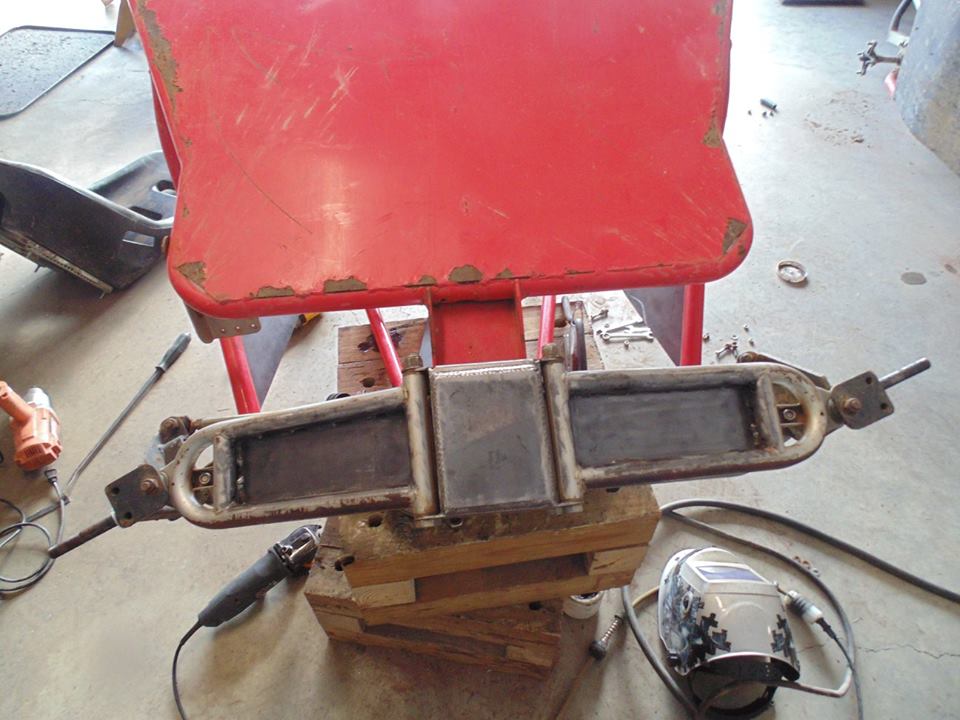

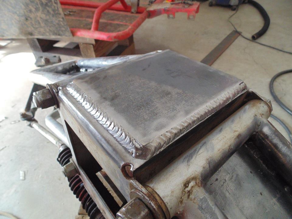

Plated the top of the lower A arms. I will probably plate the upper A arm too, leaving a hole for the shock to go through but I need to get that in first and cycle the suspension to see how much room to leave.
Don't think this arm will have any trouble holding up to some abuse now.

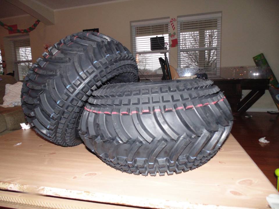

New front wheels, tires, & hubs. Had to chase the UPS truck driver down to get these. Said he couldn't find my street. I think he just wanted to keep them for himself, hahaha.
20x7x8 tires came already mounted on the wheels and aired up from the supplier

Welded the underside of the plate to the lower A arm
Don't think that is going anywhere

Plated in the bottom of the front suspension box
Used 1/4" here since it will be acting as a bit of a skid and will get the brunt of any impacts

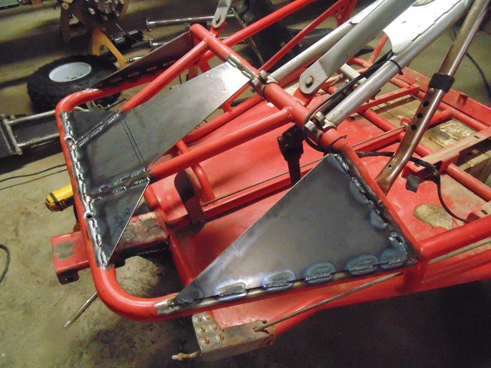

Flipped the red and silver cart over to weld the underside of the hood gussets to the frame
Should have all this welding done today and a bunch of other stuff too.

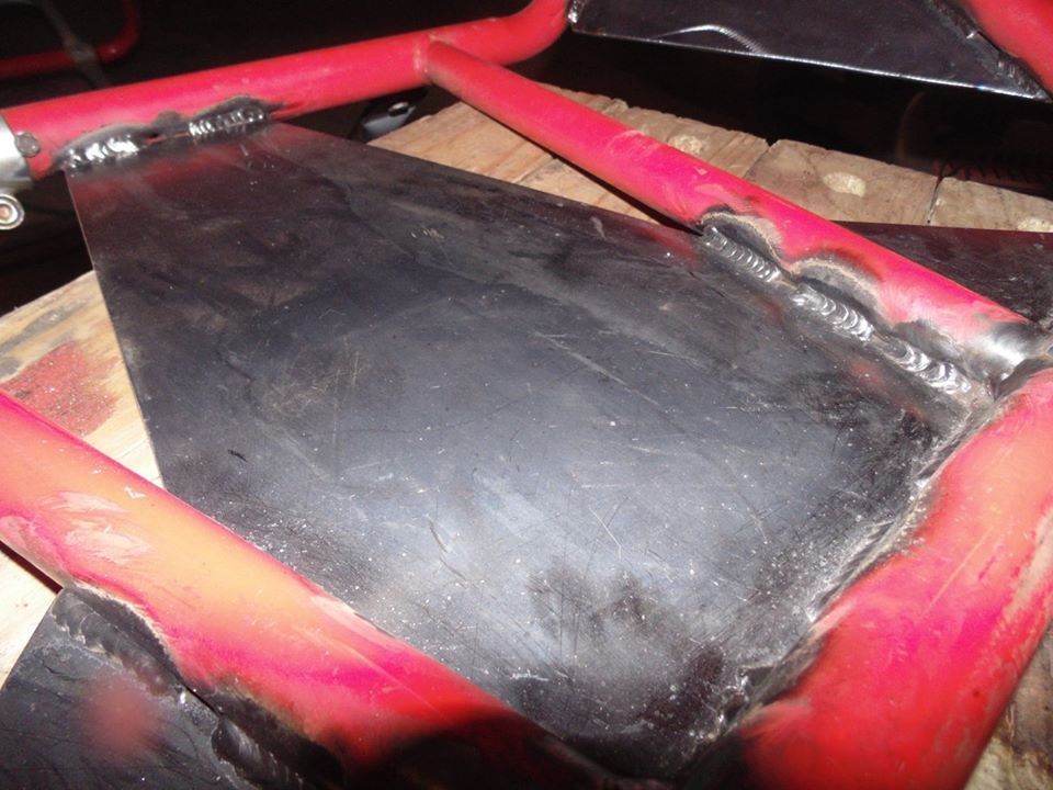

Welded the underside of the hood gussets

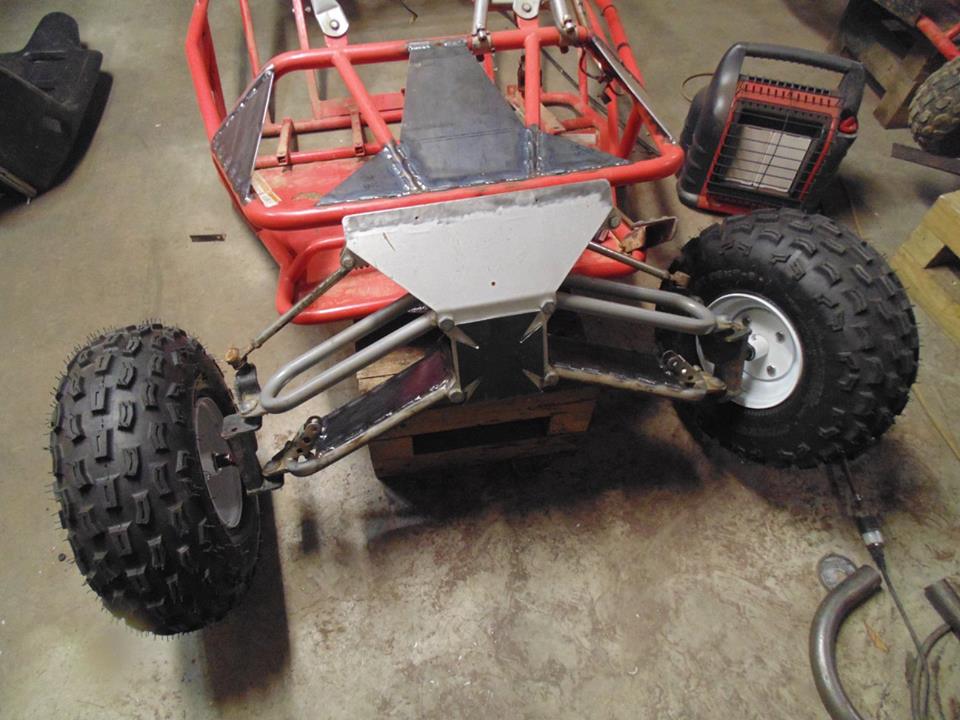

Put the front end on to see what kind of gusseting I was going to do
That red arm sticking out is what I wanted to beef up
Started by welding some gussets in the corners and putting some 1" angle in to stiffen things up
Added a piece of 3/4" angle in the middle and welded that in
Boxed in the arm up to where the front end stops
Welded some nuts on since this area will now be inaccessible with the bottom of the front end plated in as shown a couple pics ago
This front end is actually going on the black and red buggy. I just wanted to see how things were eventually going to look. That iron cross is a reinforcement plate that will be welded on soon. The bulk head and all the hood gussets on the black and red cart will be painted black and the iron cross will be painted either red to make it pop or black for the stealth look. Either way, the black and red cart shall henceforth be called the "Iron Cross Buggy"
Started working on the old front end that will actually go on the red and silver cart. I decided that I will not be plating the A arms on this front end but will still plate in the bottom of the bulk head using 3/16" and doing a bulk head reinforcment plate as shown here.
To keep things a little different I went with an hour glass shaped bulk head plate. The bulk head and all the hood gussets on the silver and red cart will be painted black and the hour glass will be painted red. This cart shall henceforth be called the "Black Widow Buggy"
