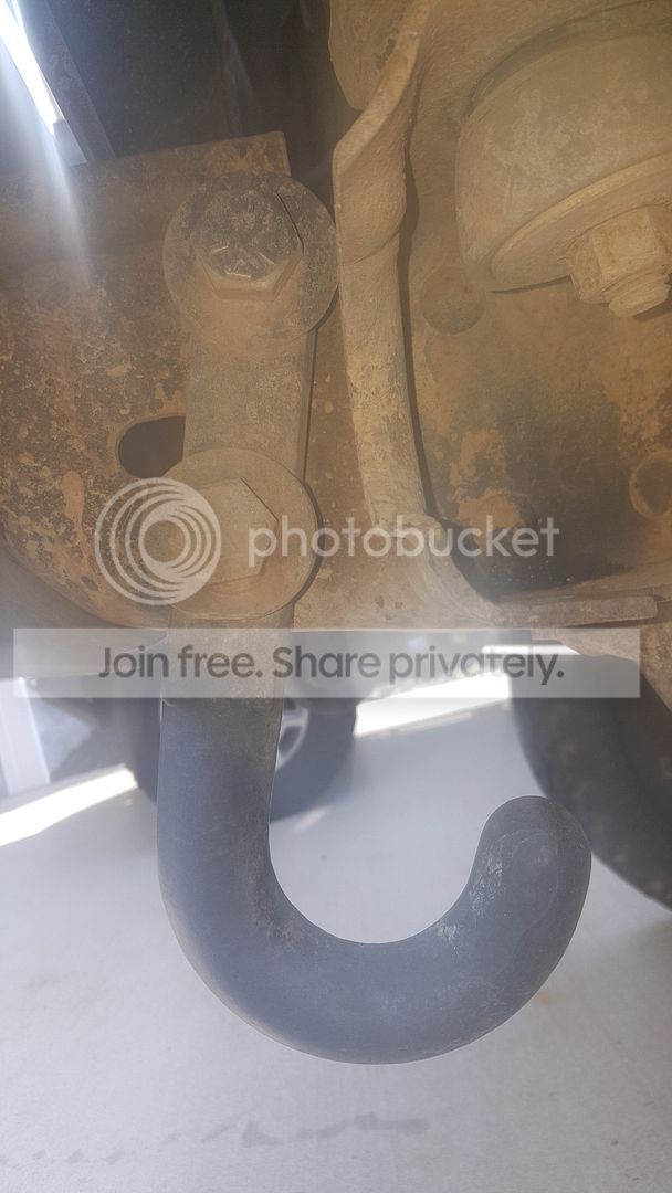

Rear bumper, trailer hitch and fuel tank removed.
Shackle flip installed. I have 6" shackles on there now with the 56's, may have to go down to 4" shackles depending on shackle angle when I get the axle bolted back up and the weight on the springs.
