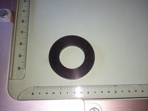

Also, going to help you out with a link since you have an a-bomb bumper too.
Just ordered these this weekend to take up some of the slack in the d-ring shackles on the a-bomb. They will serve as good d-ring isolators at the tabs.
http://www.ebay.com/itm/170820214500?_trksid=p2060353.m1438.l2649&ssPageName=STRK%3AMEBIDX%3AIT
Still looking for something to put on the bow of the shackle so they don't clang on the bumper. I know Daystar makes a shackle isolator for 3/4" shackles but I don't know if it will work on the 7/8" shackles that the a-bomb takes.
http://www.ebay.com/itm/Daystar-KU70056BK-Black-Polyurethane-Pair-of-D-Ring-Isolators-for-3-4-Shackle-/321808402458?hash=item4aed46881a&vxp=mtr
If the Daystar stuff won't fit I might just have to split some hose open length wise and use zip ties or adhesive or something.

Thanks for that link!
