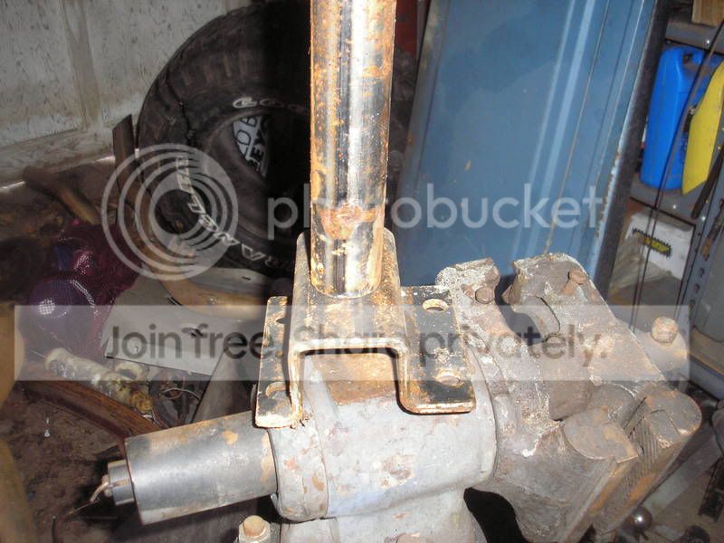

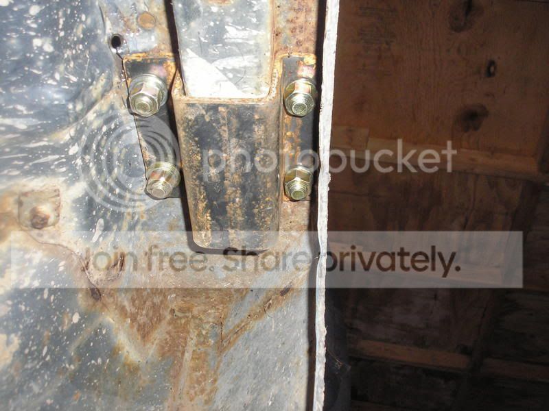

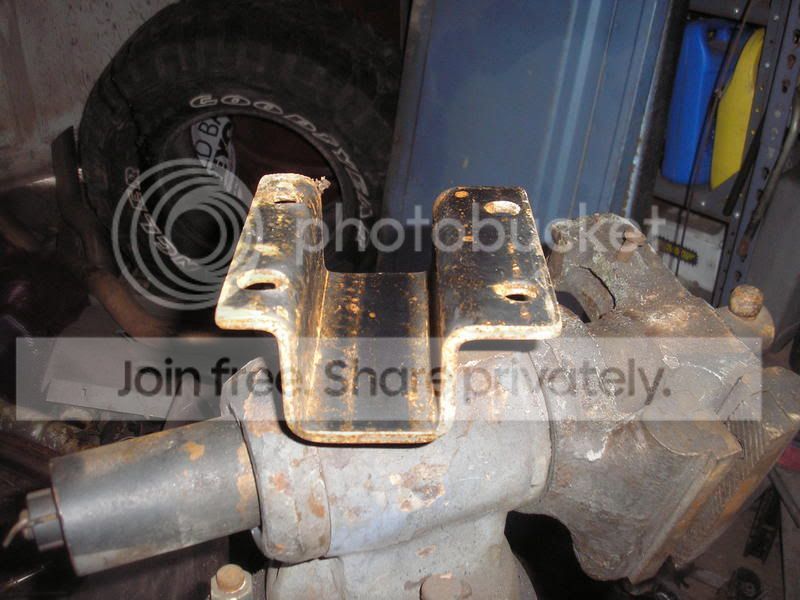

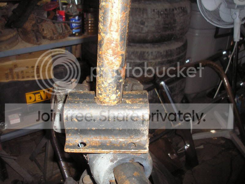

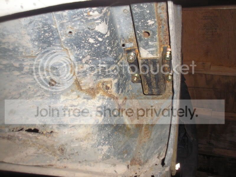

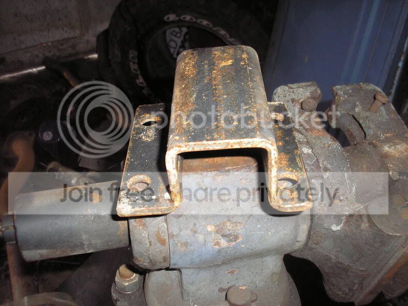

here goes with the pics. lots of them.
this is the complete rear hoop before I welded the plates to it. I tacked it in the truck and pulled it out to finish weld it.
this is the plate I made for the underside of the cab in the back. two pics to show the shape and two pics to show it installed. it has 1/2 inch holes in it and I bolted it in with grade 8 bolts that are 1.25 inches long.
this is a piece of 1-5/8 tube bing to give you some reference on size. I am going to weld some tube from the bottom plates to fish plates on the frame. I have thought about bolting it to the frame instead. that way when I destroy this cab I can unbolt everything and throw it away instead of trying to save it for a third time.
I hope this helps some. :D
