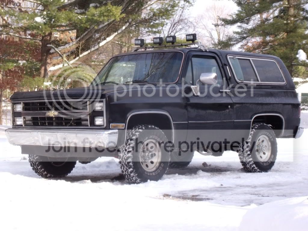

Holy crap this is completely perfect to the T of exactly what i want.
He says 33 mickeys with no lift but looks like he has about the same space up front as mine and a little more in the back than mine, but i have 32's could i just do like a one inch block in front and back to make wide 33's fit and look like this without needing new shocks and steering parts??? Like those zero rate add a leaf things from ORD???
This thing is just so gorgeous.
My dads 91 suburban had the exact same paint job and its my favorite.
Ill post a pic of mine to compare wheel space. any thoughts?
