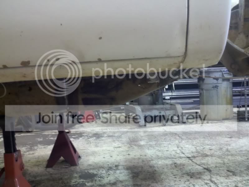

Here's what it looked like before, at least the frame part:

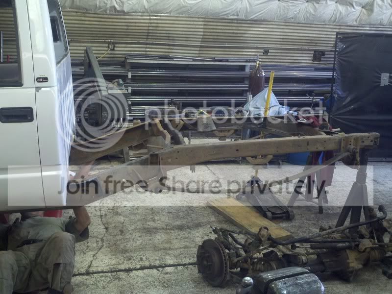

Here's what it looks like after yesterday's fun:
It's missing 15" now, which should put the wheelbase in the 117" range. Maybe a bit more since our SAS brackets will move the axle forward a bit.
Here's the splice under the cab, it'll have a diamond shaped reinforcing patch when it's finished.
