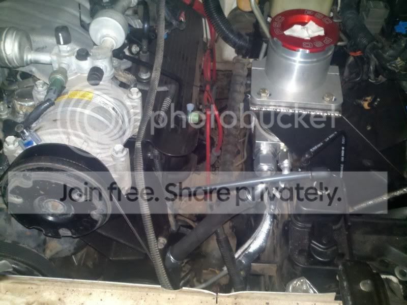

I mounted the res for the power steering today, along with the ARB compressor. Buddy Alex Santiago, came up for the weekend and wired the aux fan override and the clutch safety bypass among a whole bunch of other things.
