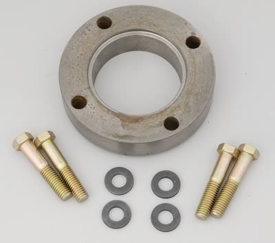

Is this Superlift 1" driveshaft spacer (part #4310) for an NP208 or a NP205? Is there one made for the NP205, and what would be the part number? One of the reasons I could not find this part in the Superlift cataloug, is that is listed for Dodges only , even though it will fit a GM as well.

I called SuperLift and got some dimesions on their driveshaft spacer (part #4310).
Bolt patern: 3" X 4-1/8"
Outer diameter: 5"
Inner diameter: 2-7/8"
