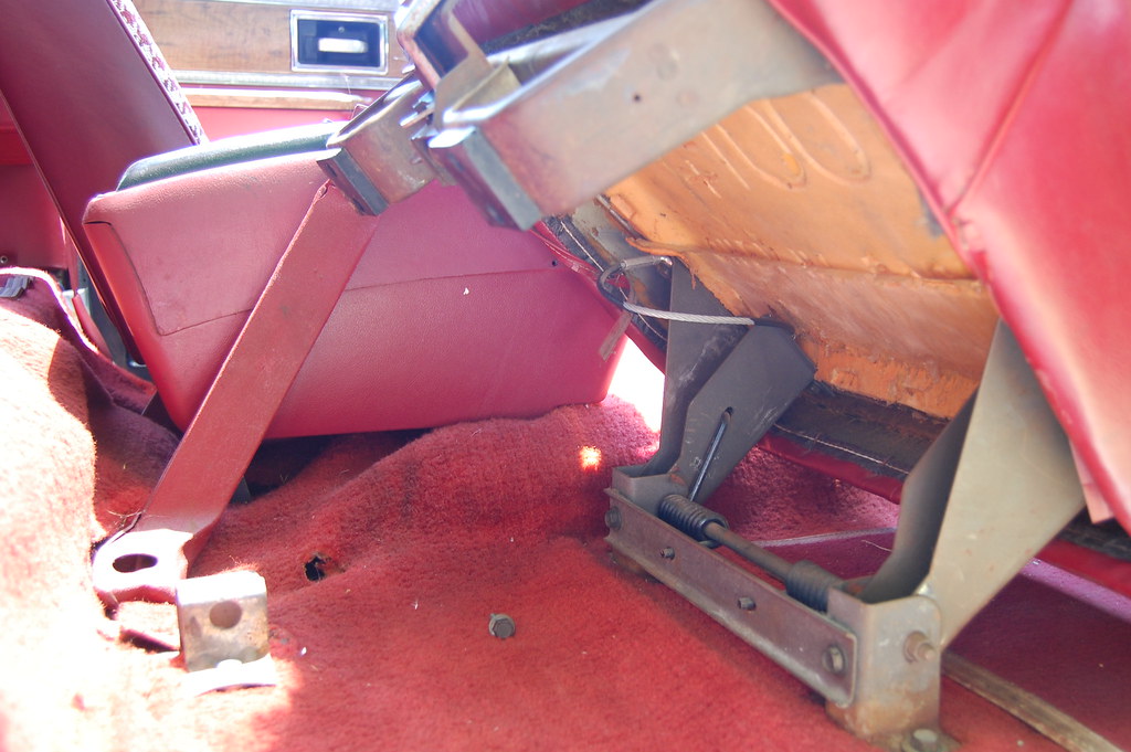

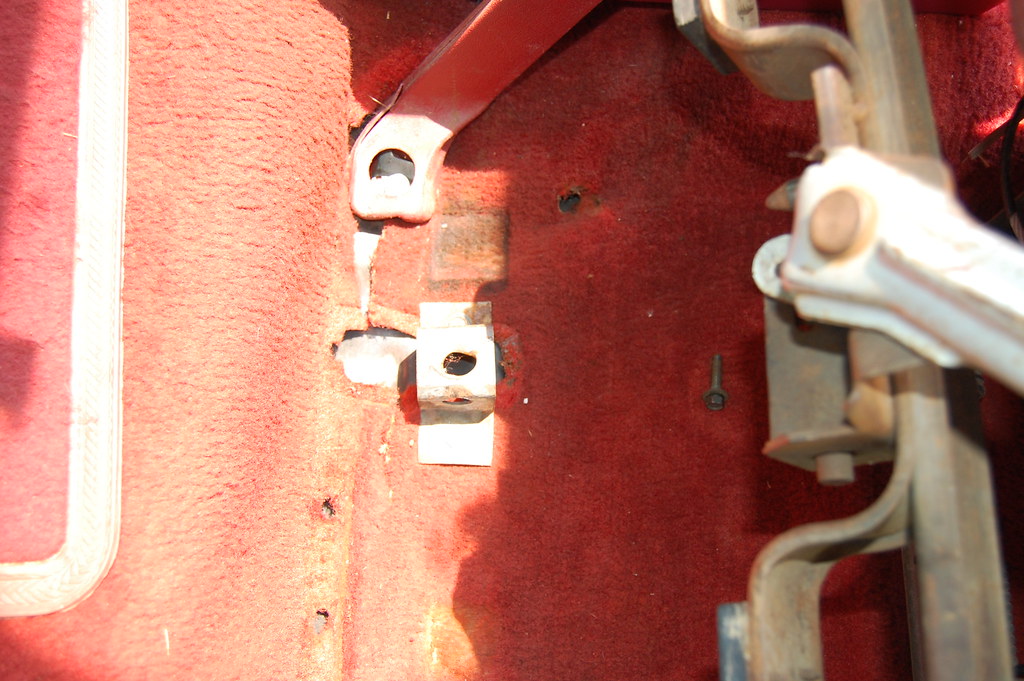

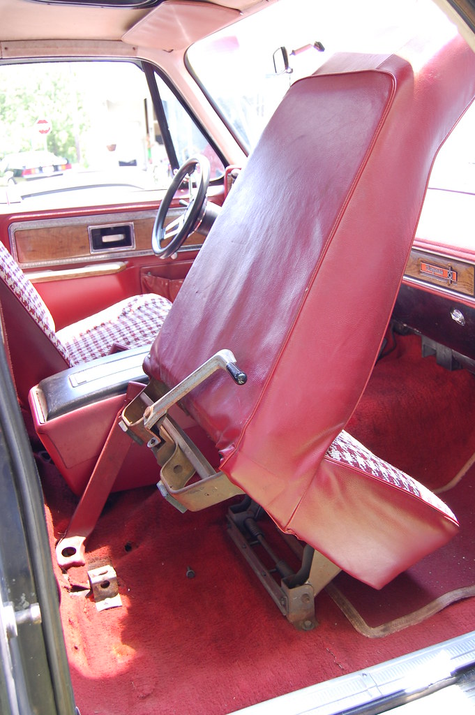

Here's my '77, the carpet is from a newer year so you can see exactly where the hook plate would be on yours.
I have the '78-later seat latch in my storage unit if you need a pic of it.

awesome pictures!
this is something you put together though right?
I like it.
hmmm
The brackets are the original for a '77, the seats and carpet are from an '82. The '82 seats are the same as the '77 high backs (early '77 was still the old low backs), just with different fabric. I used the carpet simply because it came free with the seats.
Here is a pic of an old base I have sitting around. Only tricky part of fabbing one up is the spring return for the lever.
