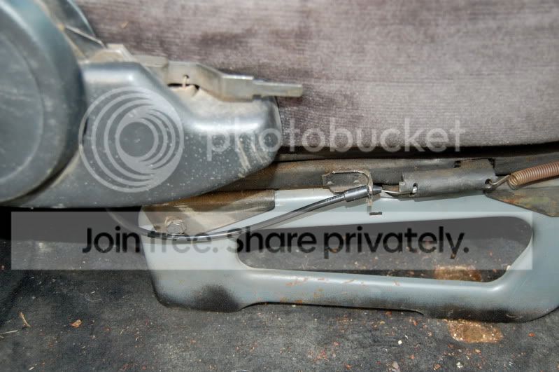

If you grab the seat back, lean it forward (there might be a release button, I don't remember) and the seat bottom does not slide forward, then there is a problem. There is a little cable under the side covers that is probably broken.
I'm assuming you didn't buy yours new?
I found a pic of when I installed the newer setup in my old K5. The plastic cover is off and you can see the cable and where it pulls the release on the lower track.
Well, i'll be damned if there isn't a cable on the passenger side of my seat just like your pic. I removed the lower cover and I can see why mine doesn't slide forward when the back release lever is pulled and the seat back tilted forward. It appears that the cable housing is broken and when the seat back tilts forward it just pushes the whole housing down instead of pushing the button/cable to release the mechanism. Guess I should hit the wrecking yard tomorrow and see if I can find a good cable and fix this. I hate having broken stuff (if I know it's broken that is). Thanks for that last pic. :thumb:
