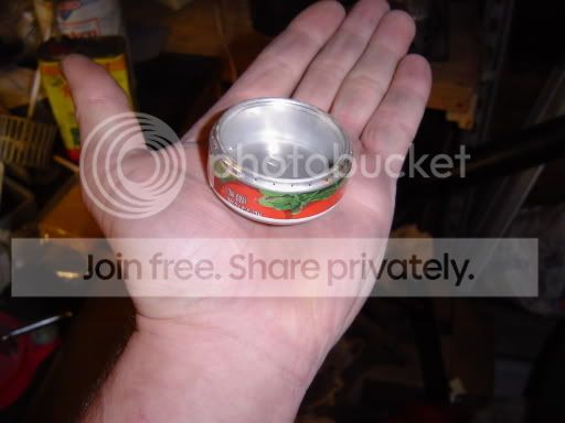

Here's the little guy. I'm going to make another with the little cans, but I'll make it twice as tall so it'll hold more fuel.

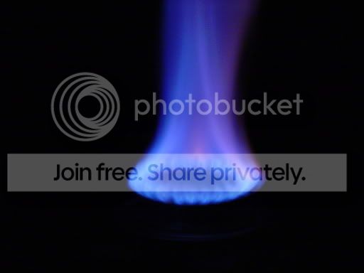

This is what it looks like burning. I had to turn the lights off to see the flame, alcohol burns nearly invisible.
