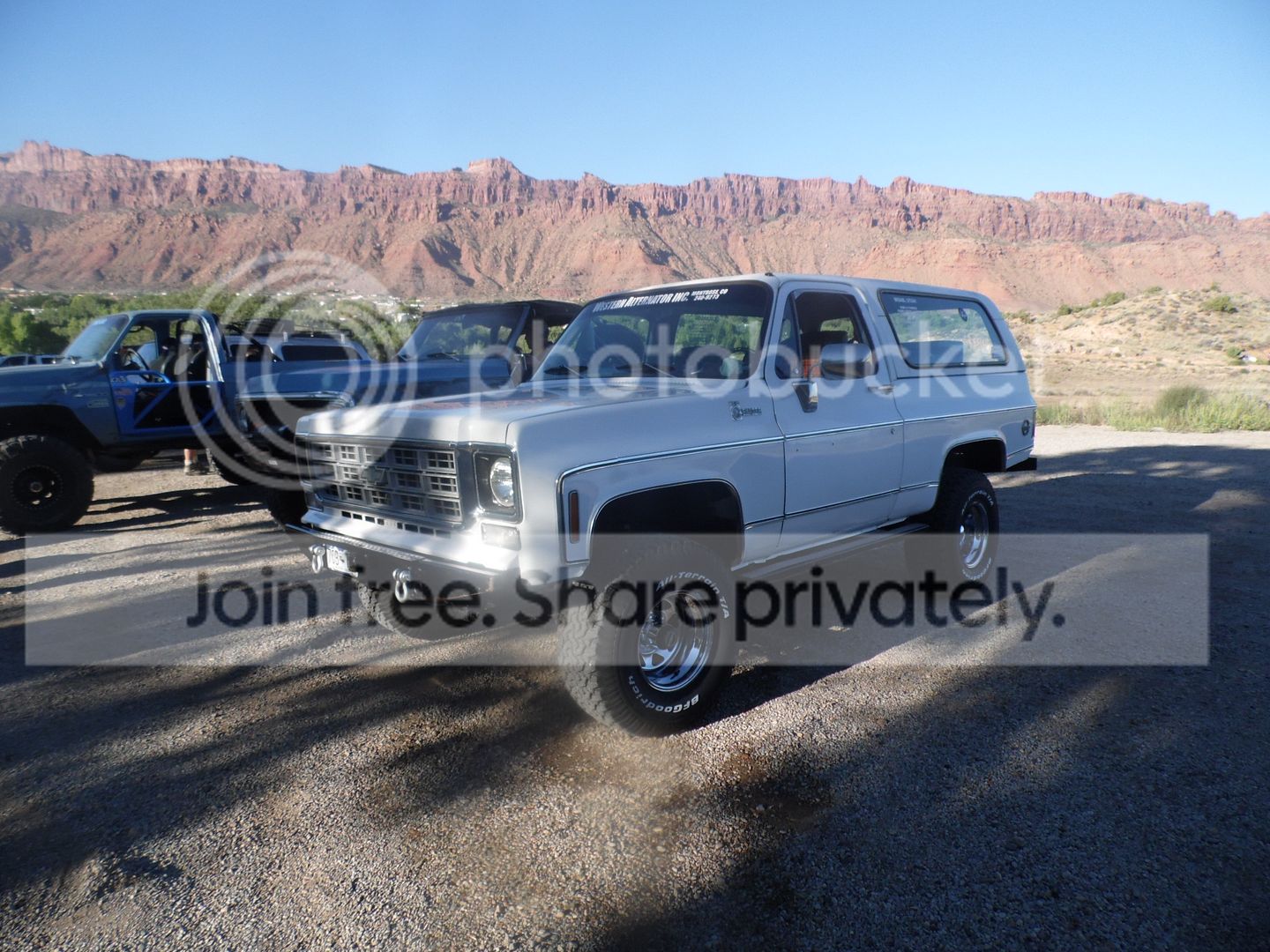

Does anyone know about this rig? I think his name was Jack. This thing walked up Hell's Gate without breaking a sweat.
That white one is Pat. @500$k5
He has done poison spider and LOTS of others!
He has a list on the side windows of trails that he has had it on.
It ran for several years in different stages.
It has been locked in both ends for 5? years.
Detroit in the rear now, drop in locker up front.
I rode with him on the "trifecta" in BB12.
Pat has a lot of experience wheeling and spotting, which helps.
He keeps it low due to daily driving it a lot, the ride, and his ankle.
We ran Kane Creek last year, and I believe that it was the first time that we had to use human power to keep it from scratching the quarter panel by the back window!
