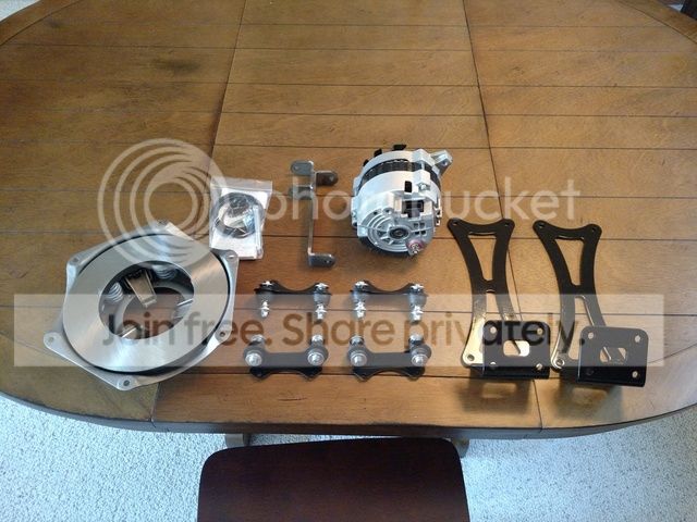

Rebuilt 8.5" pressure plate assembly(.5" larger than stock to better hold all that power), 100amp alternator kit, and rubber and spring isolated powdercoated dual compressor mounts.

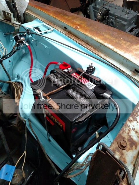

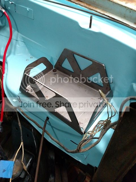

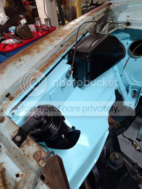

Been picking away at a few items in the engine bay. I cut down a ruff stuff battery tray and bolted it in, replaced the battery leads and starter relay, cleaned and painted the horn, hood prop rod, and irreplaceable fiberglass heater core shroud. On the hood rod I also slid two rubber grommets onto it so to isolate it from the inner fender. I also put four rubber washers under the battery tray to protect both surfaces.
I'm really liking the contrast between the black and blue.

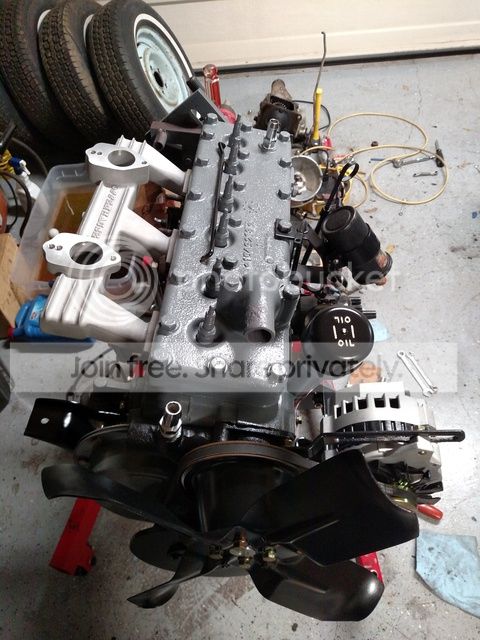

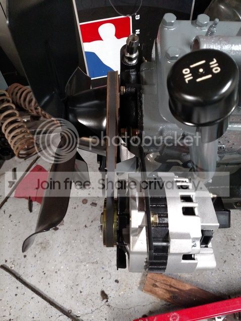

Been plugging away at a few things. The supplied bracket for the alternator conversion didn't line up the belt quite right so I slotted the holes to get it where it needed to be.

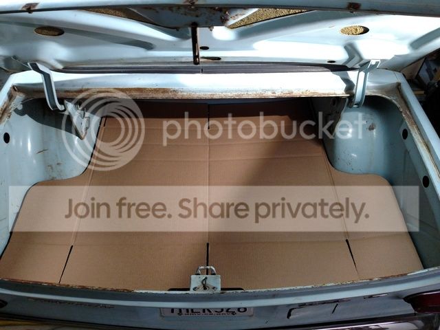

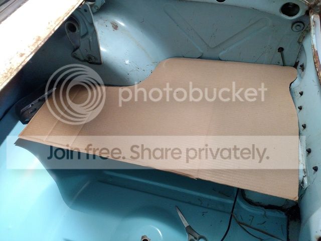

I started working on the rear trailing arms but my 12 year old welding cable decided it didn't want to hold shield gas any longer and started leaking somewhere in the sheathing so while waiting for that to arrive I cut some templates for the trunk subfloor.
I made 3 separate ones then overlaid them together and traced one big template. I still want to have a spare tire so I'm going to hinge the platform somewhere near the end of the wheel wells.
I also scored a never used Offenhauser dual carb intake and linkage from a local guy.
I'm diggin that manifold upgrade, can't wait to see what the carbs and filter setup will look like.

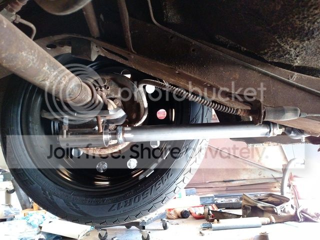

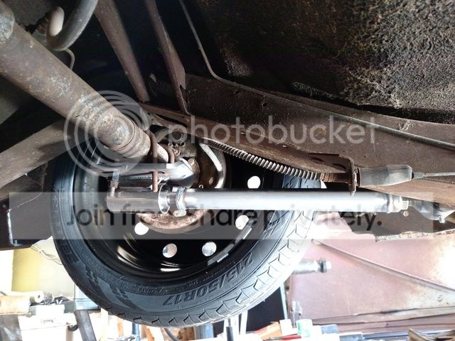

My welder is back up and running so I was able to continue on with some suspension work over the holiday weekend.
The trailing arm links are mocked up and seem like they are going to work well for what I need. I'm going to add more gussets under the plate.
and I have new u bolts on the way.
at full bump
somewhere near ride height
Is that utilizing the existing front leaf spring mount? Looks awesome. This is how I was envisioning bagging my 52 dodge. Do you have a source for the flathead 6 parts? A friend of mine just bought a 53 Studebaker pickup with the big flat 6 (241 I think?) and he's looking for a place to get parts.
Yup it just uses the original front leaf mount simple and effective. I've been getting parts mostly from studebakerparts.com, studebaker-intl.com, and studebakerswest.net but have also grabbed a few things from ebay and craigslist.

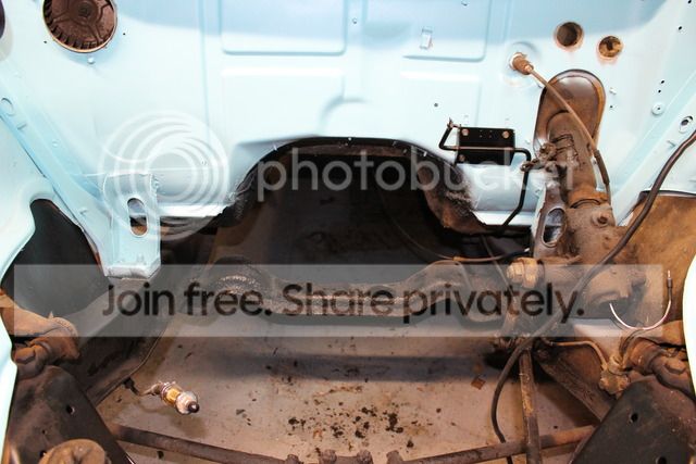

The firewall and tunnel should be fine for the most part I'm thinking, the 259 v8 and automatic were an option on the Lark, dubbed the Lark VIII so it has a fairly substantial tunnel already. I plan on running the 4l60e.

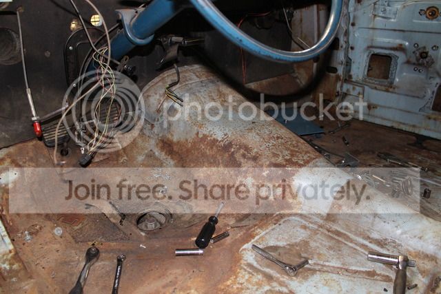

I also pulled the interior and wiring the other night, this thing had 2 main fuses and a 3rd inline for the radio, unbelievably simple.
