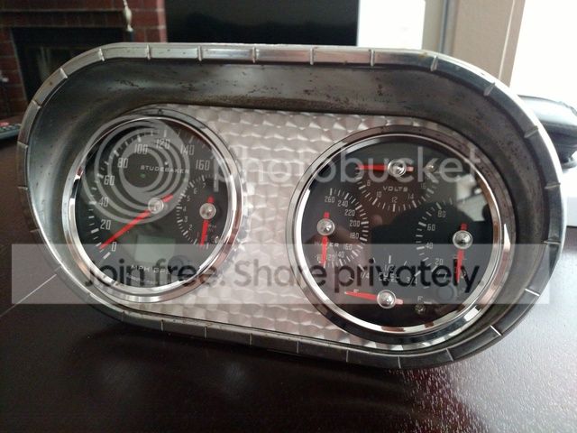

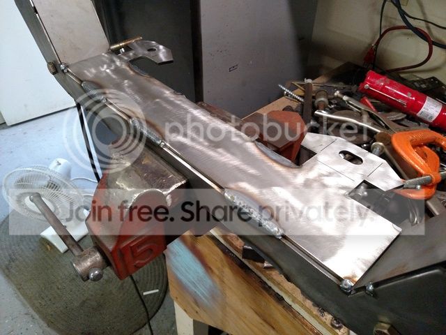

Finished up the trim plate today and it came out great.

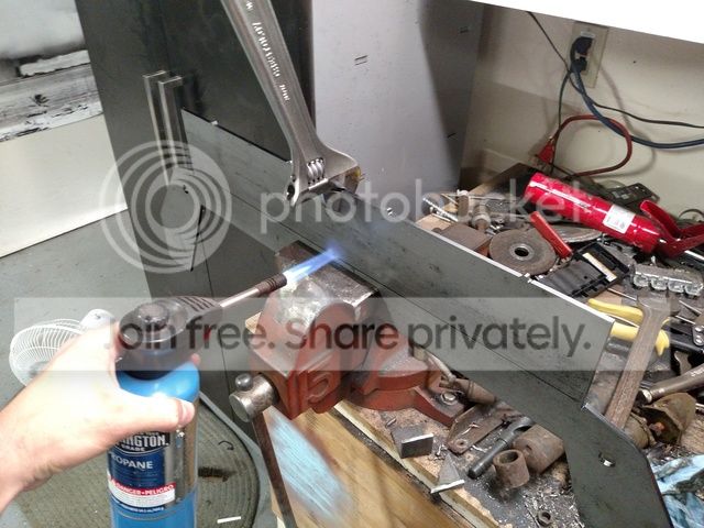

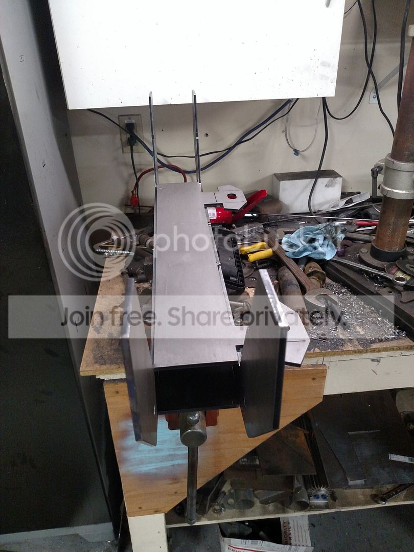

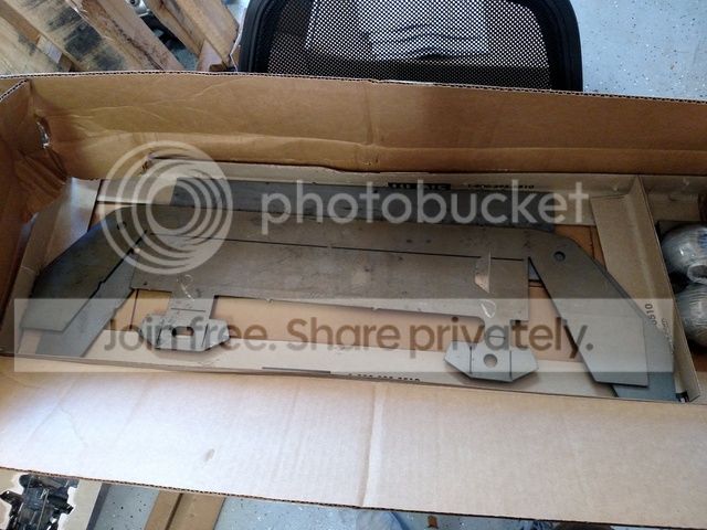

Here's the crossmember in all it's flat glory. It's all 3/16 plate bend and weld style from Paul Horton's welder series. For the budget minded builder it's a nice piece and keyed together very tightly without any tweaking.

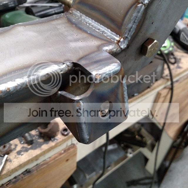

I warmed up the tabs a little before bending as to prevent them from tearing.

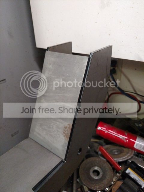

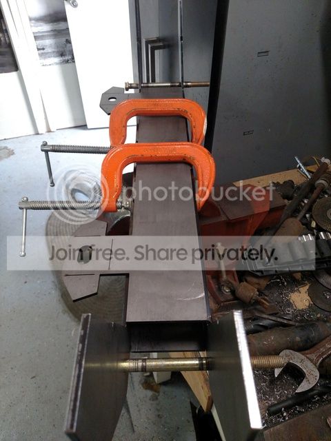

Boxing plates.
Bolts slid through to keep everything true. I still need to clean it up before welding but just wanted to get a little start on it.

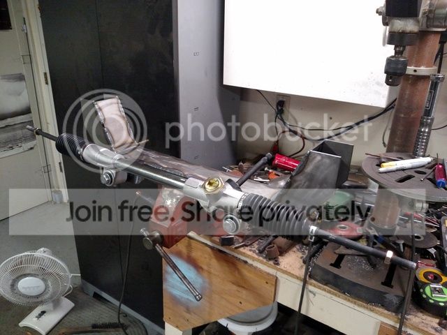

I just realized I bent the piece with the rack mounts the wrong way you can see in the first photo it's labeled for passenger and driver but I have it so the slotted passenger hole is on the driver side, so I'll have to break that top plate off and flip it around. Dangit.:doah:

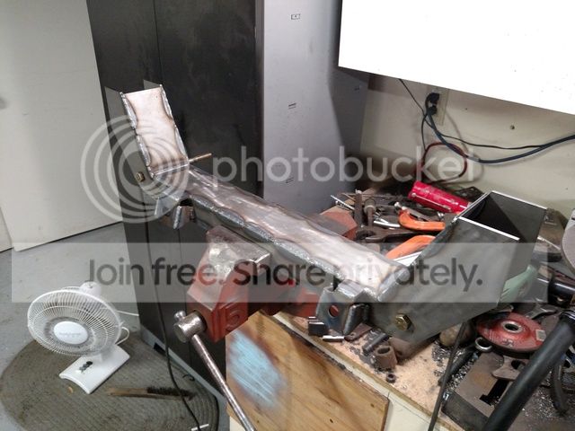

Welded up the crossmember last night and I'm very happy with the results, I alternated sections and let it cool awhile after each section as to not overheat the entire piece. I kept the two half inch bolts in the lower control arm holes throughout the process and they still slide freely in and out so I'm pretty confident it didn't warp.

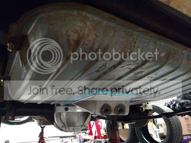

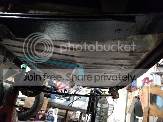

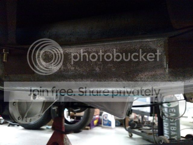

Started mocking up the sump I'm going to add to the original tank. It's 3" deep but won't hang any lower than the center of the frame.
I'll probably end up moving it a little closer to the front of the tank to get the best departure angle.

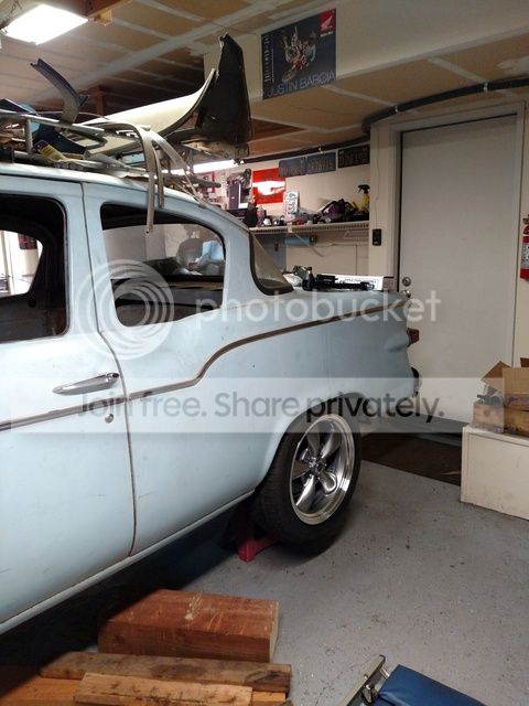

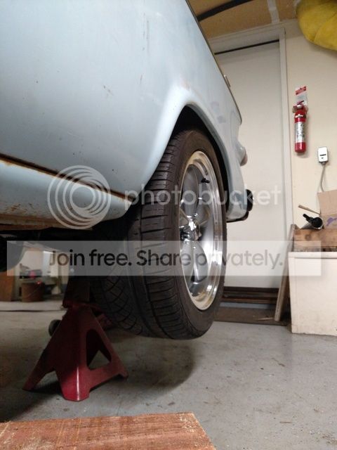

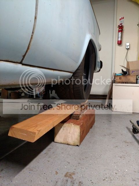

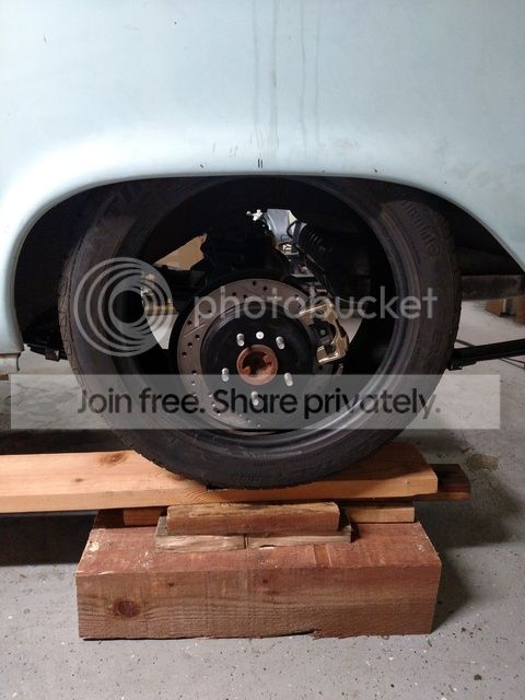

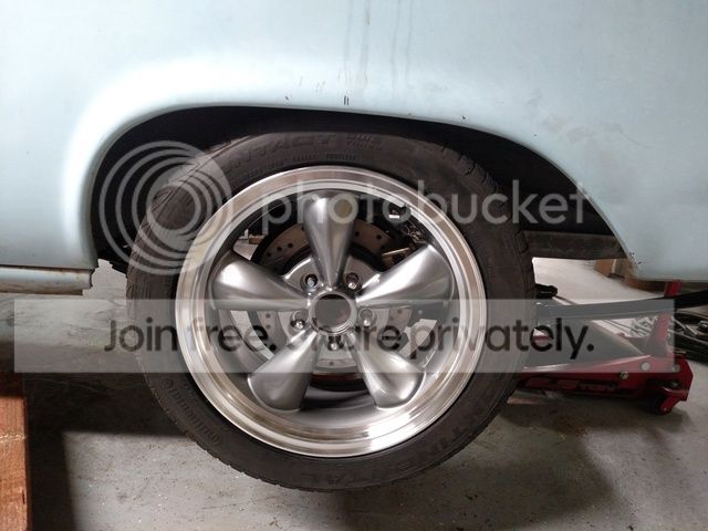

Also mocked up the potential ride height at about 6.5"

Thats crazy, when its time to pick up the next project guess I'll have to come out to the west coast. Do you think you could fit anything bigger then a 245 out back?
Not without a narrower rearend or some tubbing and high offset wheels the low fender line almost like a built in skirt makes it hard to fit anything wide without other modifications.
Thats not that bad, as long as the frame rails wouldnt have to be pinched. Honestly dont need alot of tire with sub 3k curb weight.

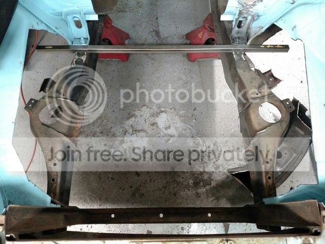

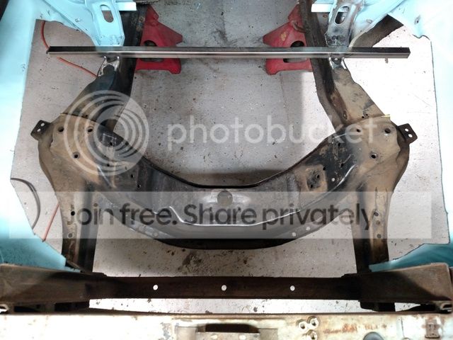

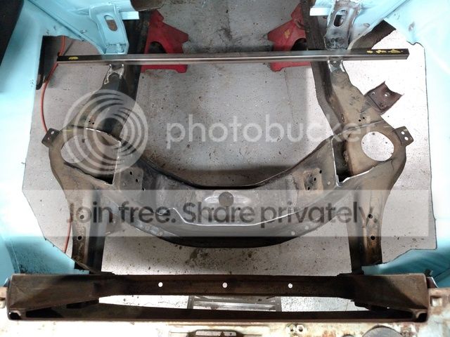

Made the big cut last night and removed the factory crossmember after some careful final axle centerline measurements. I have to say I have some cool neighbors as I was laying into this thing for a good 10-15 minutes at about 9pm and nobody said a word about it. Before, when I was still doing most of my work at my parents house if I so simply as clanked a ratchet against metal she'd start bitching about noise.
I tacked that piece of square tubing on the frame just in case, the front is still held by the core support.
