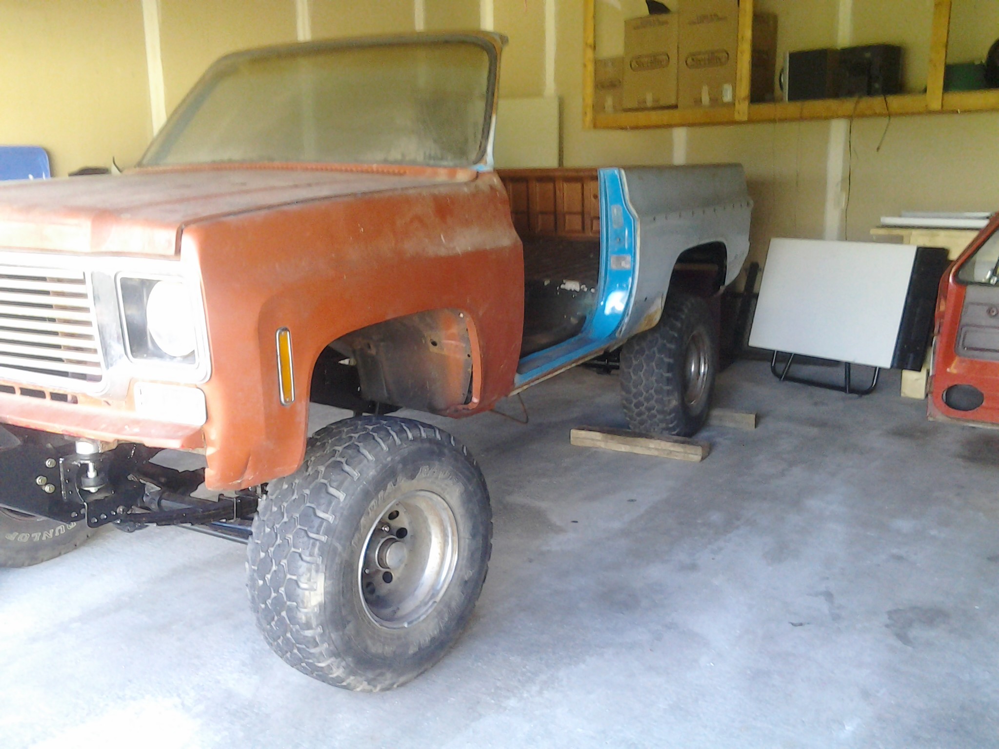

Well had a busy week last week. We moved from La Crosse to Oregon WI. The downside is going to be a little while until I can get much work done on the K5 but the bright side is I get a bigger garage!
I put my front clip on to make moving everything a little easier. I was surprised of how well it lined up, its not perfect but works for moving. It's only held up by the front body mounts and two fender bolts.

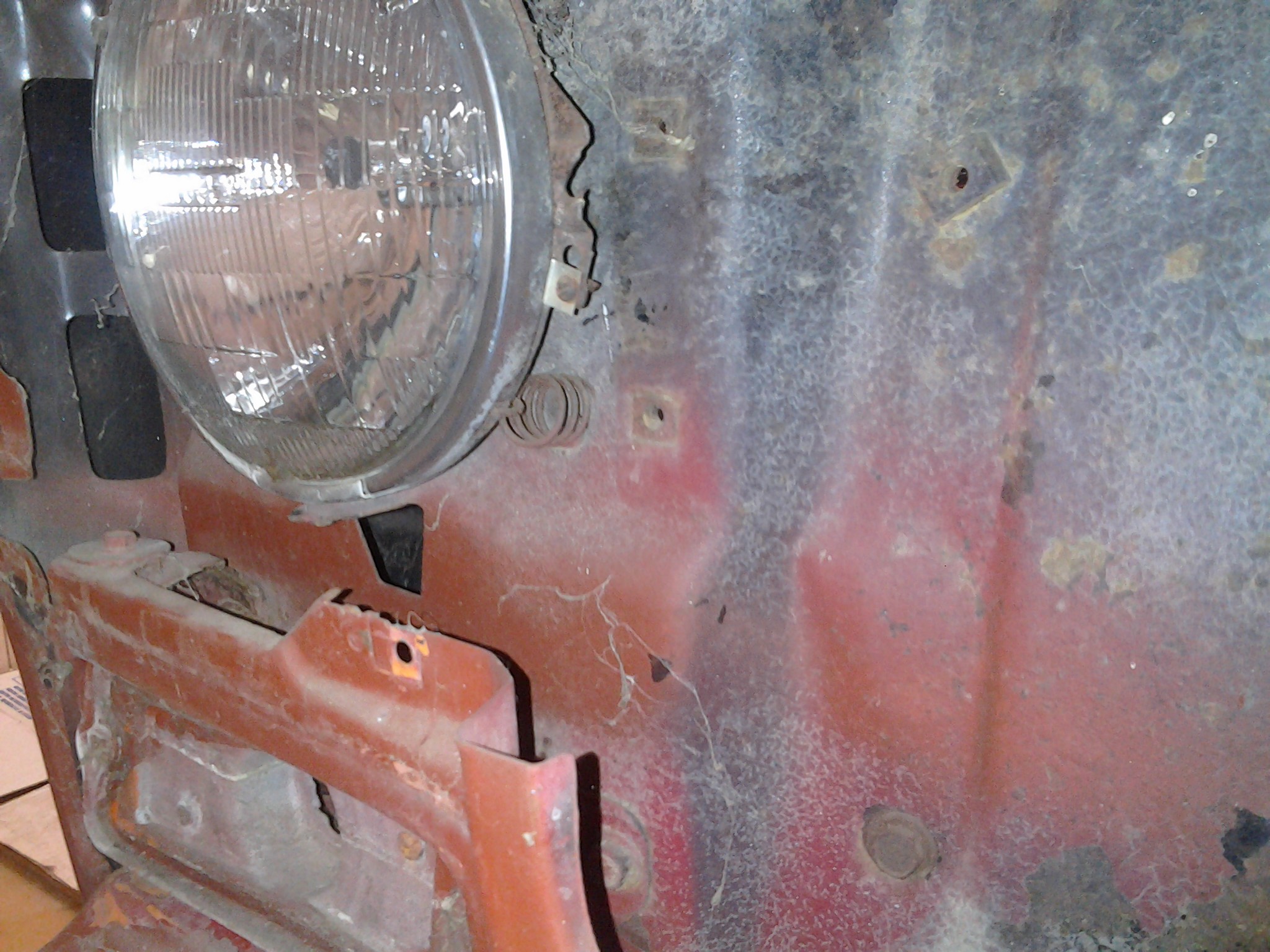

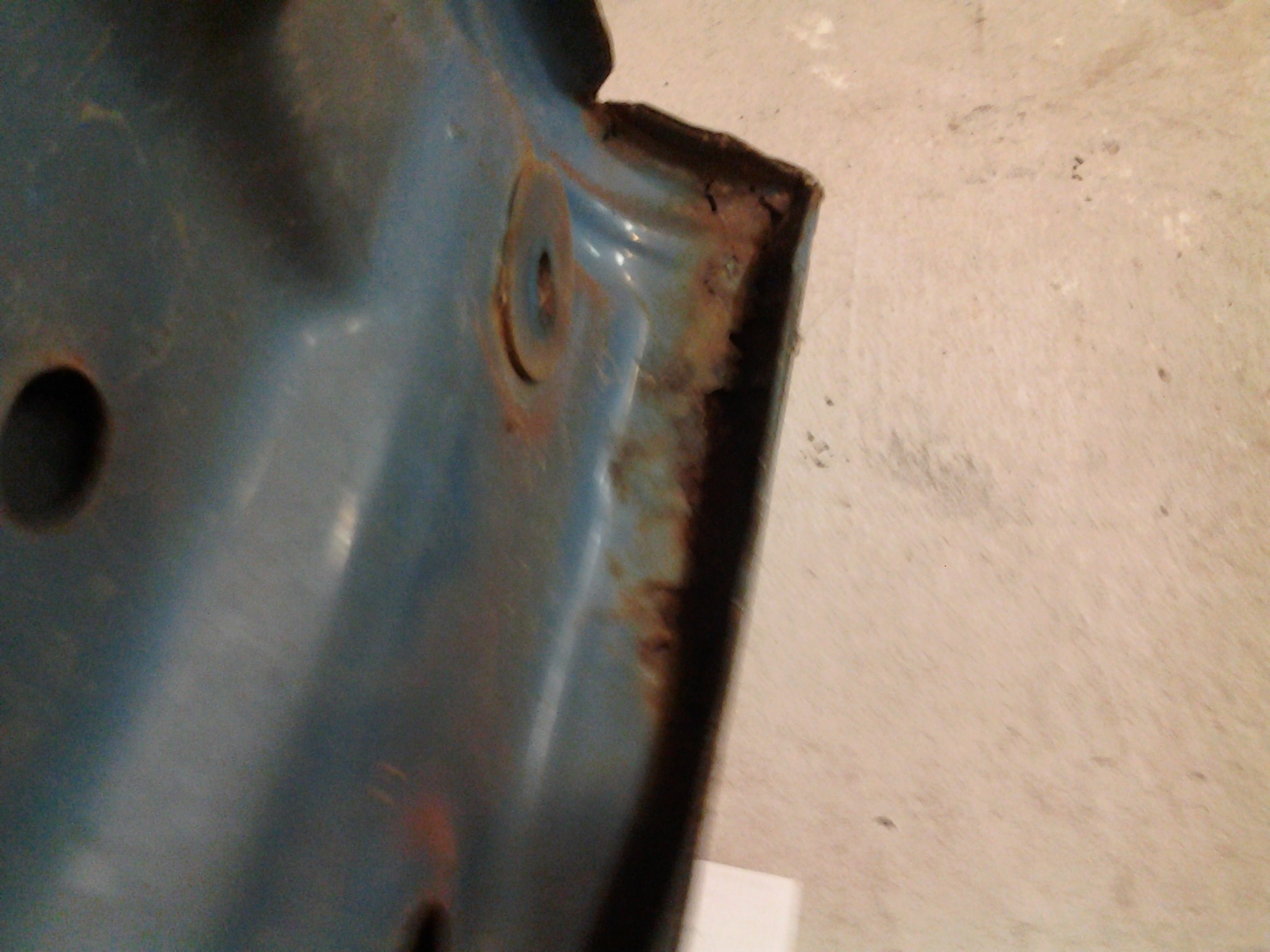

Started disassembling my "rust free" "1977" front clip. After a little further inspection I found some cancer on the inside lips on the front of the hood and it looks to be some more on the inside of the core support. The core support seems to be from a 1973-74 truck based on the bolt holes with captured nuts by the headlights and the curved center mount. So the front clip turned out to not be 100% rust free or from 1977 (year doesn't bother me) but for $100 cant complain too much. The fenders and inner fenders seem to be solid so far. I will have to look more into the rust to see if it something to be fixed or to be replaced. I'm going to ditch the aftermarket bar grille for a more nostalgic look of the 73-74 sunken grille.

Truck looks great so far. In your picture you have labeled as the grill bolt holes those look more like the bolt holes for the battery tray hanger to me. I'm on my phone, though, so I might have missed which ones you meant.
Thank you! They look to be in the same position as the the brackets I removed for the 73-74 grille at the junkyard. They could also do the work of holding the battery tray. I could be wrong though. Ill check it out tonight.
From this article it looks like they are mount holes: http://www.fourwheeler.com/how-to/1973-1980-chevy-square-front-clip-grille-swap/
