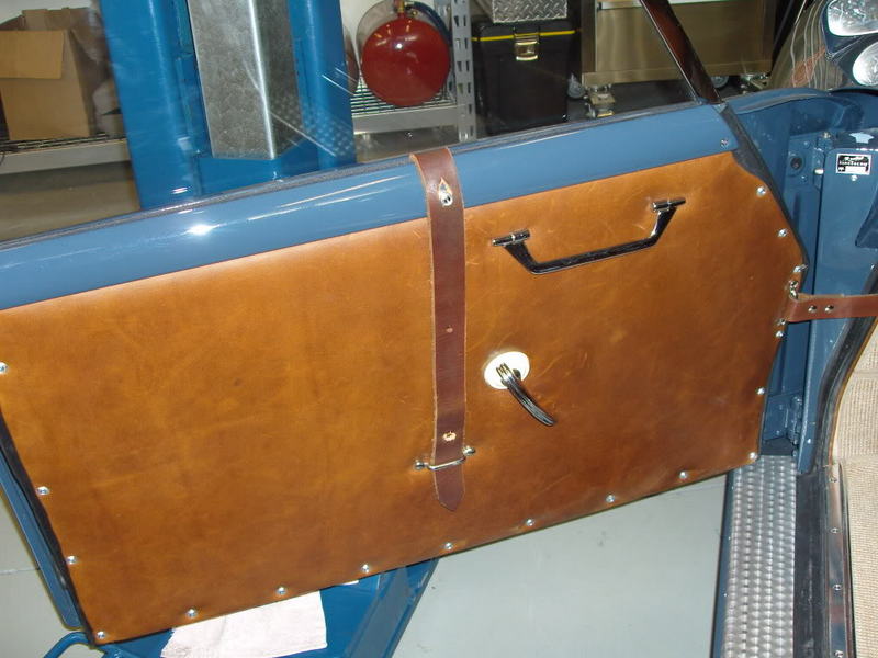

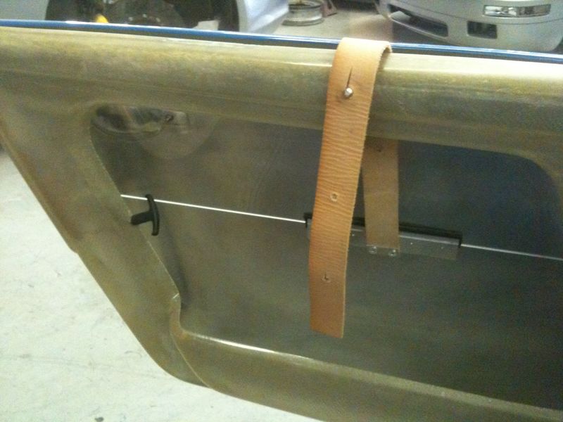

As long as the tracks are in there, I've seen lightweight cars use a strap affixed to the bottom of the window and the strap is run up and out the top of the door skin. The other end of the strap attached to the door to hold the window up. Cheap and easy.
ah. I misunderstood. Yeah, that will probably work for now.
That's how school buses used to be back home in the 70's
