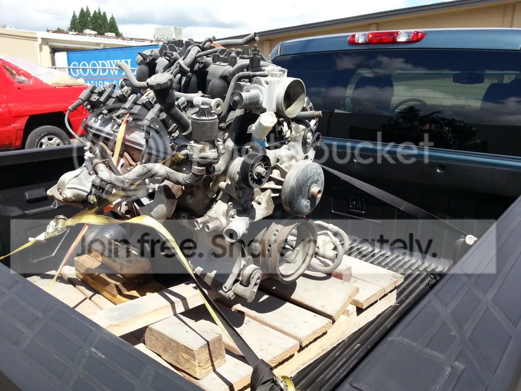

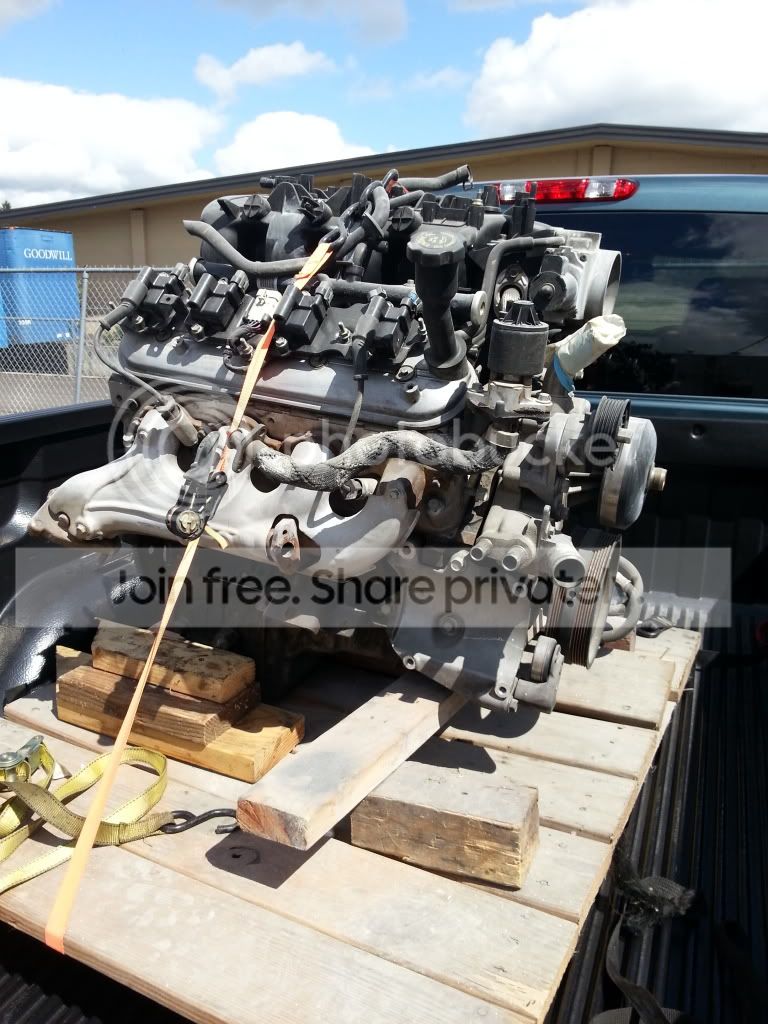

My buddy and I are going to put a 02 6.0 out of a GMC Denali in his 91 suburban! Going to pick the motor up for him tomorrow before work. :woot: Pics of the truck and motor asap!

And here is the only pic so far of the motor.
