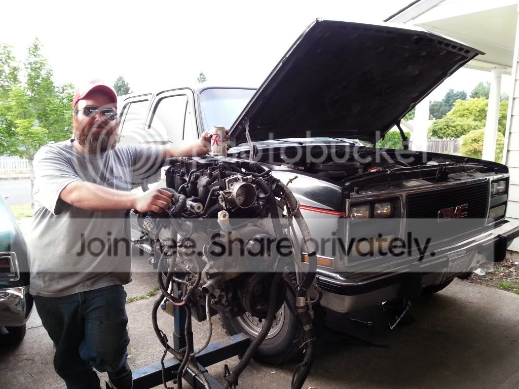

Scott and I went and picked up a harness and cable operated throttle body today.

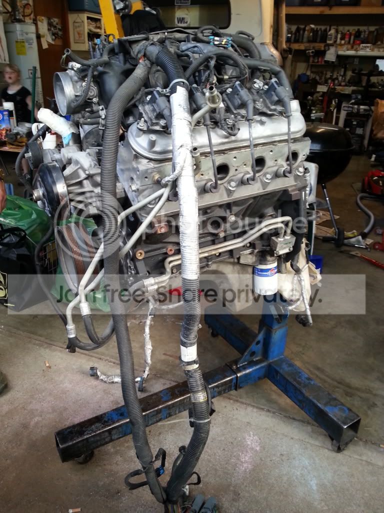

The harness plugged into the motor just for fun.

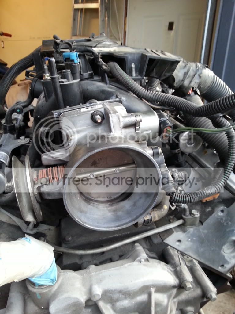

The throttle body.
Scott very happy with today's purchases.
Harness is from a dude on cl sellinga bunch of ls parts. Its stock and needs reworked to be standalone. His beard is pretty epic! I forgot to mmention that he has some f body manifolds and a truck power steering pump/bracket on the way. After he gets paid again next week the ordering frenzy will begin. We think the swap will start the weekend after the 4th of July.

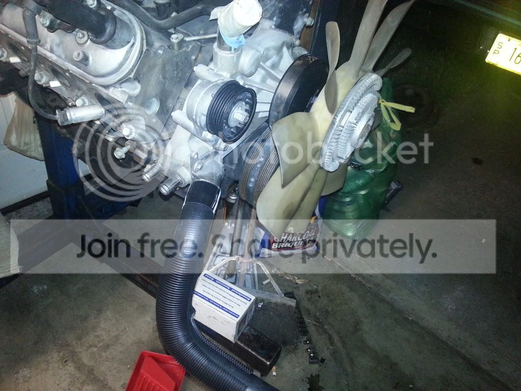

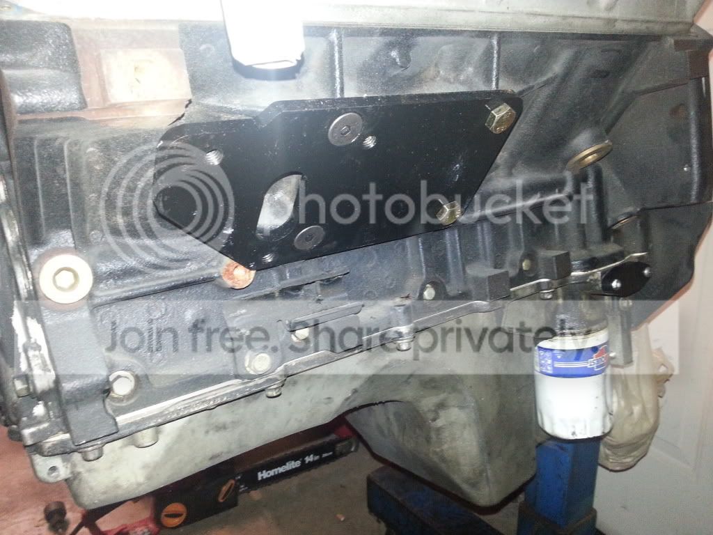

Scott exercised his credit card a little this weekend. Ordered so far is the f body manifolds, power steering pump and bracket, lower rad hose, cooling fan, motor mounts, flex plate, spacer, bolts, and fuel pump. Planning on starting the swap in July!

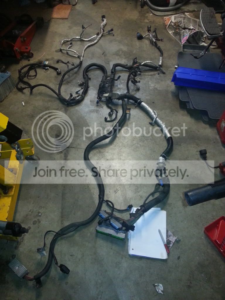

That last pic is the one that keeps me away from this swap...Lol! I'm scerd a them wares
Its a little nerve wracking at first. If you wanted the pay the couple hundred bucks to have someone else rework the harness, it would makeit all plug and plan and would take all the scary out.
Speaking of the wiring, Here is the info we are using as a guide as well as some hlep from various other web sites. Its all about research!
How to build a stand alone harness,

Cool view. I'd like to see how they wire it in the truck...
I assume you have to retune the puter after removing all those wires
Yep. There is a guy on ebay doing a really cool deal. He sells you a tuned ECM for $120. So rather than you having to source one and then ship it out, its a one stop shop deal. The wiring into the truck is kinda the easy part. Depending on what year your truck is, how you wan the instal to turn out, and how much research you have done ahead of time! An instal into your truck, if you already had a reworked harness, would take all of 30 minutes. A LS swap into YOUR truck, is literally as easy as a motor swap. Except you have to add a fuel pump.
