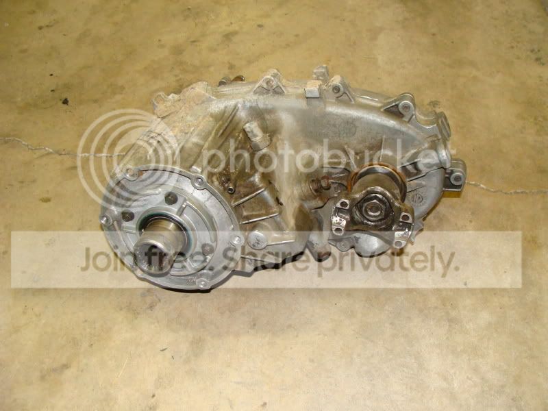

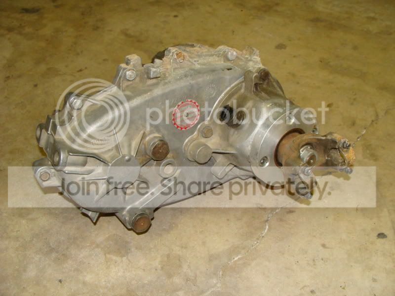

I just scored this sweet deal tonight! NP241C case with slip yoke Eliminator kit. Got it for $150:D Only downfall is having to swap it out to my pass drop case, but for the money, It's worth it!

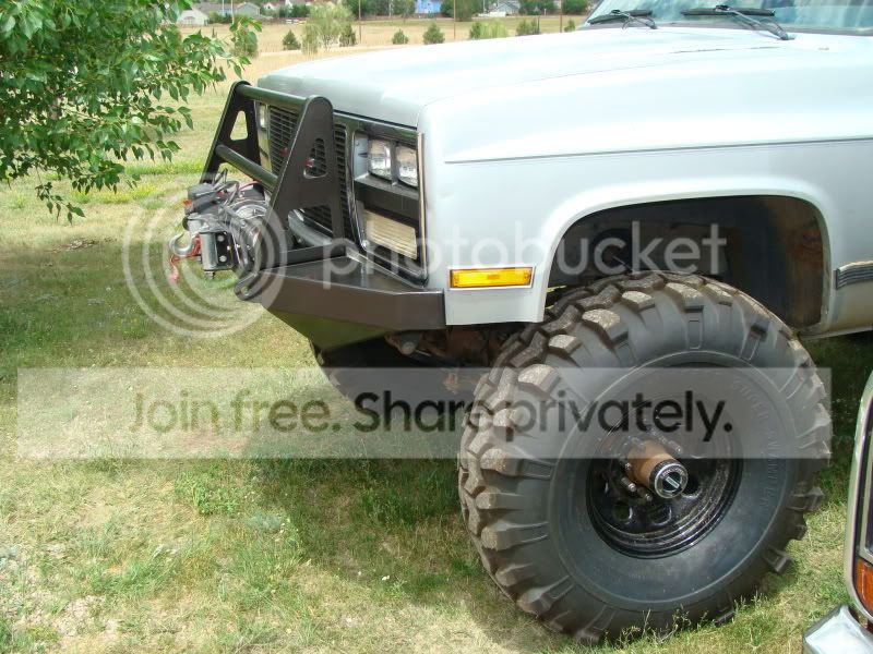

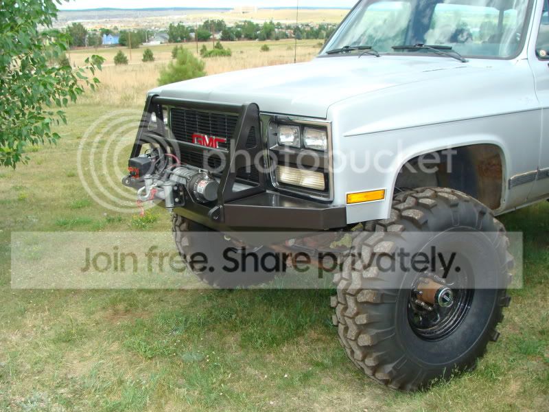

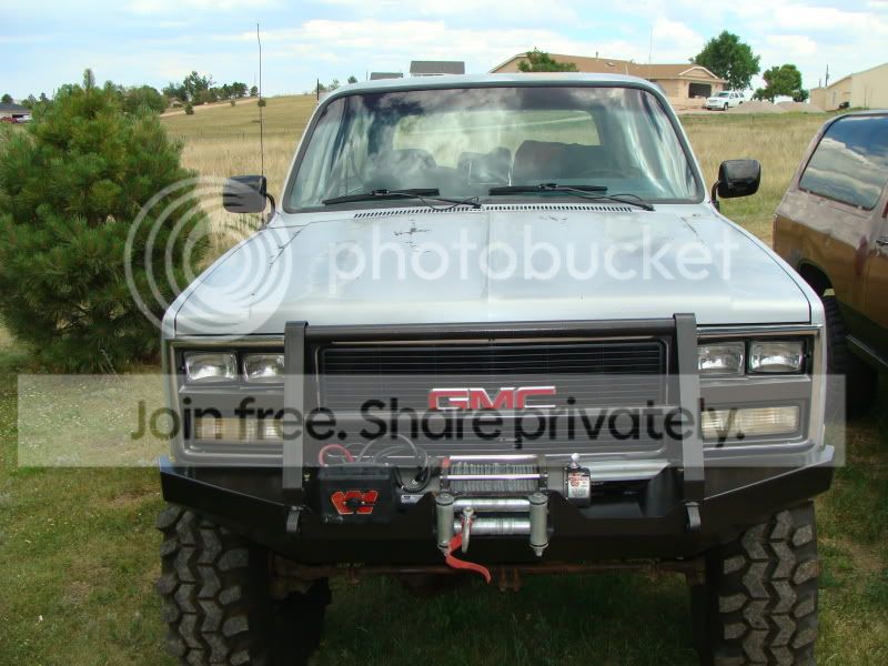

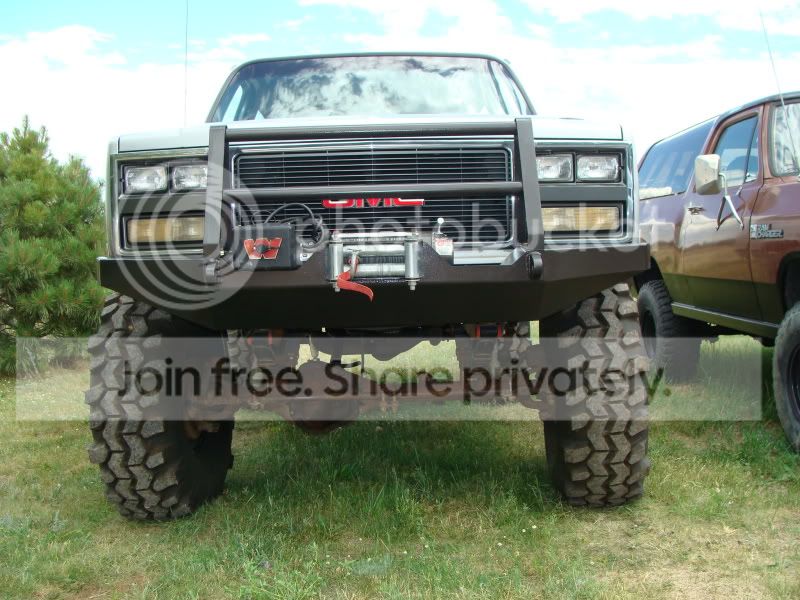

Hefty Fabworks just finished up my front bumper. Got the XD9000 mounted. Only thing left to mount are the lights and control box. I'm very satisfied.
Although I won't be going too off road on mine, I've had a few bumpers fabbed in the past, that looks awesome. The lines on that bumper make the front end look like it belongs. Nice job.

DAMN! Sweet bumpers! Id like to see the back. Gotta add the "D" rings! :bow:
Take measurements so I can make one for myself! J/K (But if you want to, feel free! HA HA!)

D rings are on the front now.. They're included with all his bumper sales. He was in vaca last week. I'm pretty sure He'll be finishing the rear this week if He has no other priority jobs in line.
Damn, that is a fine looking bumper!
