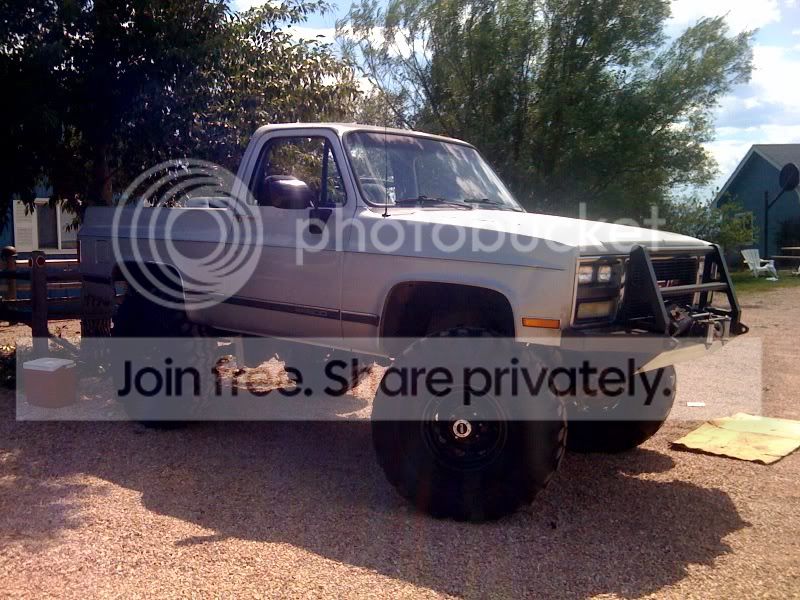

D rings are on the front now.. They're included with all his bumper sales. He was in vaca last week. I'm pretty sure He'll be finishing the rear this week if He has no other priority jobs in line.
Just to clarify.....He was talking about the d-ring shackles. The clevis or shackle mounts are included standard on all of our winch bumpers front and back. D-rings cost $15 each and are not included.

Awesome, thanks for stepping up and welcome to CK5. That bumper looks very sturdy and well built!
