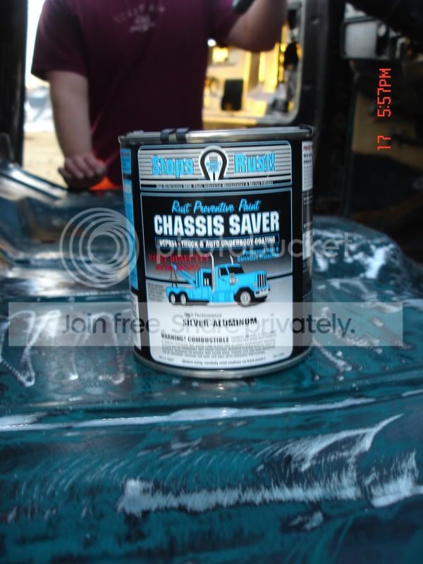

Ive used both rust bullet and por15... heres a little secret... there's something better than both of them. Its called chassis saver from a company called magnetic paints. http://www.magnetpaints.com/
I've used it on the frame of my truck as well as a rusted out radiator core and its amazing. Also, it is WAY CHEAPER! maybe $35/quart

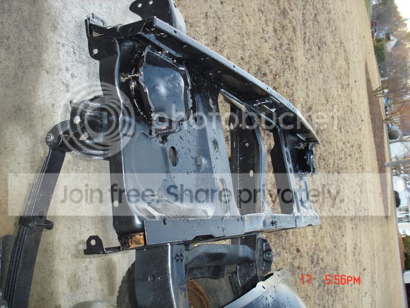

I put the chassis saver on with a foam brush. The stuff coats so well you never see the brush strokes. That radiator support in the pic was brushed on and you'd swear it was sprayed. You dont waste so much brushing either.

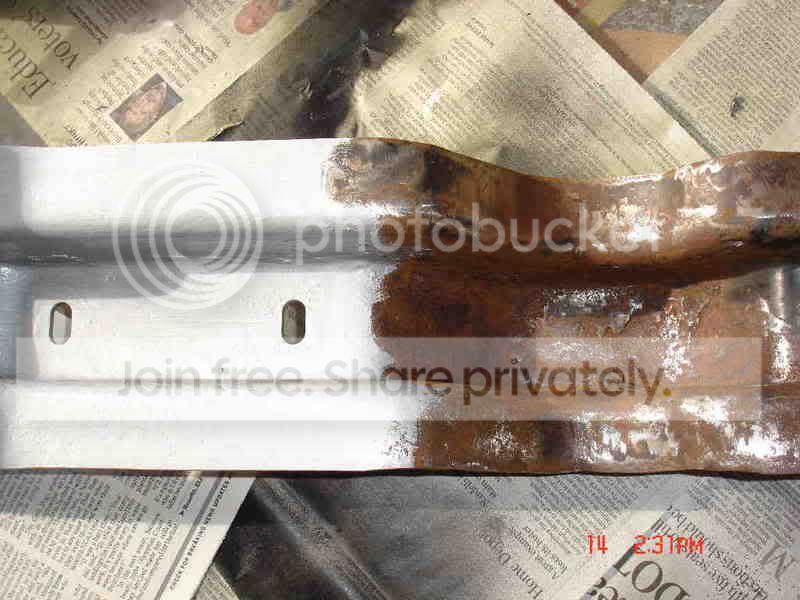

I might have a pic of the inner fenders I did with the chassis saver, I'll check tonight. They look better than brand new right now. They were all rusty, I scuffed up the surface and foam brush painted them. the chassis saver fills all the pors and has a glass smooth finish. If its something thats giong to be in direct sunlight you should topcoat it though as it does fade in direct sunlight, but it never loses its rust proofness. You can paint over some REALLY bad rust too and it will NEVER rust again. I swear by this stuff! its awsome. My frame looked like it needed to go to the scrap yard and I did the whole thing with chassis saver. Its sat outside for 2 NY winters before I moved to GA, and it looks like the day I painted it...
I think they still give away (or a small fee) samples of the chassis saver. Give them a call. They will send you a metal plate half coated in it too and you can see how flexable it is. You can bend the plate in half and the coating doesn't chip. Its a real hard finish too, you'd be surprised.
