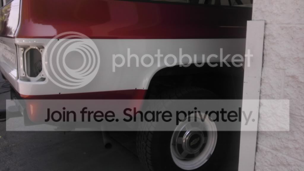

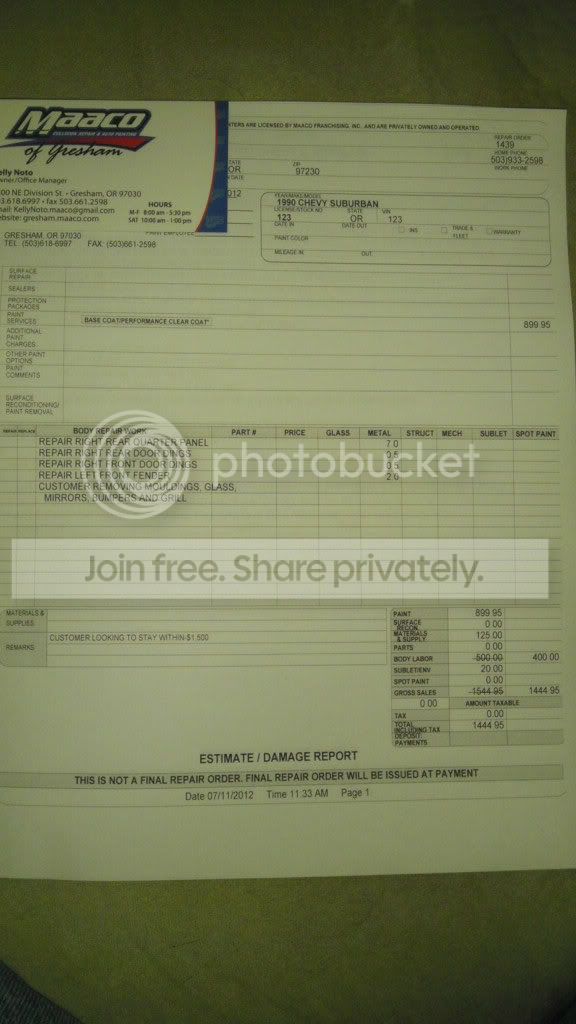

Well I stopped by Macco today. Got an estimate for the burb at $1444. 10 year warrenty. Thats with me doing all i can as far as removing trim, glass, bumpers, etc. I checked out their work and the only thing i didnt like was the orange peel. I know i have seen factory jobs just as bad and i know it was what i would consider"standard amount of orange peel but i dont want any dangit! On the flip side, i know that it is a ton more work to get NO orange peel and i would pay for it big time at a different shop. If i have time tomorrow im going to stop by a couple other reputable shops and get estimates from them. One part of me says, "get the dang $1500 paint job and be happy!" and the other part says, "get the dang $3000 paint job and be happier!"... Oh what to do...
Truck they were working on while i was there.
My quote,

Im pretty much thinking im going to go through with trying out the maaco job. I know i wont be truely happy with it, but opposed to $3k paint job that will take two months to complete, i think i can live with the results. In the grand scheme of things $1500 just isnt that much. Its about 2 weeks pay. I think if it turns out like poo poo, i can chalk it up to two weeks of my life that i wasted at work to pay for a sucky paint job. If it turns out even in the decent range, i would be thrilled with the fact that all it took was showing up to work for a couple weeks to pay for a truck to look decent for the next several years. I KNOW that it will not be flawless and that it wont last all that long(shooting for 5-10 years) but i also know that i have the money right now and it NEEDS paint. At the worst it will look better than it does now. So, with that, I do plan on dropping it off down there in the next 2-3 weeks. I gotta get to work stripping it down. Saving $100 bucks by removing the bumpers, grill, mirrors, glass, etc. So as soon as thats done i'll drop it off and 7-10 days later i will have a truck thats all blue again! So, i guess i will have something to add to this thread before long! Wish me luck!

Whats the cost if you just drive in off the street....no prep/disassemble by you?
I didnt ask and its tough to say. That had figured in my quote 7 hours to fix my big dent in my rear quarter. So maybe about the same price if you had no dents and stuff?
