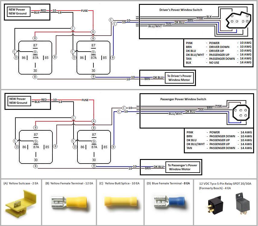

here's a diagram for those interested...
full

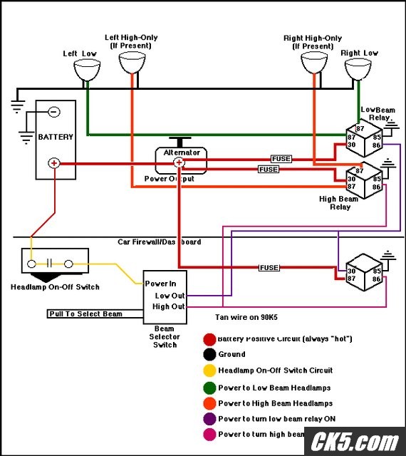

and the headlight mod...
full

Here is an updated/simplified wiring diagram overlayed on a factory power window wiring diagram. The only modification you need to do is run new power and ground wires (one each door, connected to both relays with jumper or splices) for the relays and cut into the two wires per door running in between the motor and factory switch.
That's 2 relays per window, correct?
One for up and one for down
That's correct. Both relays are tying the motor leads to ground until you flip a window switch. Then one side is pulled to +12V. If both directions are selected at the same time (one at each door), both motor leads are tied to +12V, so you are still fine.
If you did this with a normal "polarity reversing" DPDT relay, you would still need a second relay to turn the motor off, so a pair of the more common SPDT relays works well.
I updated the diagram to avoid people vandalizing the door harness and the inevitable failures later on. Use solder sleeves, or solder and heatshrink. Cover the terminals with heatshrink. A relay socket is also a good choice if you use a good one.
