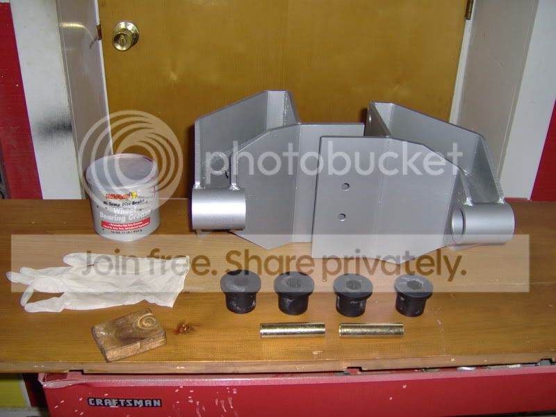

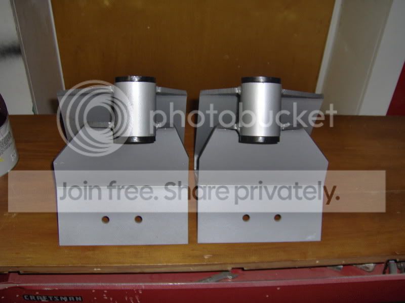

I`ll have to say, this was way easier than I expected. With the bushings sitting in the freezer for about 6 days :D , it allowed for me to slide everything in, with out ease, by hand.:eek1: So ,I took them out, went into the basement, laid every thing out:

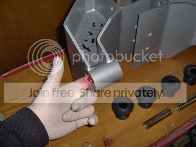

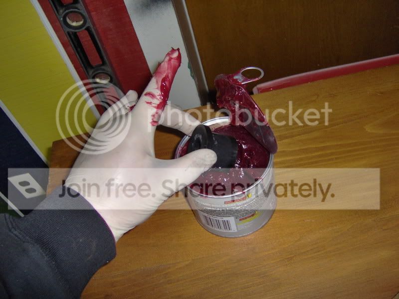

greased up the bushings:

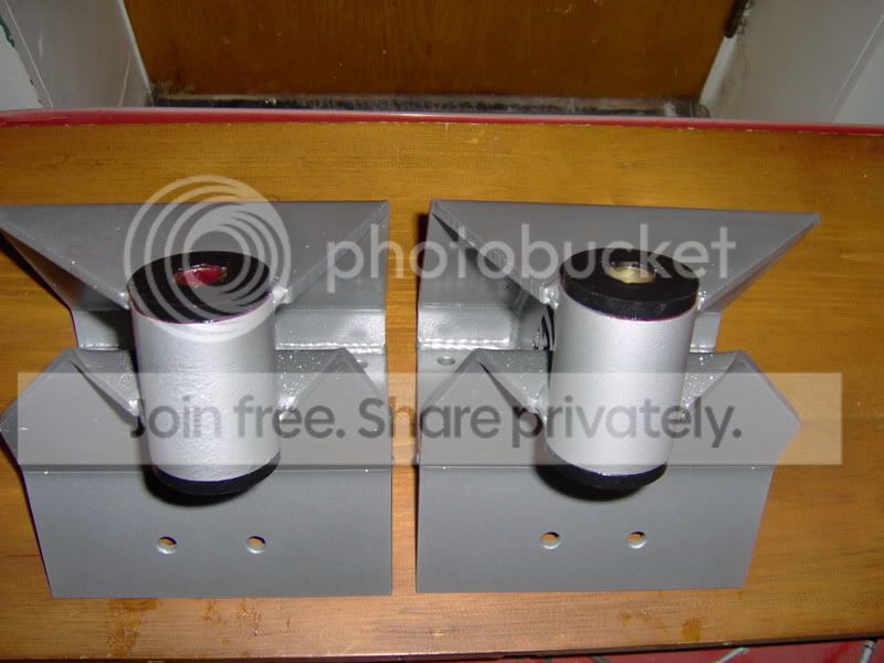

Then they slid in the 2 halves on both flips, and pushed in the sleeves...
Finished product:
