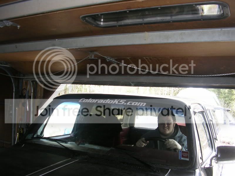

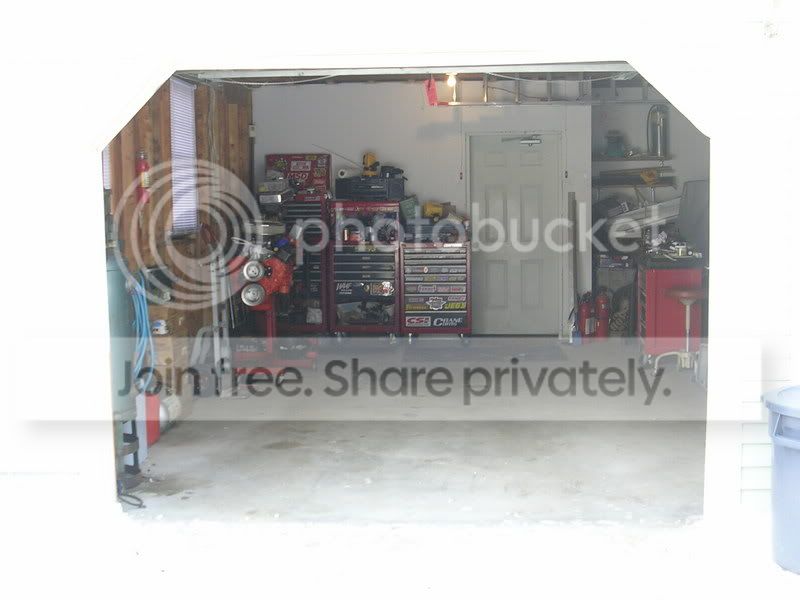

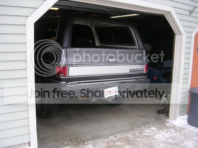

We began by finishing cleaning the space in the garage where my truck would go:
Then we went ahead pulled my truck in, watching the clearance, VERY CLOSELY:D
:eek1::eek1:
:eek1: :eek1: :eek1:
And, we`re in!

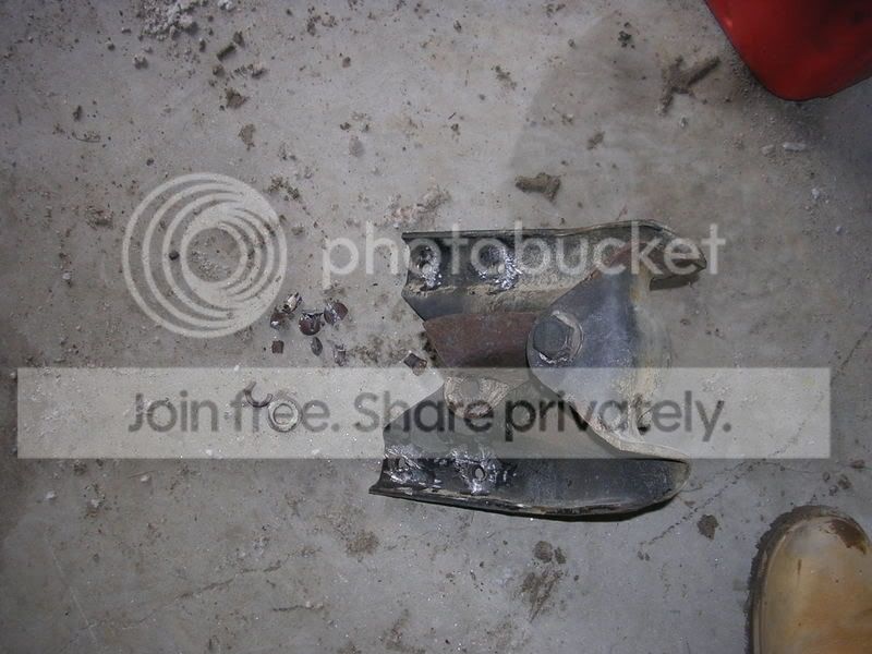

The breaker bar or impact wrench WOULD NOT budge these bolts, so a little :hack: was needed.
PS:
DS:

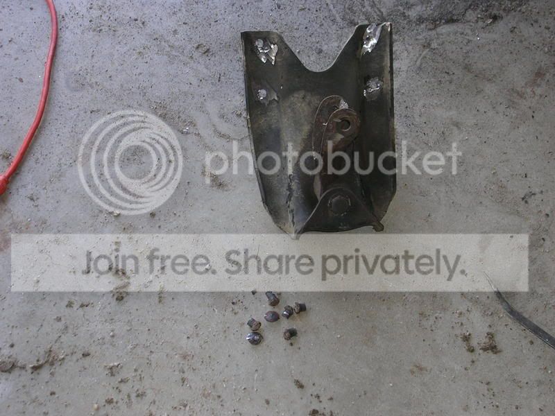

As you can see in that last pic, after alot of :grind: :grind: and some abuse from the air chisel, those PIA hangers were out.
PS:
DS:

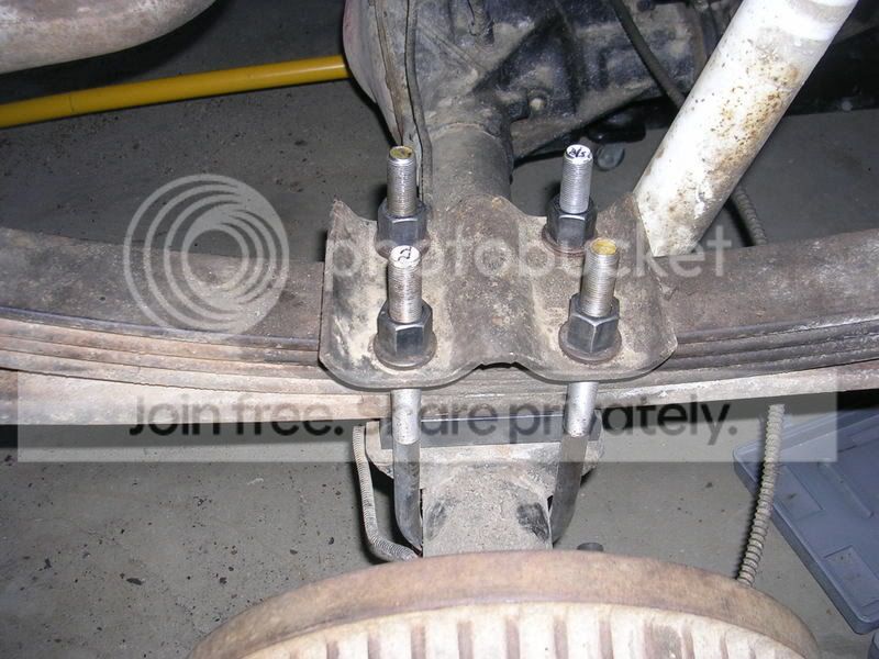

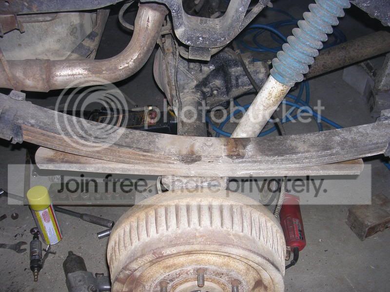

Then, with some :grind: :grind: the U-Bolts and lift blocks were out.
PS:
DS:

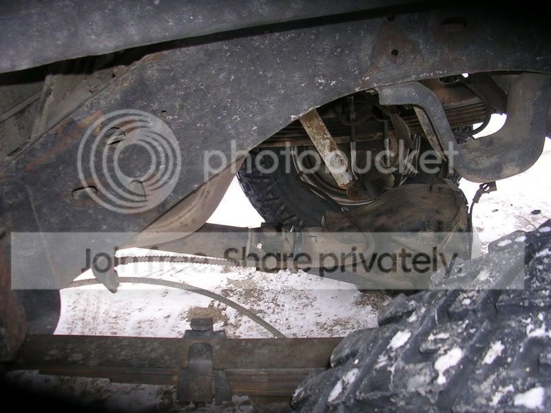

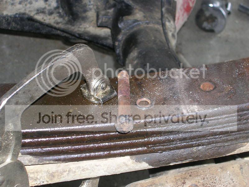

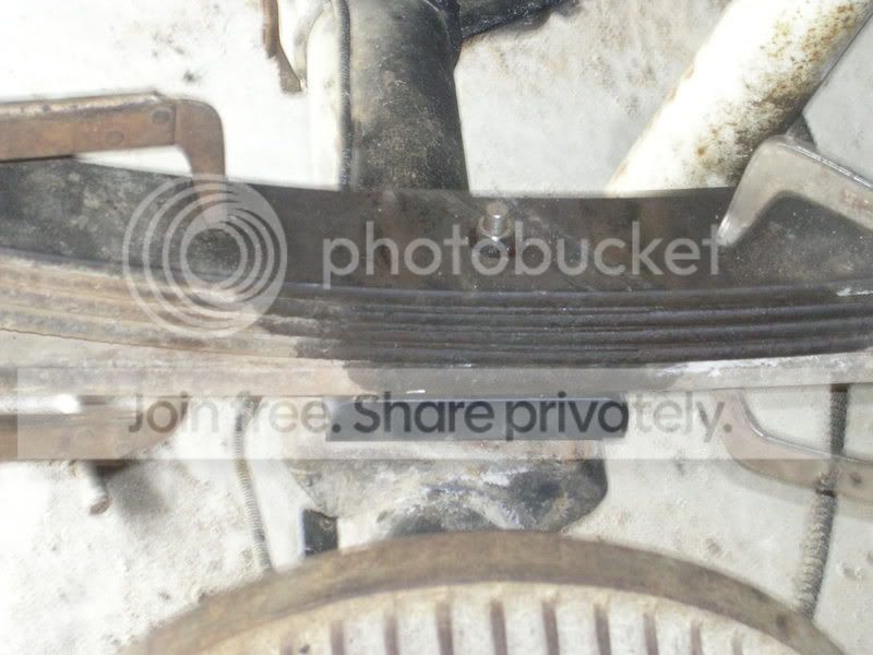

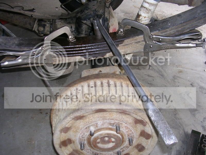

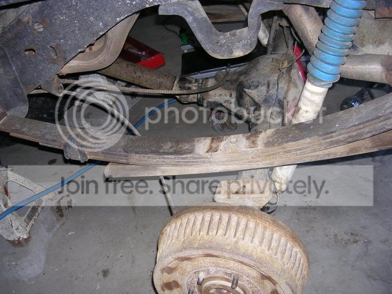

Placing two "C" clamps on both springs to hold the pack together, I "tried' using vice grips and a breaker bar to break these center pins loose.
But, NOOOOO, they didn`t want to work like that :rolleyes:, so a little :hack: :hack: was necessary. (both sides are similar)
PS with zero rate and new center pin:
DS:
Goodies:

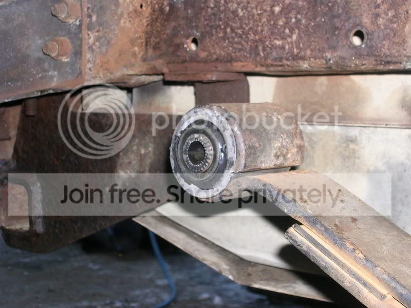

Since the bushings in the rear of the springs were junk, the had to be replaced:(both sides similar)
PS:

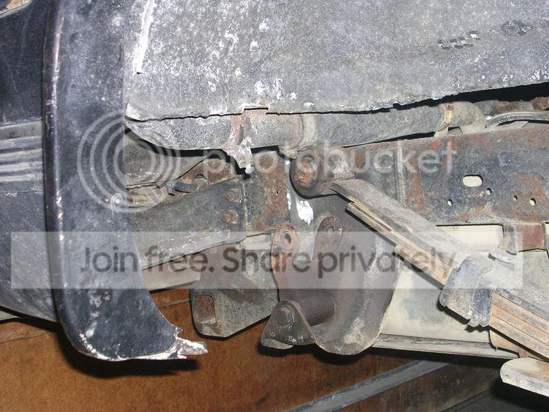

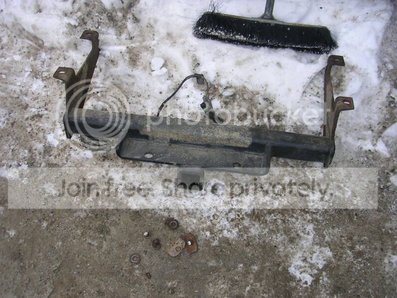

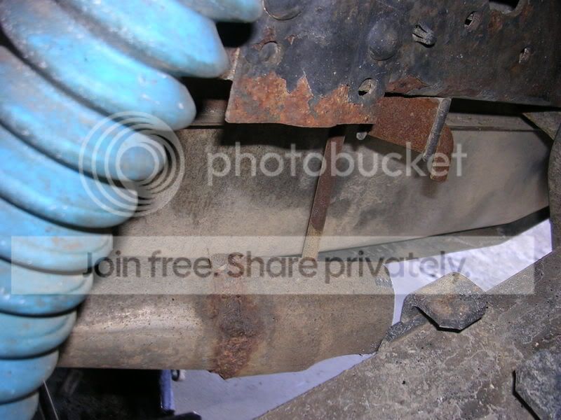

Now, for the last setback of the project. Look closely at the frame in this picture, see something wrong or something that will cause some problems?
Yeah, well, thats the hitch, and if you were wondering, IT`S IN THE WAY OF THE FLIP!:rolleyes:
And, of course, even a few soakings of PB Blaster wasn`t even budging these bolts, so, some :grind: :grind: :grind: was obviously necessary.
Hitch off:

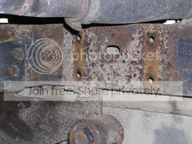

New u-bolts in place and snugged up:

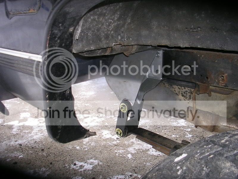

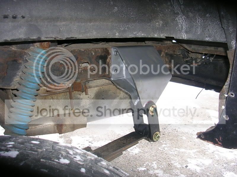

Then we cleaned up the frame behind where the flip mounted, sprayed some primer, then some paint, then mounted up the flip, and installed the shackles.
Here`s the finished pics:

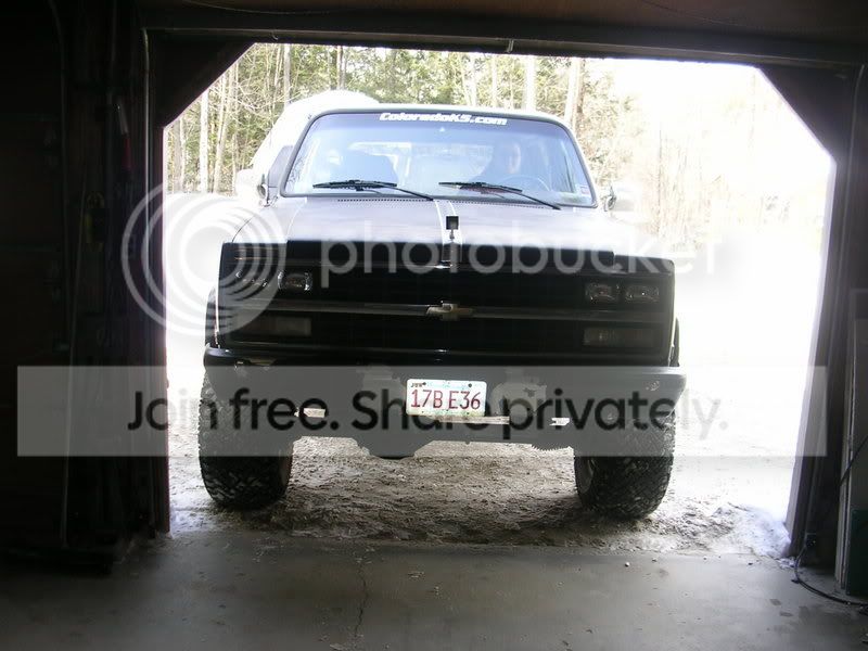

Truck out of the garage:
PS:
DS:

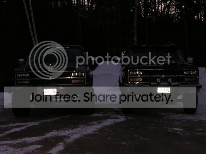

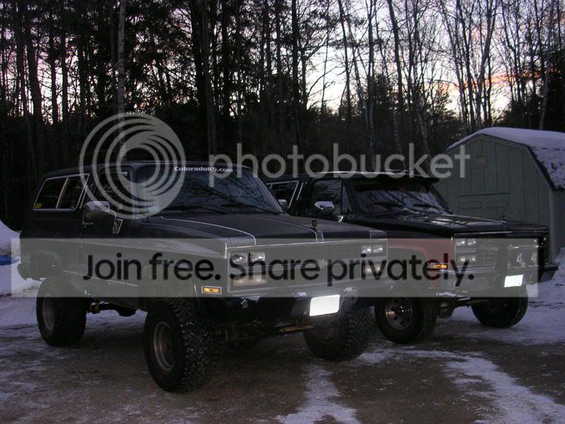

My truck, next to my buddys blazer.
Stats:
Mine: 4" springs up front, 4"DIY4X flip w/ zero rate out back, 33x14.5 MT Baja Belteds that measure out to about ~32"
His: 4" springs up front, 4" blocks in back, 31x10.5 all terrains.

and I'm jealous. I count 4 toolboxes in the first pic.
Well, as jiminycricket said in his write up, it drives like a completely different truck. On the dirt road behind my buddys place, that feels like a cement mixer when driving my buddys blazer, the truck was suprizingly smooth....I love it....you can now, however, feel how stiffer the front is....
One weird thing, was when it was all said and done, tires on, and on the ground, the truck was cock-eyed. I grabbed the tape measurer and the top of the DS wheel well was a little under 42", while the PS was ~41". So we took it out, and drove around for a bit. Came back, snugged everything up, and took a look again, and it looked like it was starting level out. Drove home this morning, 1hr and 20min ride, a little over 60 miles, and pulled in my driveway, and walked behind the truck and took a look, and it looks level now....:confused:
Yeah, in that first pic I was kinda suprised the truck was able to pull right in the garage, without airing down or changing the tires....:D
As for the tool boxes none of them are mine. The 2 bottom boxes on the left have a lot of body stuff in them, which is my buddys dads stuff from when he was in Auto Body. The one next to those is my buddys. Hopefully this summer, I`ll be able to add mine to the collection:crazy:
