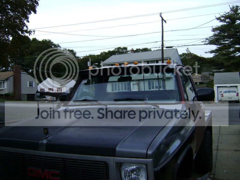

as I just posted on NEK5, please please please take those off. I were driving behind your truck with those mud flaps only one thing comes to mind...
Goddamn... there isn't enough alcohol in the US.... what a waste of a pretty face
305chevy: I'm still trying to figure out how those flaps remind you of that pic?:dunno:
just like how the ass is two big hams, the oversized mud flaps reminded me of a fat chick bending over. :doah:

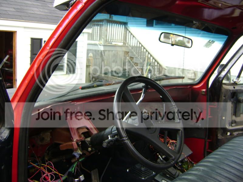

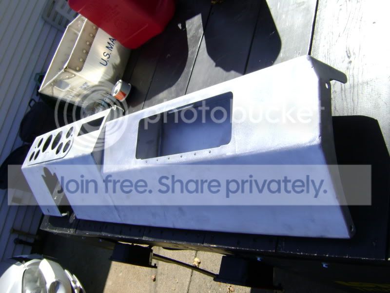

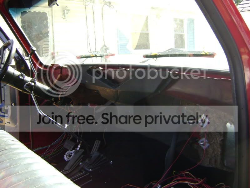

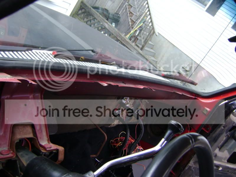

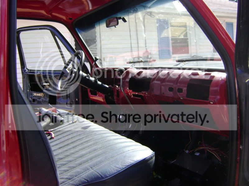

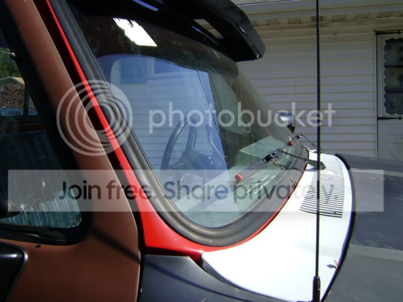

started by pulling the dash pad, factory defrost duct, and all the gauges off the steering column

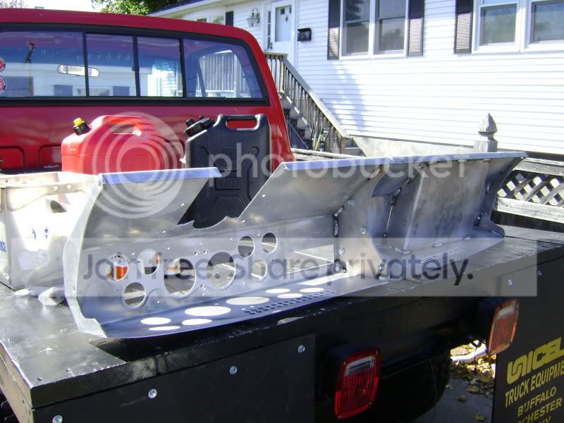

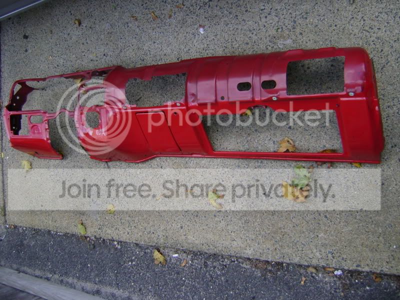

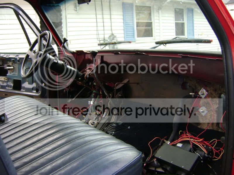

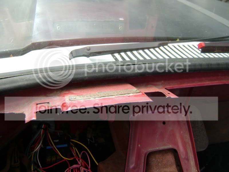

and a few small cuts later, unbolted it from the sides, and out comes the factory metal
the vins still there :laugh: as well as the factory holes for the defrost duct mounts

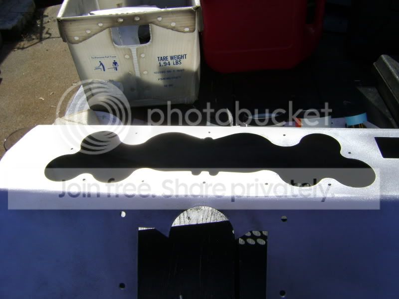

nothing but open space, haha

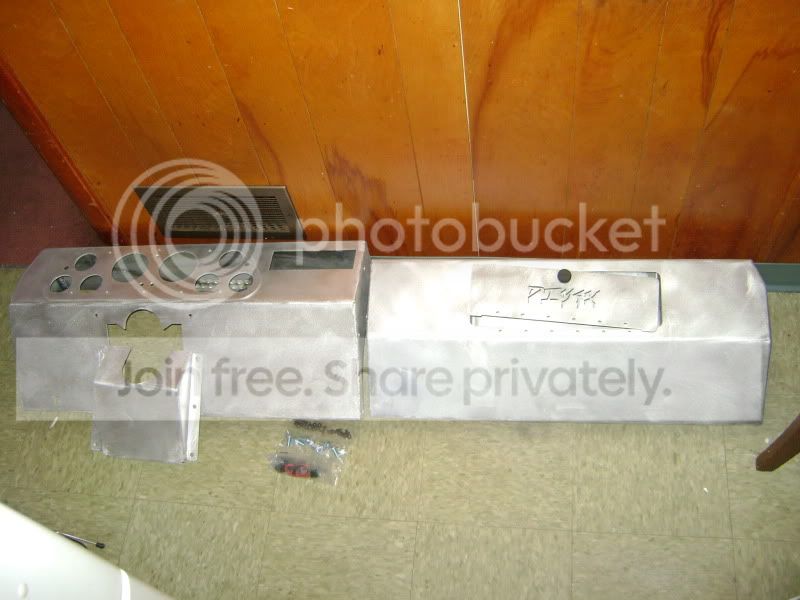

the two halves bolted up at the middle

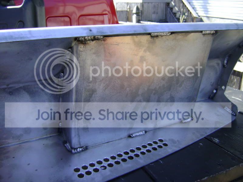

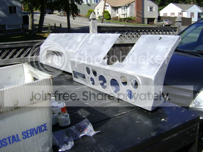

shots from the back side...you can see the weld in glove box...

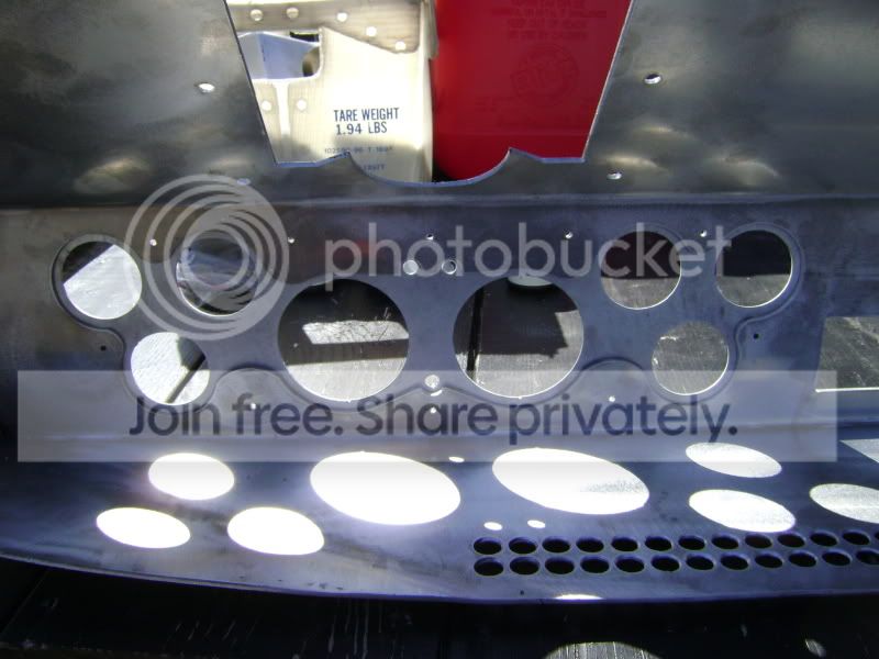

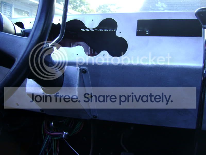

close up of the gauge layout
close up of the glove box

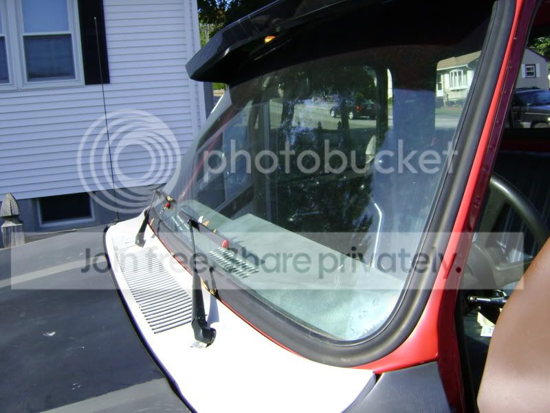

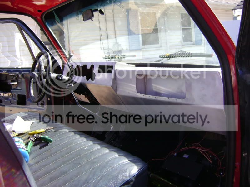

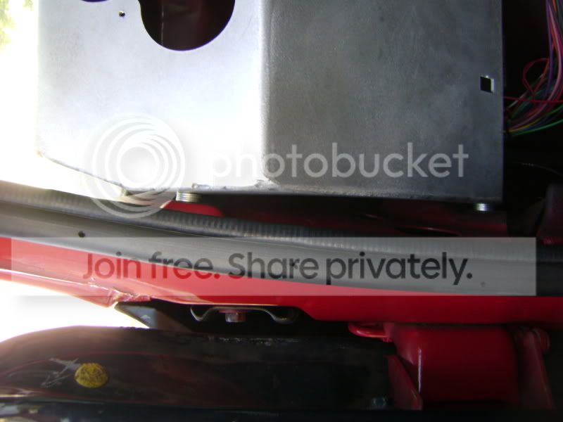

defrost duct mounted back up (the right way this time...you don't even want to know how it was in there before, haha

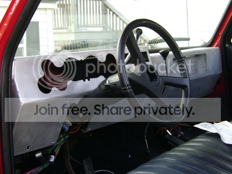

close up of the dash with the instrument panel removed

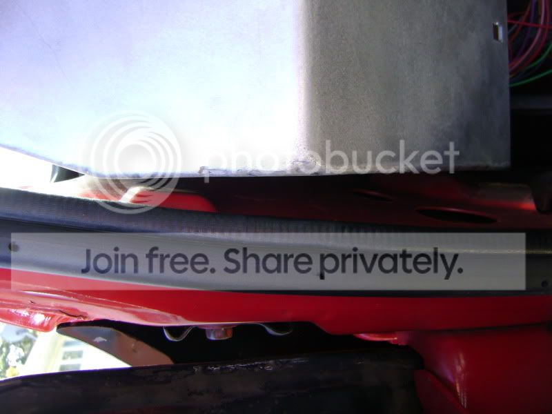

ended up with a little gap, ~1/4" on the drivers side, not too big a deal...
all bolted up
few washers to take up the gap
column cover bolted up

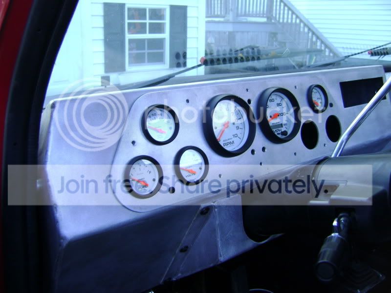

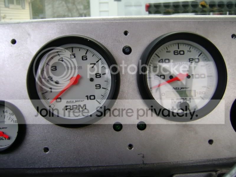

yeah I know, I still need two more matching gauges...

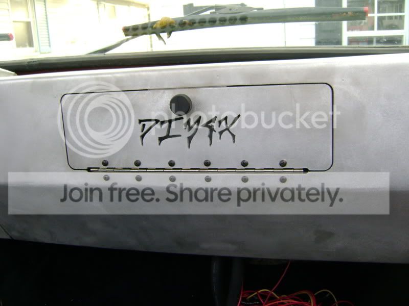

now for my favorite part.....the glovebox!

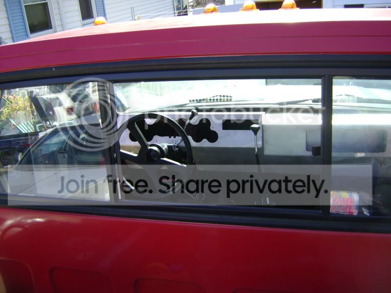

an almost complete shot
shot of the high beam and turn signal indicators...

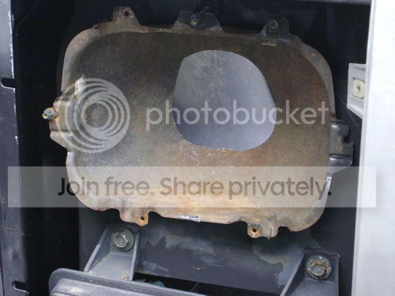

had to cut the openings in the headlight buckets so they would seat right, and replace both broken retaining rings

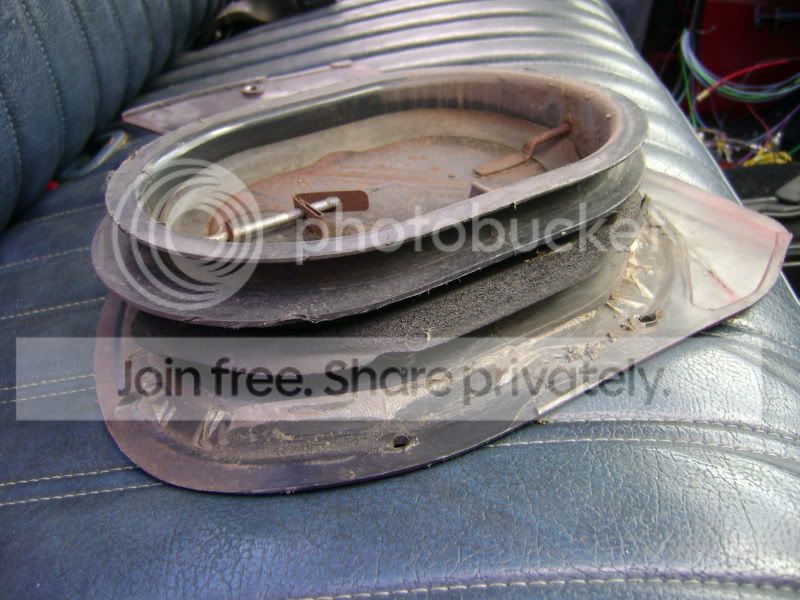

i also hope i tracked down my water leak in the cab...i had ordered new seals in hopes of that it was this, and after pulling them, it HAD to be these..look at the seal on this one!
stripped those down and replaced both seals and i'm golden!
