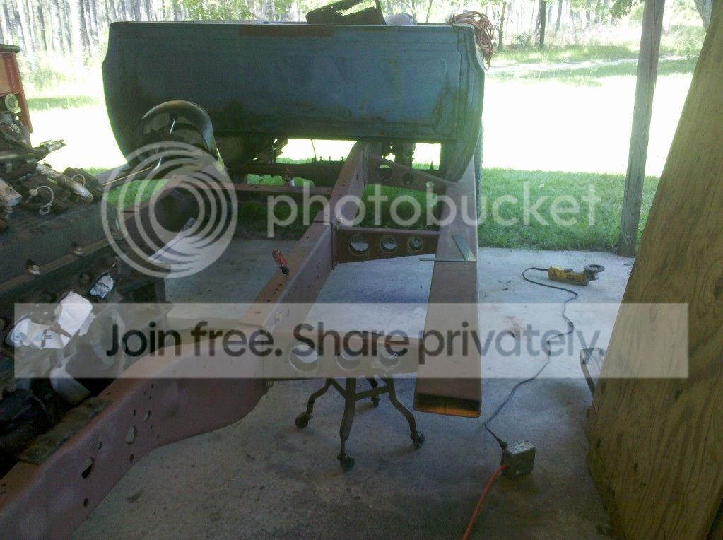

Well they ended up looking good. :waytogo: They're still going to be full of mud all the time though. Just saying. :D
Don't cut the holes in the arms. You know they're just going to stay packed up with mud if they have holes anyway. Man this is going to be one cool truck when you're done. :bow:

technically it would add strength, but to me that's a fair amount of labor for something that is mainly about esthetics... my effort would go elsewhere...

And they may fill up with mud and turn into "moderately fast holes.":D

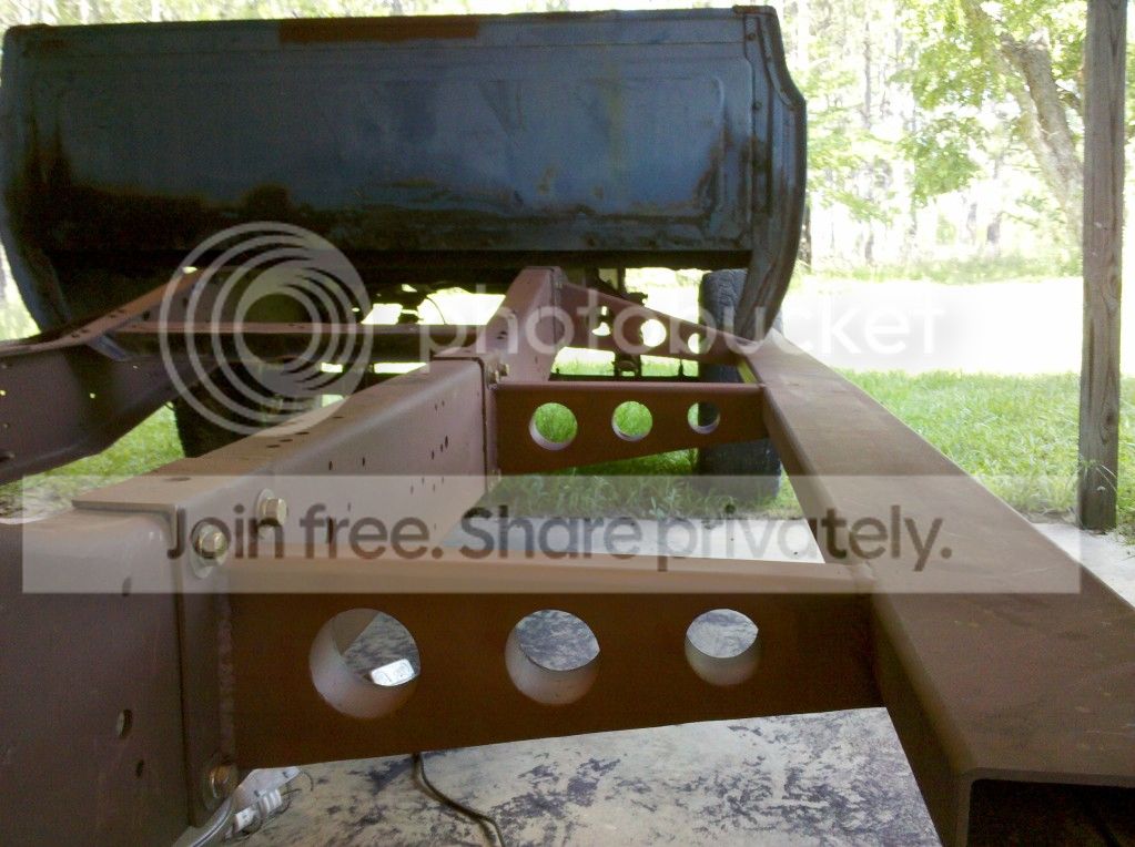

I thought he was going to weld tube in to keep the mud out?:dunno:
That's muh plan, although I do plan to leave a drainage hole in the bottom since there will bolt holes on the underside to hold the skid plates on.
Regarding the speed holes, they took longer than I thought they would, and I'm pretty sure my drill got hotter than the core of the sun a couple of times, but I like the way it looks.

The driver's side has the tubes welded in, ground smooth, and primed. All said and done I added about 3 pounds to whole shebang with the tubes. The only reason I figured that up was because on another forum there was argument that I would cut weight by putting in the holes. In the end weight is moot since I have 2000 pounds in just engine and axles.:haha:
they'll definitely add a bit of unneeded strength...... and more importantly, they look neat, and your local squirrels will have fun jumping thru them when the rig is parked in your driveway...

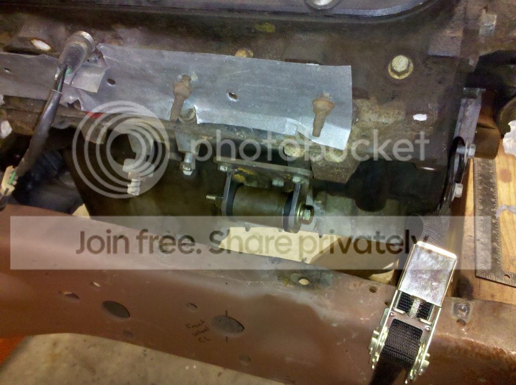

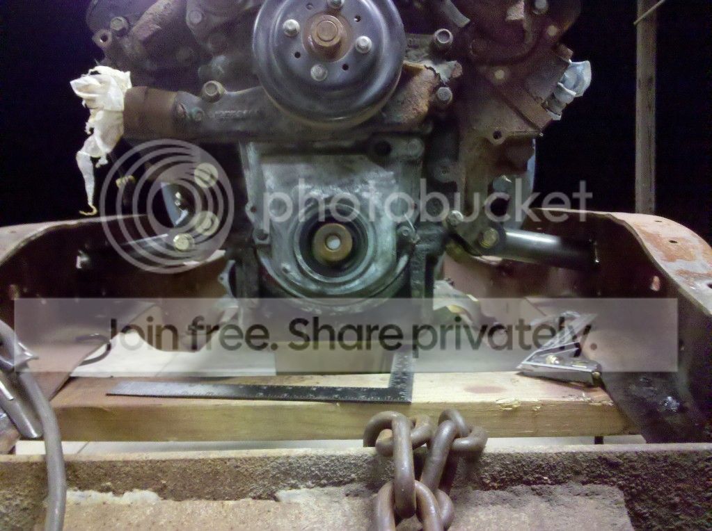

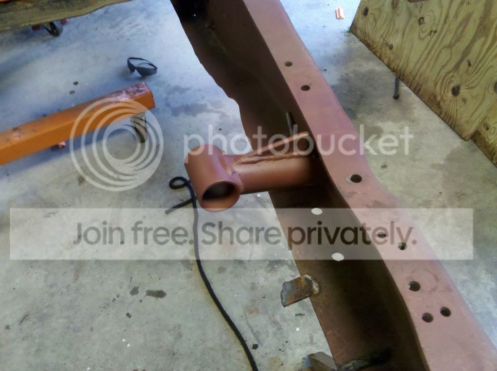

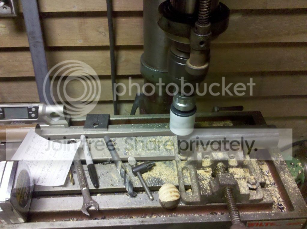

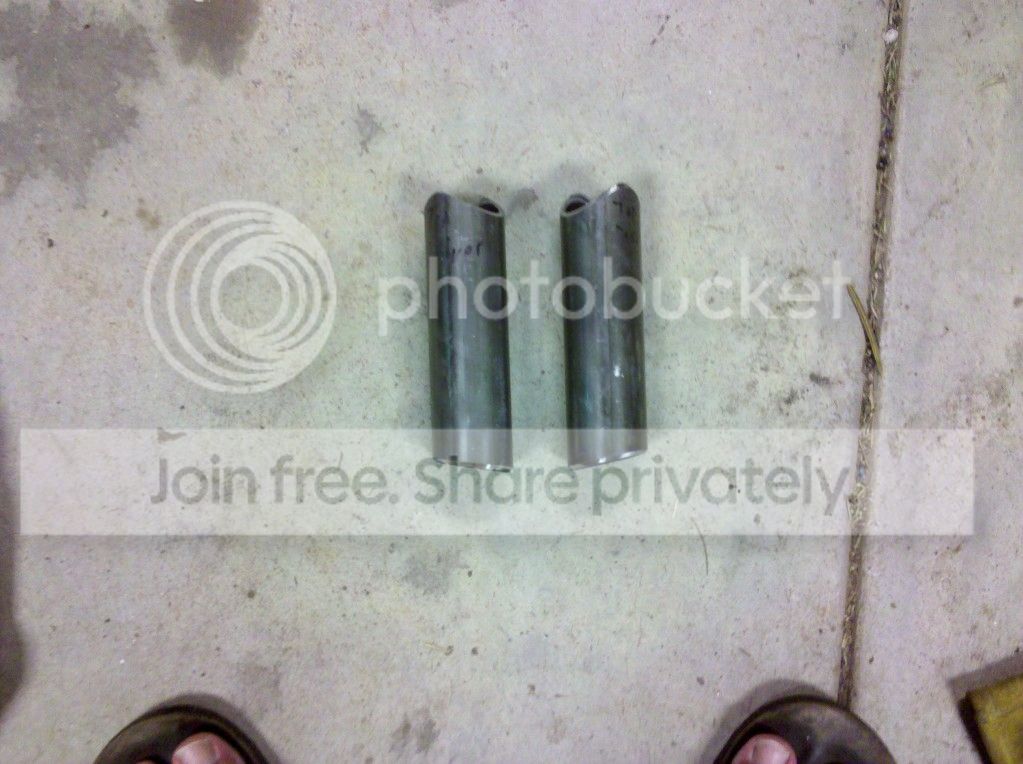

I made the frame side mounts from 1.75 x .120 DOM. I don't have a notcher, but the XY table made it pretty easy to center the hole saw over the tube.
I had to think about the angle because they hit the frame where it tapers in so I had a compound angle to deal with.

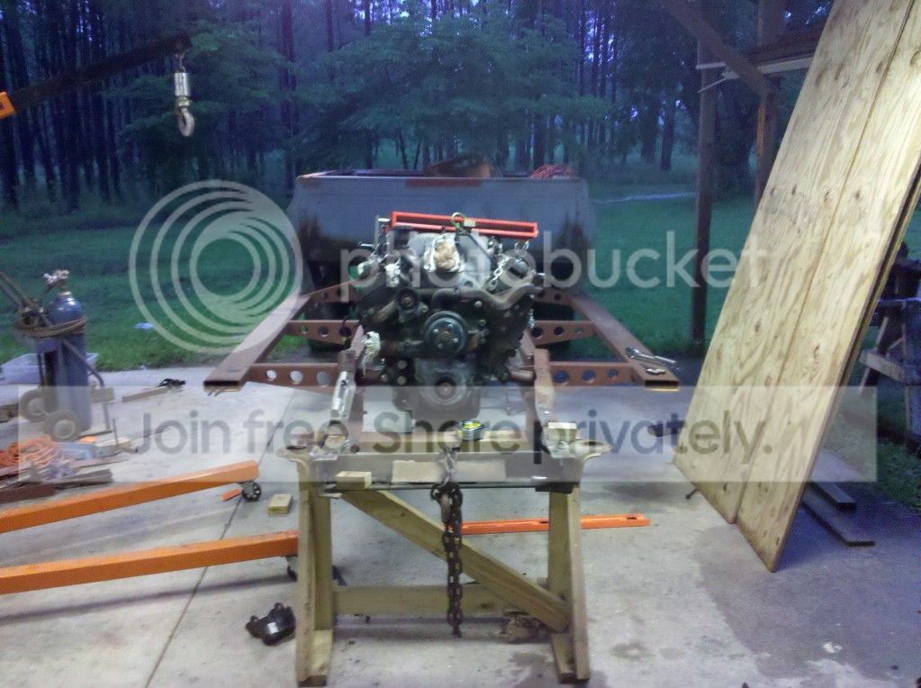

I'm going to add 3 gussets spaced 120* around tube to spread out the contact area on the frame. I need to order a die for my Model 32 and I'll bend up a removable crossmember to hug the oil pan.

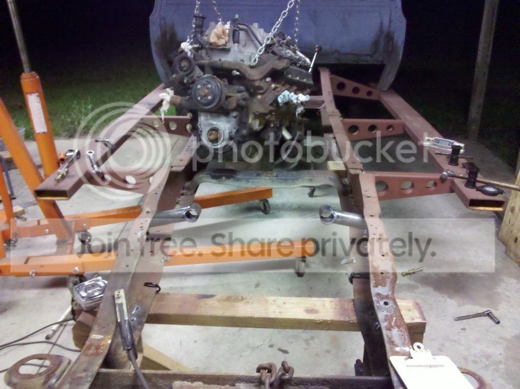

I was concerned that all the welding would warp the mounts but the bolts slid right in with a few light taps once I got the motor wrangled back over the mounts. I hate that engine hoist. I will add in the lower two gussets once I get the oil pan crossmember bent up which might take a while. I'm trying to limit my tool purchases for the time being and a buying a $300 die wouldn't exactly be limiting myself.:doah:
Now I can start working on putting the front axle in.:woot:
