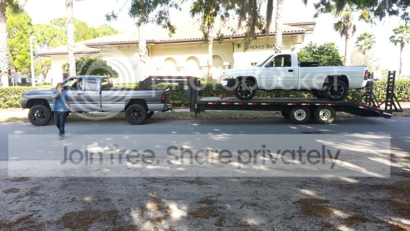

Heres my friends duramax of 305/55's. Little bit lower in the back because of the trailer though

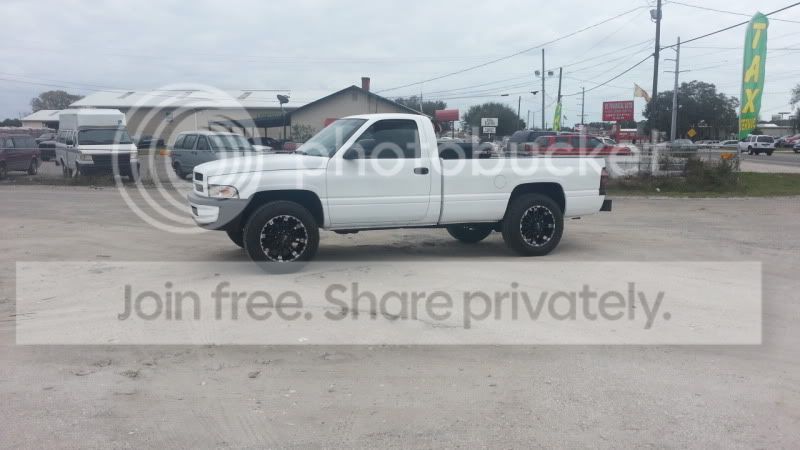

Here it is, 275/65r20's with 20x9's and I think +9 or 10 offset

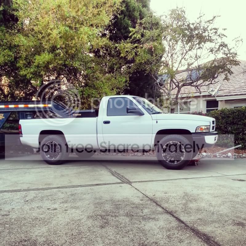

I like how it sits in this pic, but thats probably 2000 pounds of tongue weight. I'm willing to buy air bags to make sure it doesn't squat too much with my trailer. Currently have helper springs

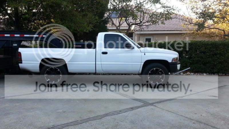

Looks a little better in this pic but I think its the uneven ground

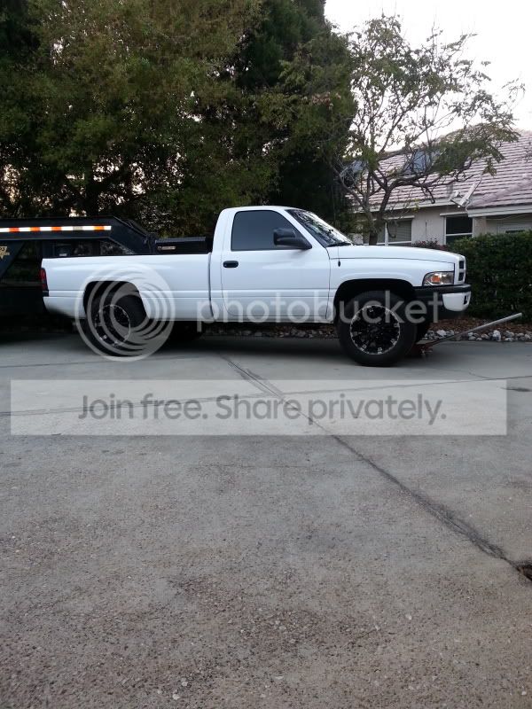

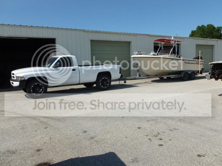

This pic shows it well, probably only a few hundred pounds of tongue weight at most so it isn't squatted at all
