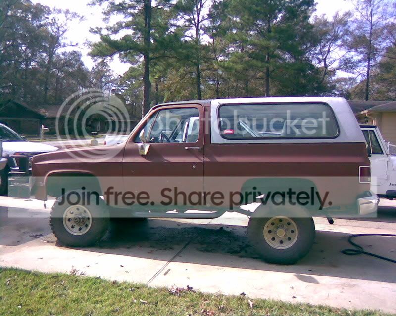

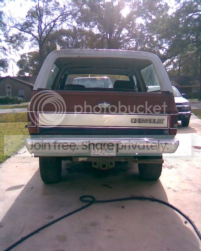

Ok went last night and finally got the truck:D. And here are some pictures of my pretty piece of junk. Just needs lots of TLC.

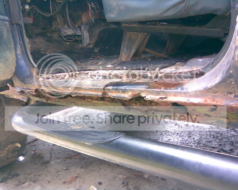

Little rust in the rocker pannels I think.:haha:

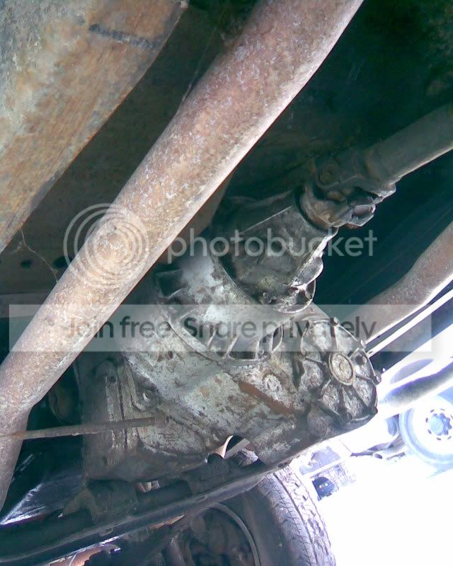

What transfer case is this?

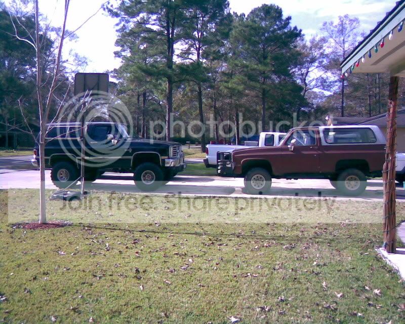

And finally my 2 blazer together

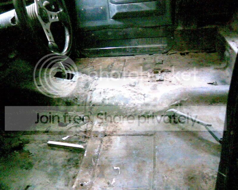

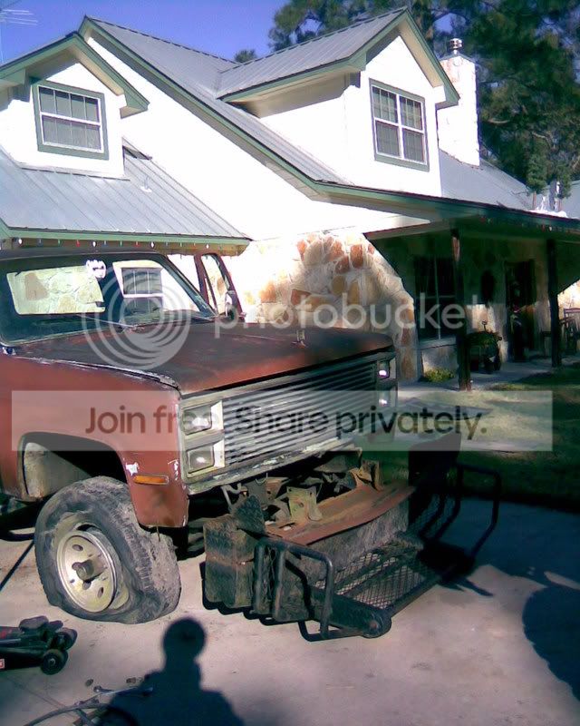

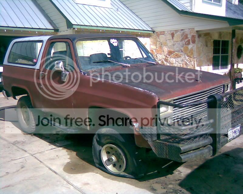

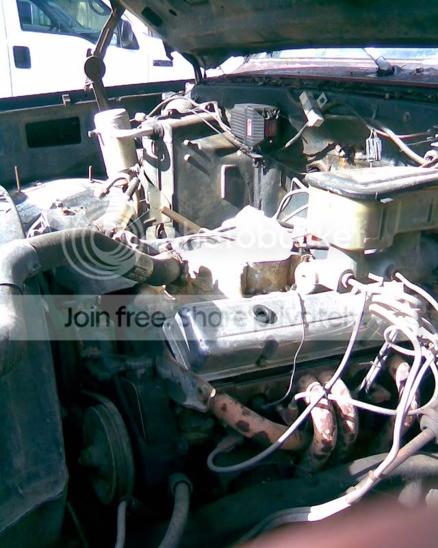

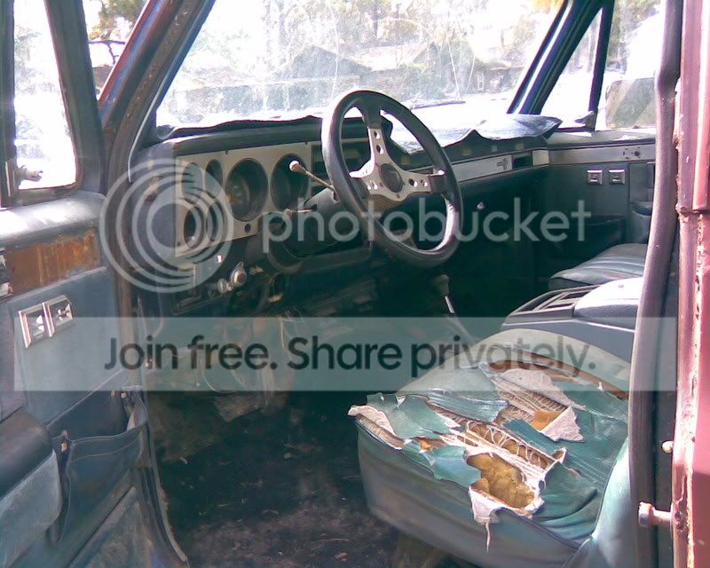

Well I kinda got a lot done today. I gutted out the interior. Put the front passenger tire back on the rim, took off the heavy a## front bumper (I think the front end of the truck lifted up 2inchs:haha:), and started to gut the engine capartment of the useless stuff.
Tomorrow I'm going to change all the fluids and hopefully get her started:D

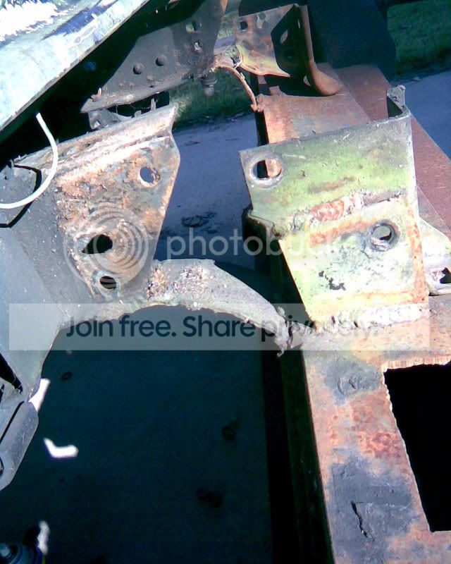

Well I first started with the bumper. I started to unbolt the thing and noticed the idiots welded it to the frame to:(.
I Got a plow now.:haha: But I decided to cut it off.

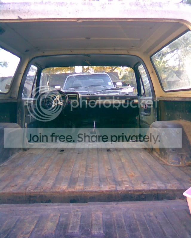

Heres pics of it gutted.

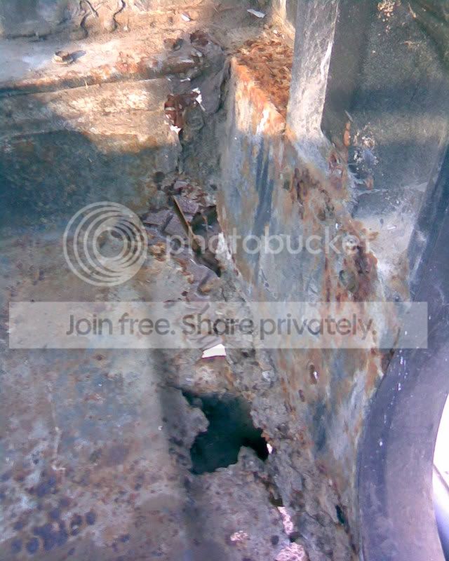

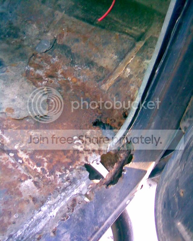

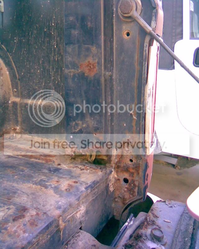

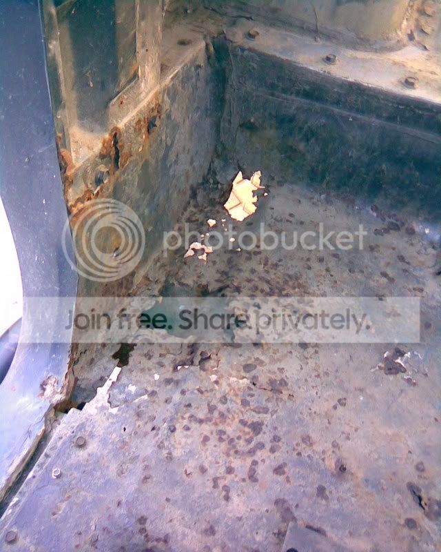

And now for the cancer:(. Luckly most of it is in the rocker and front flooring so easy fix. Just a little in the rear by the tailgate. I will have to get pictuers of the bottom side to show the poor patch jobs of the PO's. They just bondo over the rust spots and it look like they had duck taped over the hole and then they just slaped bondo over it.:haha:

I would add a little oil to each cylinder before firing, and it is helpful to manually turn the engine over a couple of times by hand. You will feel any rust issues immediately, rather than finding out after trashing a cylinder. I would also use a squirt bottle to apply a light coat of oil to the valve train.

Yeah I sprayed some WD-40 in the cylinders last night, still need to pull the valve covers and make sure nothing crawled in there and lube it up.

HOLY OBNOXIOUS FRONT BUMPER, BATMAN!!!!
Holy Toledo there chisel chest:yikes:. Theres a train missing some steel somewhere:hack::haha:.
