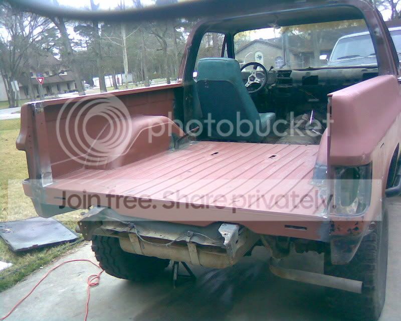

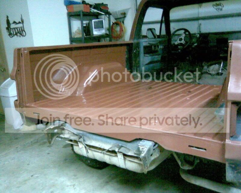

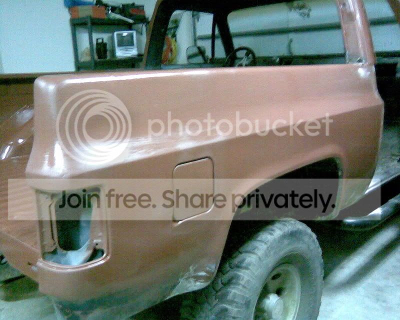

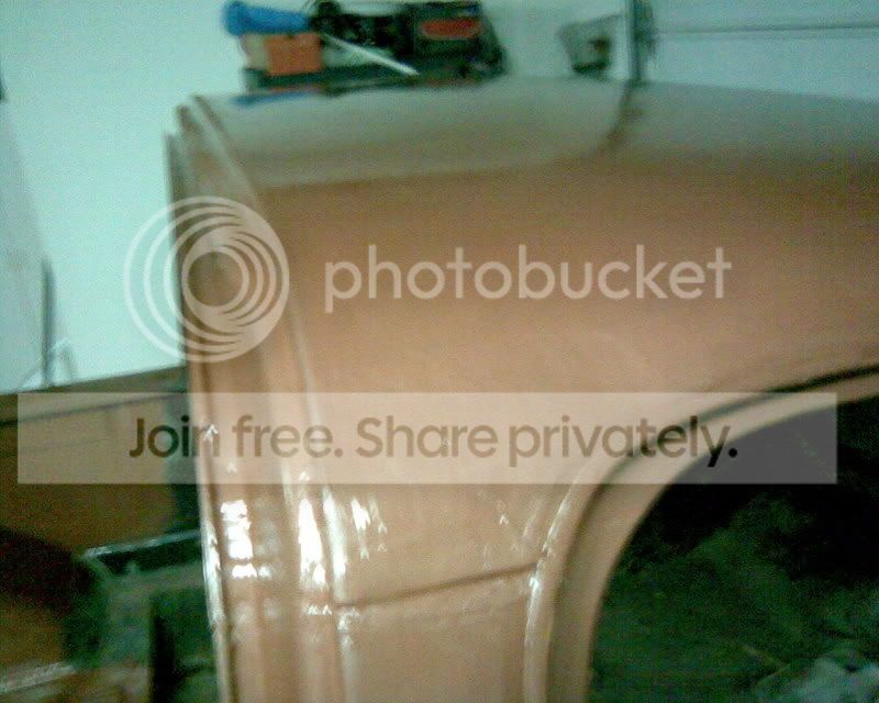

Well since there was no school today I decided to work on the truck.

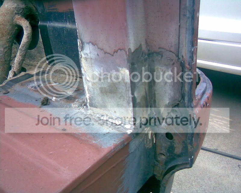

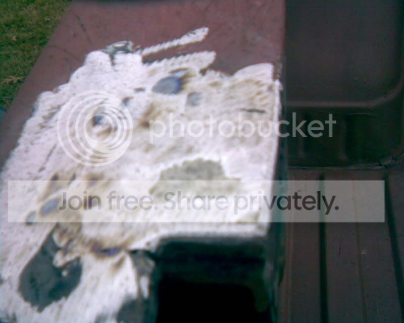

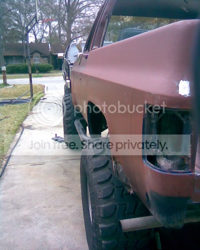

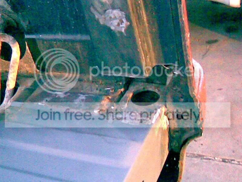

I got pretty much all of the rear body worked patched up. All thats left is to box in where the gas neck comes through the body, but I wont do that until I move the gas tank. I didnt really feel like taking all day on it so the patch work aint perfect but its good enough.
Before
After
Then the other side
And the top corner
Rear almost all primed up

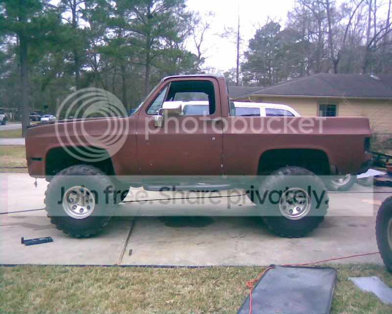

O I had to rotate the 36/14.5 TLS on my 85 so I thought I would have a little teaser (she looks like she is ready to wheel)

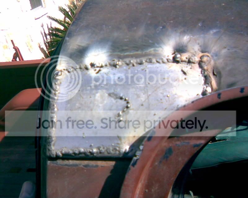

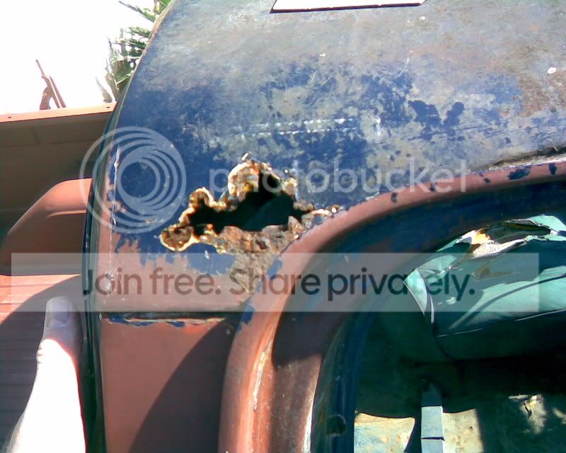

Ok I got alot done today. I patched the hole in the roof and put some bond over some dents and parts that I patched to smooth things out some. I also put some silicon sealer were body parts come together on the top of the cab to keep it from rusting in side out on me. Then I went a head and reprimed the roof and the hole rear of the truck, so no more rust. At least I hope. My next step will be to start cutting the floor out I hope. Well here the picks.
Hole in roof
New piece patched in
Cleaned up and primed
And the rest primed
Looks good to me. you're moving along so well on this. I am definately jealous. Now i want to fix the holes in mine :rolleyes:
thanks guys. With the body I'm trying to get rid of 90% of the rust. That way it will look better and the body will last longer. Right now the rear bed and roof are done, with most of the rear side pannels. I have some repair work on the rear side pannels at the bottom and fix where the side pannels run into the door(lots of rust there:(), but I wont mess with that until later. Im trying to get a good thick coat of primer on it to keep out rust and help prevent sratches to the metal. I'm useing a brush to put it on and sanding it down some when I aply the next coat. That way when I start to sand it for the final coat it will be easier and it takes off any primer that didnt adhear to the body very good. The finish coating wont be for a good while:(. I will end up painting the inside with black bedliner (proble 2 coats) and the outside will get a gloss red coat (2-3 coats and maybe a clear coat) that I will rattle can on. The biggest pain will be painting the under carrige and the engine corpartment. But I will do that most of during the engine swap.

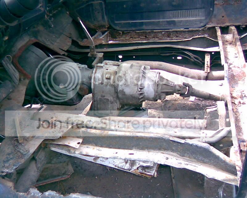

I started cutting the floor out. I got most of it out with the saw zaw b and air chisel, but I need to buy more cut off wheels for my air grinder to get the rest buy th fire wall.
Well there is no turning back now.

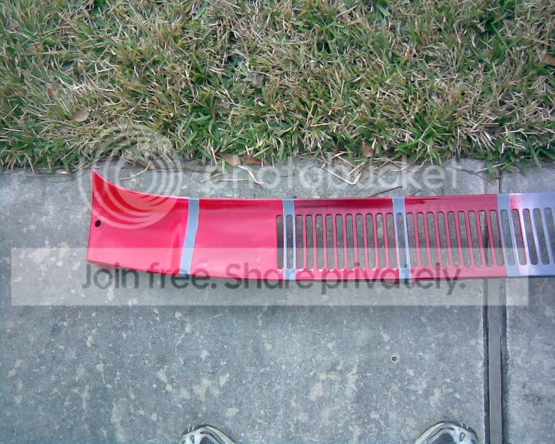

O and I think I decided on what color im going to paint it.( the first one on the left) It looks 10x beeter in real life than on the picture.
I primed it with rusto then sprayed 2 coats of white paint over that. Then sprayed 4 varios coats of red. The one I like the most is the first one Flame red. The order from left to right is Flame Red, Bright Red, Red, and Radiant Red. I sprayed the white on it first to make the red really stand out and not make it look dark. When I sprayed the first and second coat of red on the white it was almost a bright pink then as I added coats it became a darker red.
