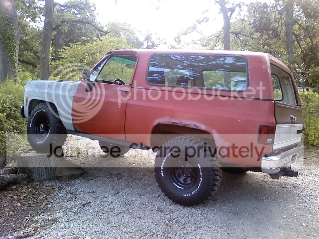

I painted my truck with a a borrowed Harbor Freight HVLP gun and air compressor. It's not show quality, but I did very little prep. Hell of a lot better than the rattle can jobber I did on my previous Blazer body. No streaks, minimal orange peel, etc. More durable than rattle can too. I used a single stage paint. $99 or something like that for all my paint supplies (minus tape, masking material). Well worth it. Quicker than rattle cans too.
W/ HVLP Sprayer:
With rattle cans:
I probably spent nearly $60 or so in rattle cans for when I did it in green. It looked fairly decent. I definitely think the extra $40 was worth the quality and time savings... even for a wheeler!

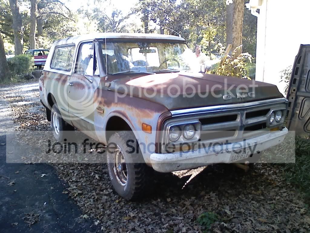

I used the $15 HVLP gun from HF, and a 2gal hobby air compressor. Did just fine on my '73 K5, very little prep(hood looks horrible haha).
Before:
After:
