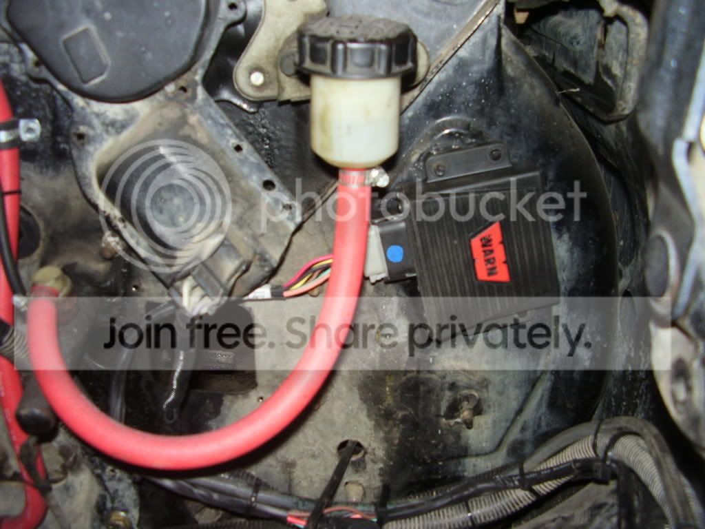

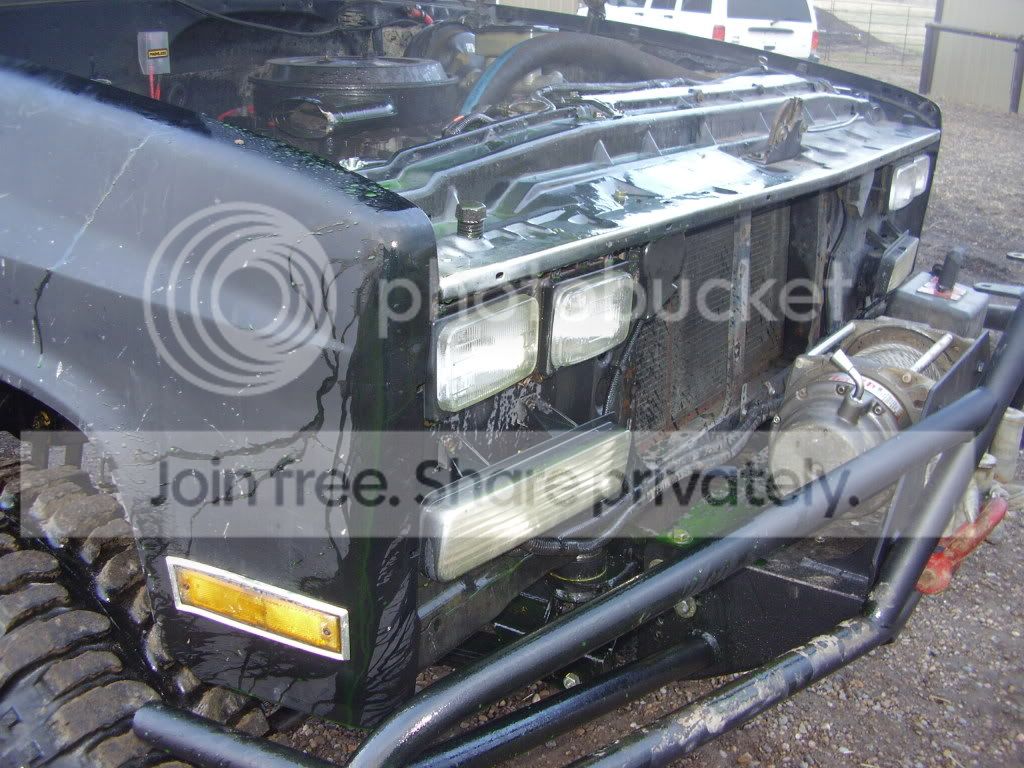

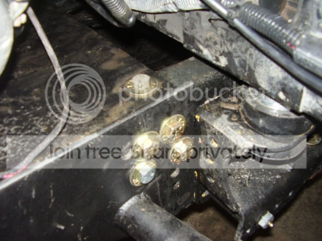

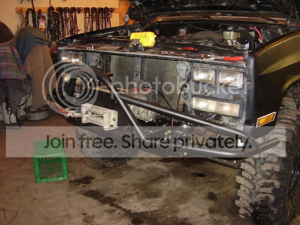

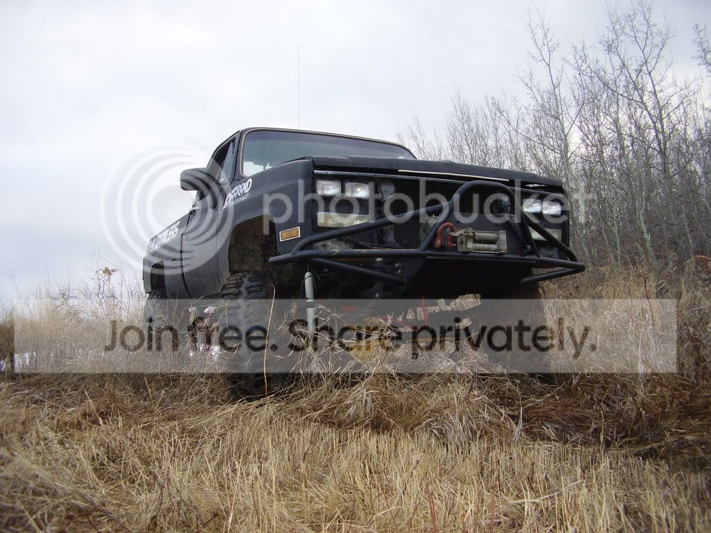

So I Got my bumper from blazen offroad installed over the weekend with an additional 12000lbs of warn pulling power. It fit right up against my B-52 with lots of room to spare I had to drill the 2 of the 4 bolt holes on the side.

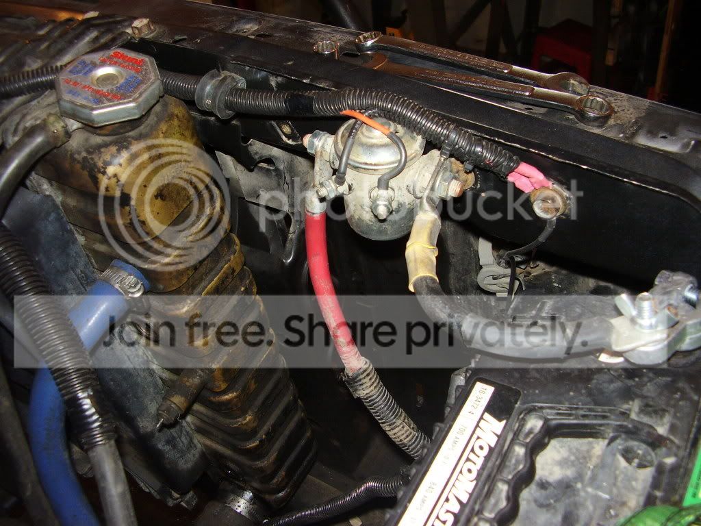

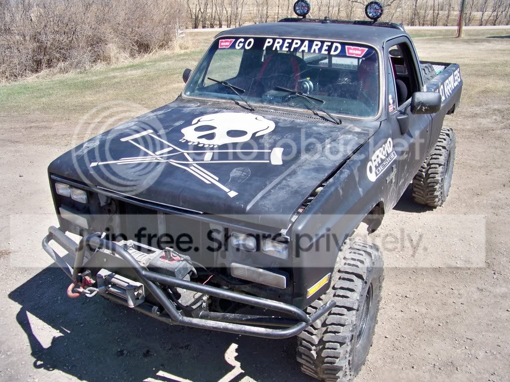

Even though Its not attached in the picture this is where I mounted the sending unit for my wireless winch controller. As for power on and off to the winch I went off the top of the battery to a solenoid.

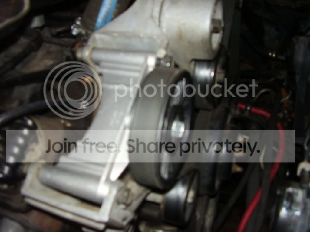

This is just a pulley to go in place of my A/C compressor, which i was not using, or will ever use.

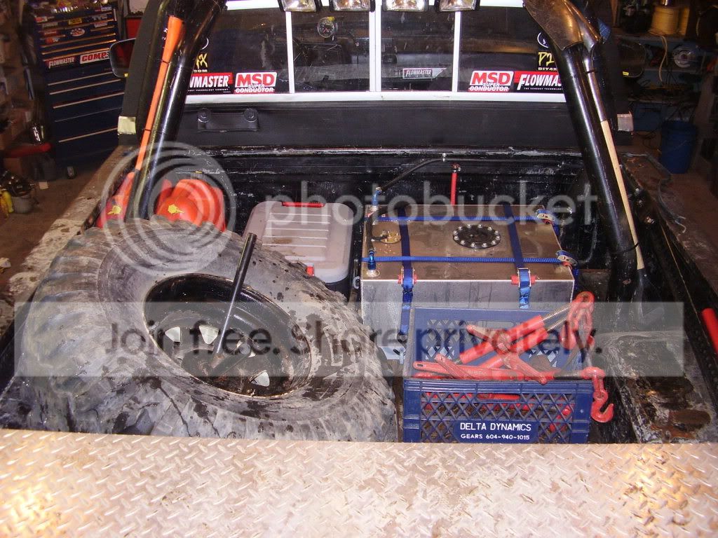

I thought I should take a few pictures of my box and all my trail gear, tools and parts.

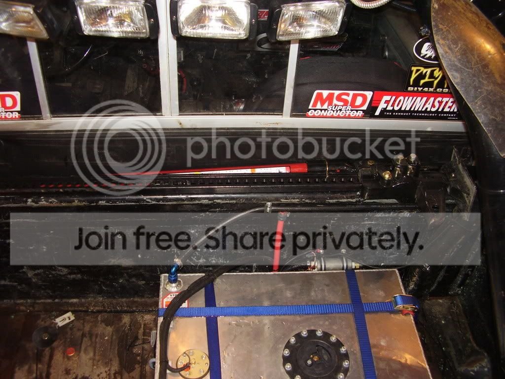

I was starting to brainstorm on where I want to mount my Hilift and I was thinking of mounting it right behind the cab. I have not attempted to make brackets for it yet, but any ideas are always welcome.

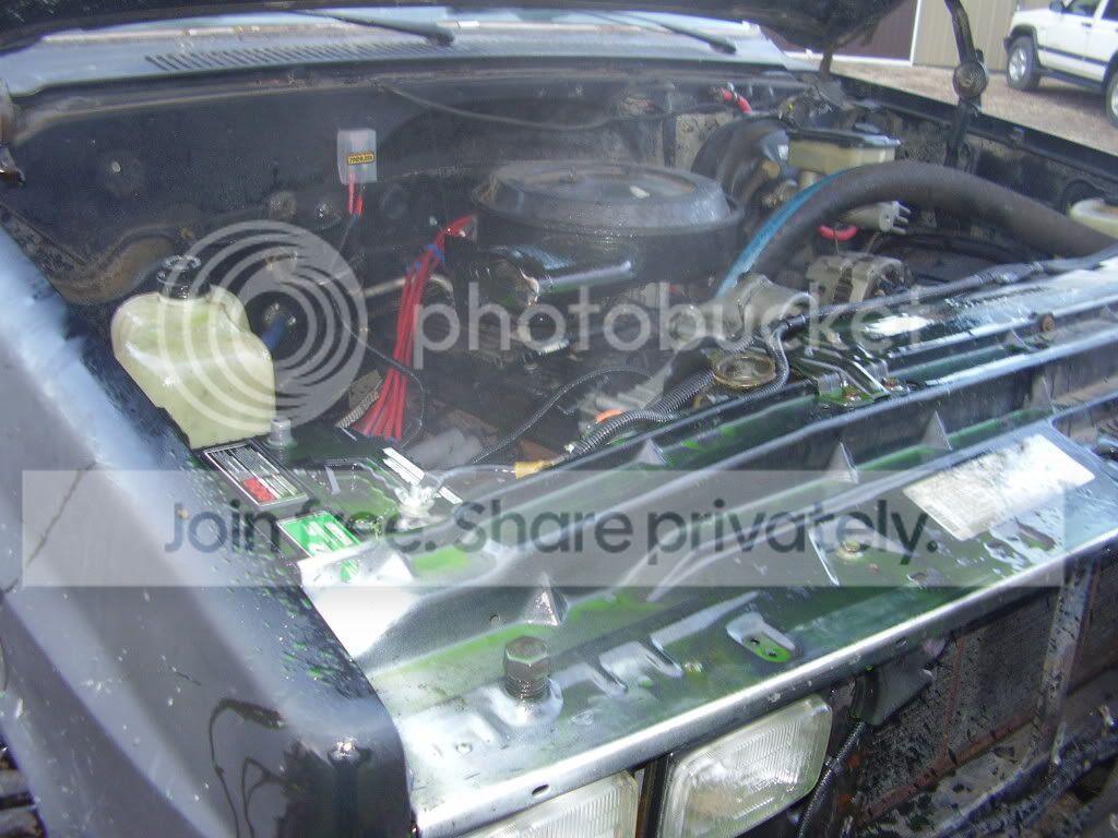

And I ended the day with a little drive and picture time. I noticed white smoke coming out from under the hood on the way home. I pulled over to have a look and saw that......:doah::doah::doah::doah::doah::doah::doah::doah::doah::doah::doah: after topping up with coolant it helps to put the rad cap back on.

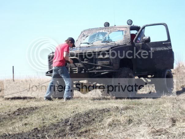

Ok I am 95% Ready to hit the trails (until I get some more coin for my next project, *cough* frontaxlerebuildwithlocker *cough*) All that I must do is replace my front wheelbearings and hubs. I got my exhaust finished today and the truck sounds way better. So in celebration of my truck being so close to ready I went over to a friends place and did some pre trail mud testing, he found some cooling issues and the only problem I had was with my CB. Oh and I put more stickers on my truck:crazy:.... I CANT STOP im a monster! heres some viewing pleasure
